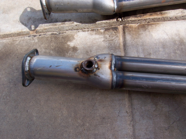

Here is where mine was put. Prior to ceramic coating.

Picture shows what I was thinking. Thanks.

p.s. - my 02 bungs are just like in the above triad pic - but i put em there only so i could use em to wide-band tune webers on the 2.7 that is now history - now i will use them to fine tune the Motronic after i re-chip it

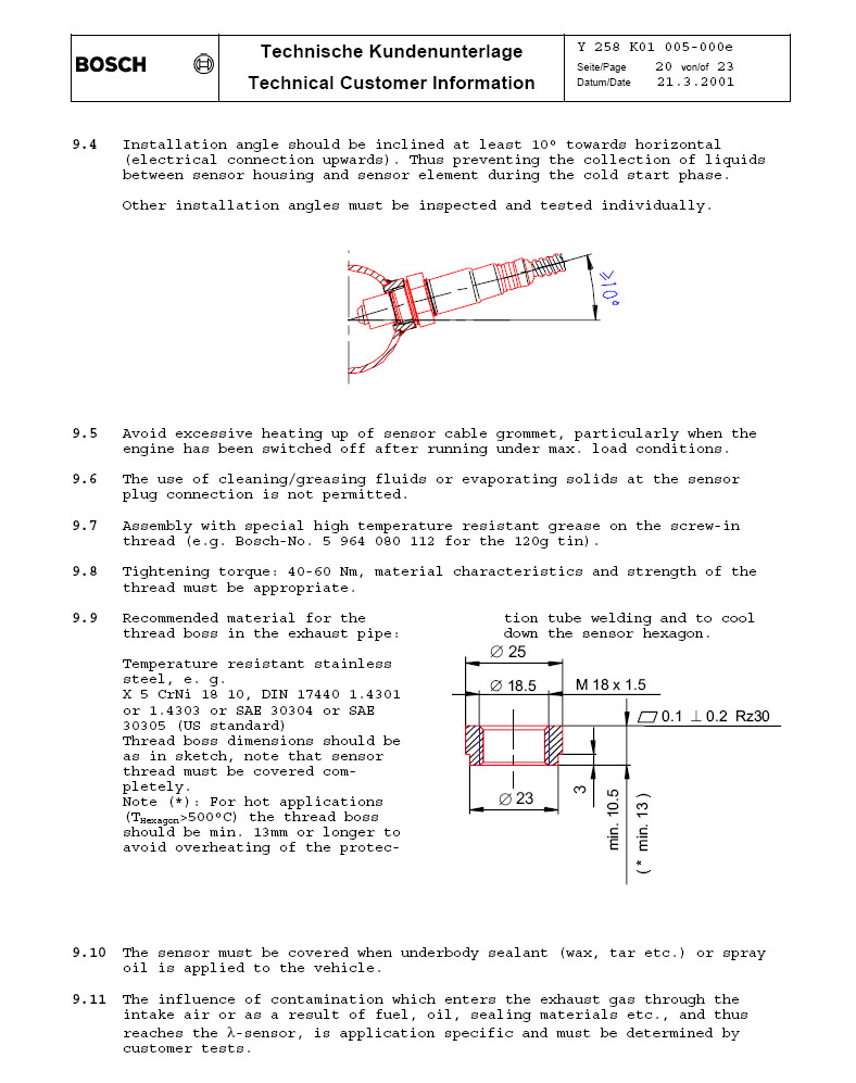

Bosch manual says to put it at an angle..not straight up and down (not sure why...just said it)

here is the Bosch tech sheet:
