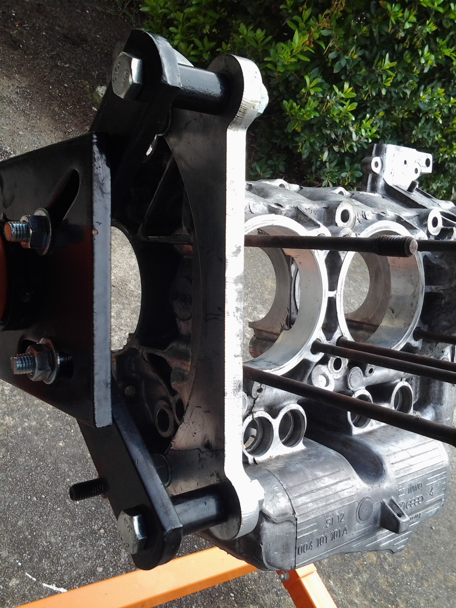

This is what I've got - an adapter for the regular stand.
Any way you go, make sure that the engine stands on the circular lip around the flywheel housing. The 2 arm stands that only hold the engine from the bolt holes are prone to fail and concentrate all the force in a single small location. I've seen a lighter bug engine case broken by the stand when one of the arms collapsed and the other broke the engine case hole that was connected to.
