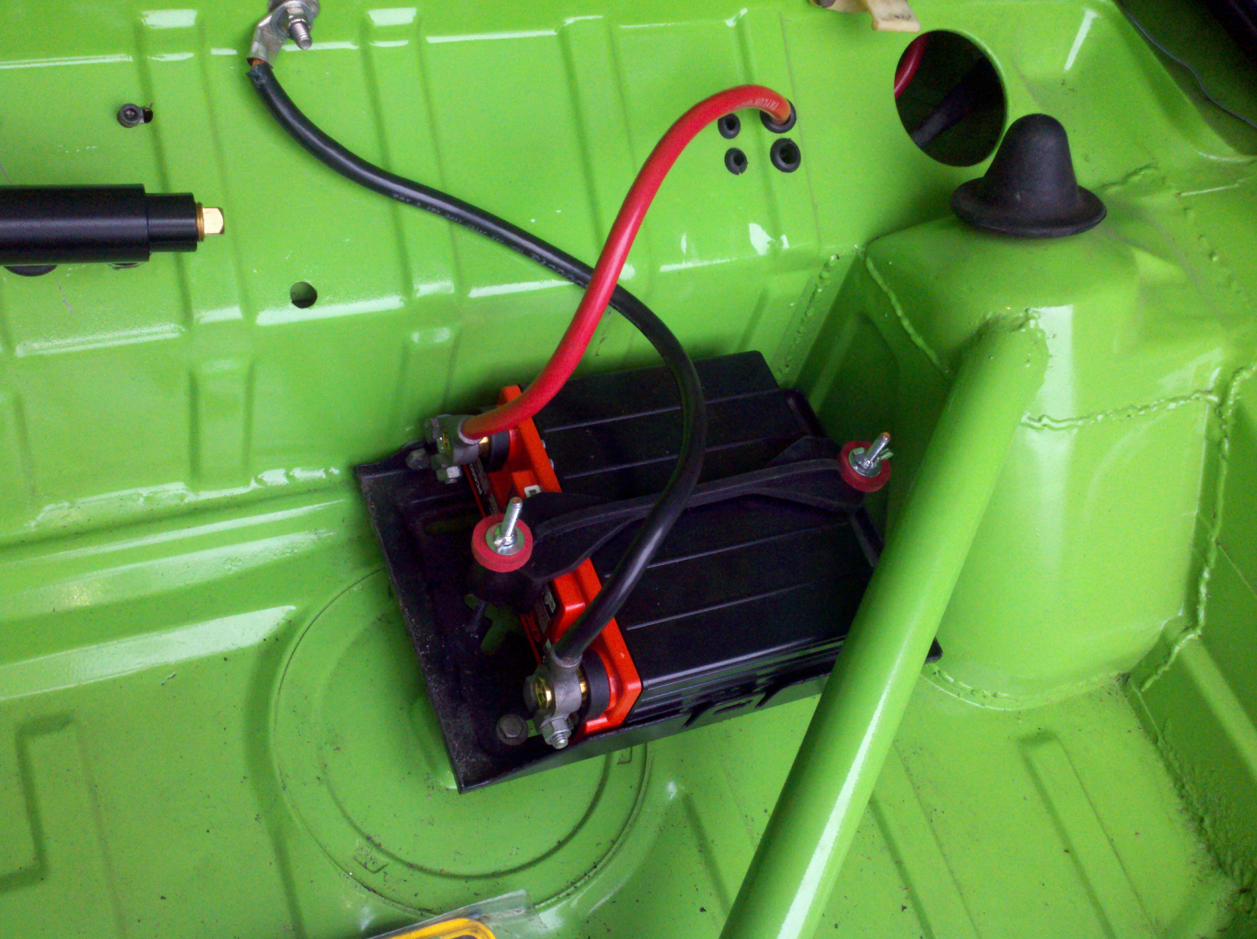

KENNY
post Mar 26 2013, 06:01 PM
Posts: 143
Joined: 5-February 03
From: Orlando fl.
Member No.: 243
This is what I use in the past 4 years . (IMG:style_emoticons/default/driving.gif)
