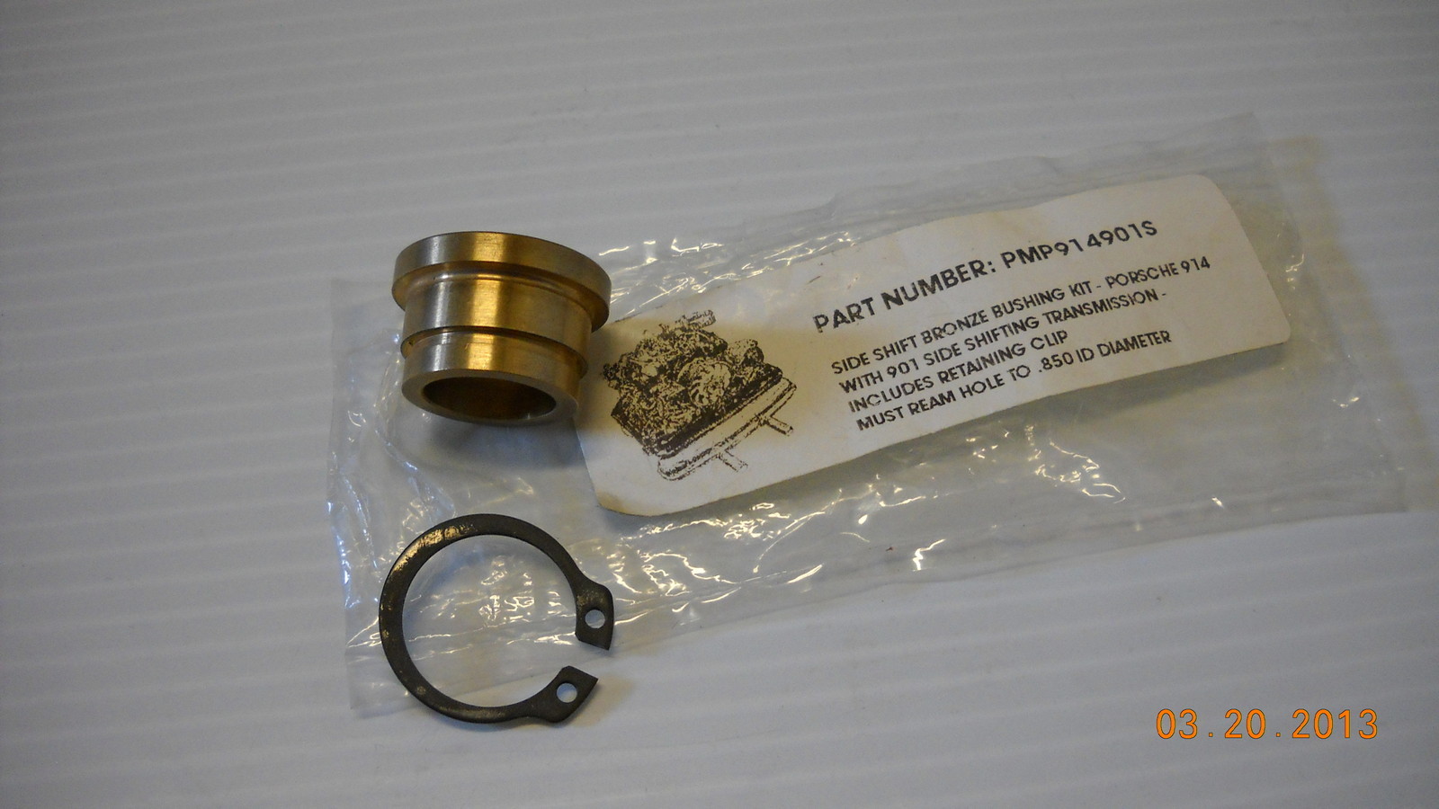

http://www.ebay.com/itm/PORSCHE-914-w-901-...29f&vxp=mtr
Just came across this, need to replace mine anyway, wondering anyones experience?

(IMG:style_emoticons/default/idea.gif) At the trans?I need 2 of those!

I installed one on mine a few years back. Super easy install and a great solution. Much better than the JB Weld that was holding the plastic one together. (IMG:style_emoticons/default/blink.gif)

I bought this one from Mid Engine Mania.
http://www.mid-enginemania.com/products/GP...Oillite%29.html
No modification needed.

The PMS part is brilliant! Do not hesitate to use it. As the package says you may need to hand file areas of the counsole to get it to fit. Do a little bit at a time and keep rechecking the bushings fit.

I was about to make one, but then saw the item advertised and went the easy way. Mine was easy to install and works great. The factory should have made this and the firewall bushing in bronze. I also found that all the bushings and adjustments in the world won't help when the engine and tranny mounts have gone soft.
