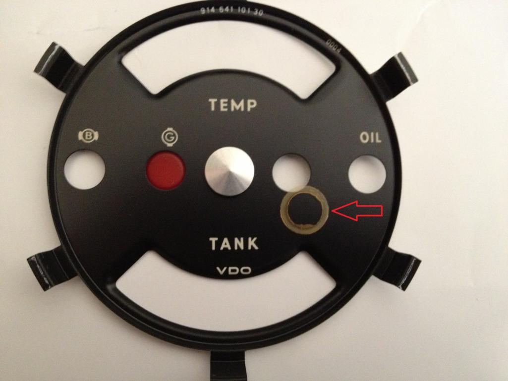

So during the process of rebuilding my gauge the yellow lens cover fell apart on me. Any ideas where to get a replacement or any brillant ideas.

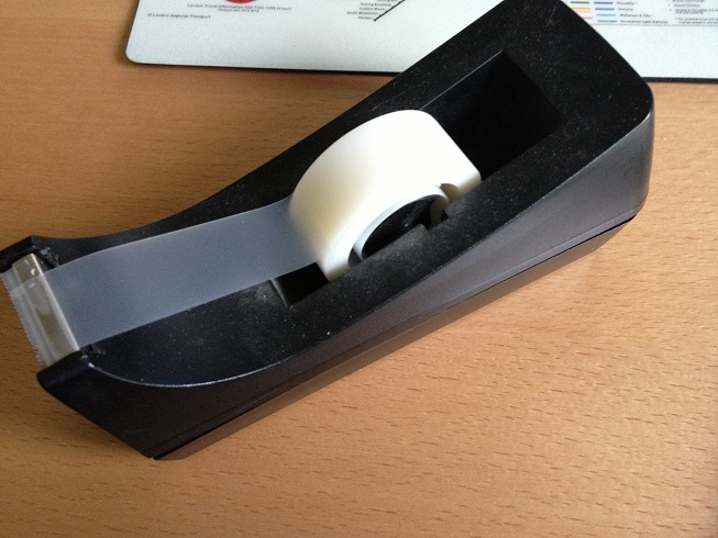

Well its rather crude, but when I replaced the gels in my tach I used color correction film gels. Cover the front and back with matte scotch tape and you have a new gel. If you can get your hands on one of these swatches there are hundreds of colors to choose from.
Rotary'14
post Mar 19 2013, 03:36 PM
Posts: 753
Joined: 24-April 05
From: Los Angeles
Member No.: 3,977
QUOTE(slothness @ Mar 19 2013, 08:45 AM) *
I like slothness's simple solution.

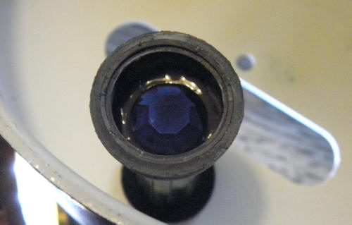

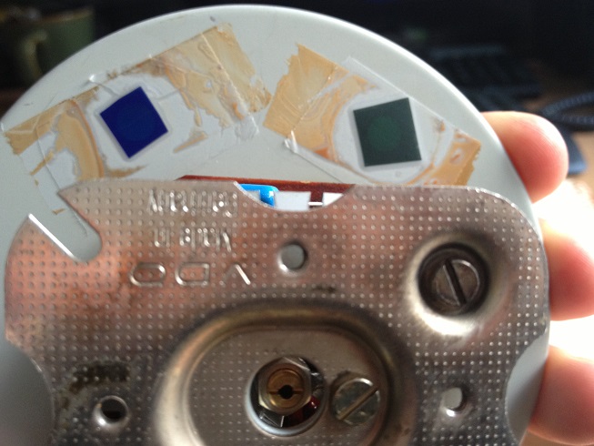

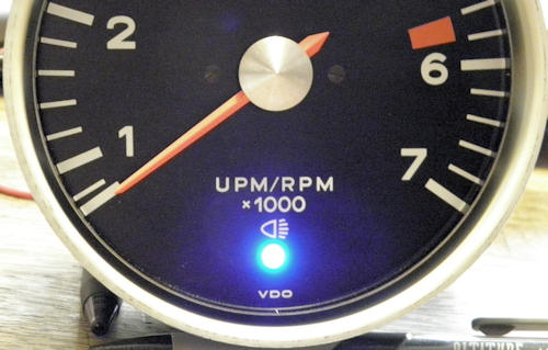

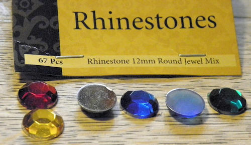

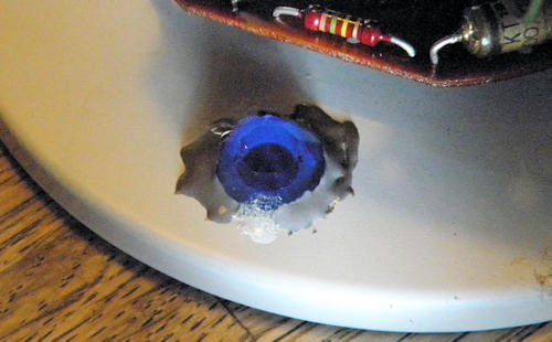

I always had a lot of trouble seeing the high beam indicator, so much so I was sure the bulb was actually burned out.
I decided to clean things up and install LED bulbs and found the lens was almost totally opaque.
Looking around at the local craft store I found these for $2.99:
The backs are silvered but a few wipes on 1000 grit wet or dry removes it. Check the blue jewel, second from the right to see the result. Lots of color choices too.
A bit of JB Weld on the back of the instrument face:
And inside the rubber light shroud:
And try it out with a blue LED:
I thought the single jewel on the instrument face might make the light too bright so I added the second into the light shroud, YMMV...
Harvey
