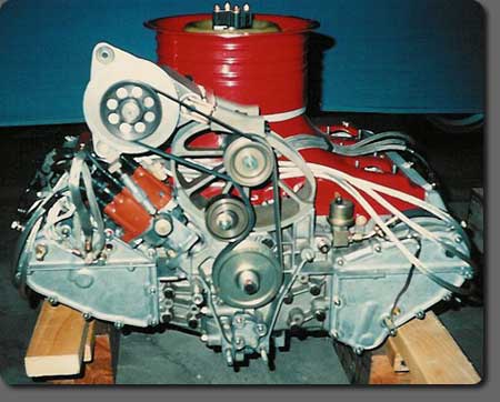

I have been thinking about this type of setup for a while with the idea to use some high speed industrial 90 degree drive unit to drive the fan.
This would eliminate the bent fan belt thing I have seen.
Take a look at this piece of crafstmanship....very nice.
No idea on price.

I love this setup. By all accounts though it uses about 35hp (at 6K or 7K rpm) so it's not free to use! The curved vertical 993 fan blades give back ~ 6-7hp at 5K rpm over the standard straight-bladed type they replaced and are quieter too.
They also move less air but frankly, I like the sound of the straight blade fans!

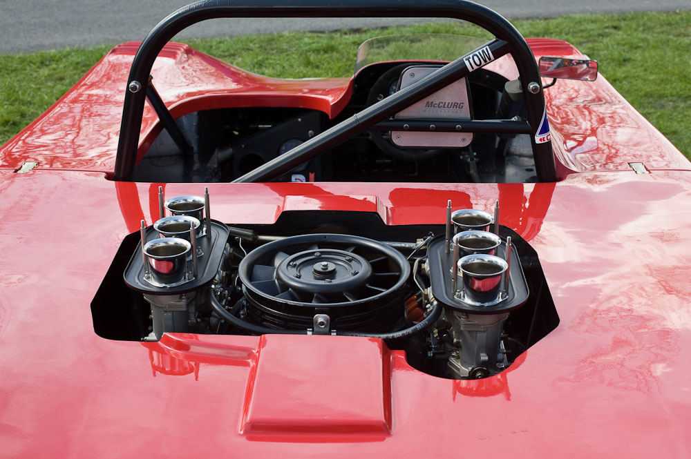

I must say, they do sound wicked..
(IMG:http://www.914world.com/bbs2/uploads_offsite/img803.imageshack.us-14843-1368218893.1.jpg)
(IMG:http://www.914world.com/bbs2/uploads_offsite/img541.imageshack.us-14843-1368218893.2.jpg)
