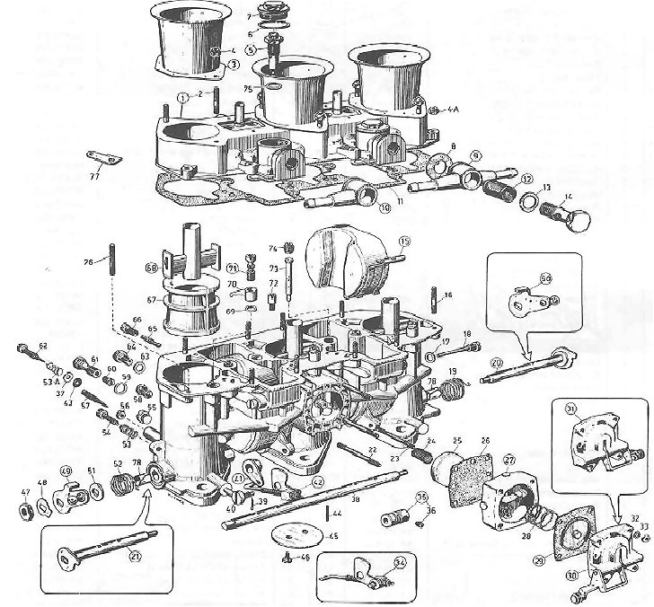

So I dug around the internet and could not find any for sale, but I did find a stock exploded view - but of low quality.
(IMG:http://www.914world.com/bbs2/uploads_offsite/i954.photobucket.com-11663-1367806864.2.jpg)
I guess I would settle for that, but no one makes that either , as far as I can tell.

I'm going to have this one made up, but I was hoping for something a bit more, um, dramatic? Bolder?

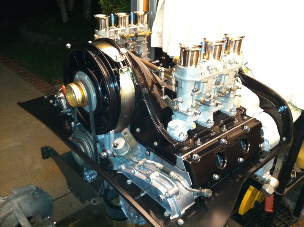

Is everyone building 3.0's?
Engine specs please (IMG:style_emoticons/default/drooley.gif)

stock 1978 large port 3.0, upgraded turbo cam chain tensioners, stripped the fuel injection, added refurbished Weber 40 IDA 3C carbs (thanks to Paul at Performance Oriented), Barry Hershon rebuilt/re-curved distributor distributor, stock cams (for now), ceramic coated conversion headers from Marty at MSDS, liberal dose of powder coating, conversion oil cooler.
That's about it. Should be good for 200 HP.

Sounds nice, those carbs must have cost you but at least you can bolt those puppies on and forget about it.
do you know what emulsion tubes and venturi's you are running?

Should be a nice runner. The SC cams and P/C don't allow you to run as wild a cam, though I've heard that a 964 grind is better without swapping out the pistons.
I was going to mention the same thing. Kind of like how an SC cam works better on a 2.7 that still has the old P/C in there. Maybe he's saving up that couple hundred for a future all-out rebuild?
BTW that engine looks really nice!

I guess I'm old school, but I think these engines always look best with the Weber carbs or the MFI system on board. I love the drivability of modern EFI systems, but they just don't look as nice (well, maybe the PMO system is still quite nice!).

200 seems like a low guess ???... nice work BTW

Crap I was thinking mine was going to be just over 200hp...I might be off a bit...

Hate to pile on but please provide as much carb info as possible.
Venturies, jets, emulsions, air corrections and anything else you can think of.

Specs: 34 Main Venturies, 140 Main Jet, 160 Air Correction Jet, 60 Idle Jet, F3 emulsion tubes
Talk to perry@qsnap.com for a custom wiring loom. He helped me to bypass my old relay panel and built a custom loom for the new distributor and MSD box. Awesome work!

Can you tell us ( I assume you've driven the car ) if there were adjustments to the carbs after driving it initally ? I'm not asking about mixture or balance but rather any jet changes, emulsions venturies etc.
I ask because Bruce Anderson (RIP) specs 160 mains and 175 air corrections as a startup.

Unfortunately the engine has not yet been installed. Hopefully that will happen this summer as I may have found someone to help me get it to the finish line....

This jet info is OK to know as a baseline, but be sure that till you have actually tuned the carbs you will not know it's exact jetting requirements. Every engine will have different jetting requirements.
I used this info to buy 34mm vents and F3 emulsion tubes (and rebuild kits) today. I'll be using a wide band to tune my carbs, with my WB and jet reamer kit I'll make my own jets.
That said the Performance Oriented guesstimate on jetting comes from a lot of experience and I bet will be damn close.
