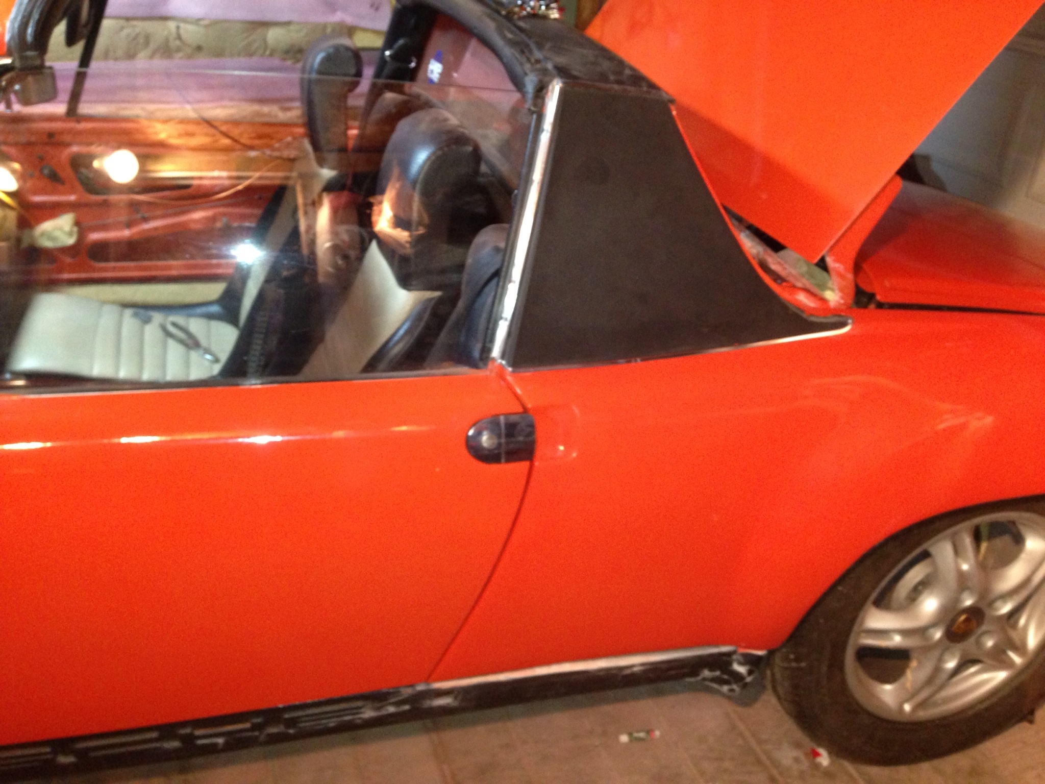

Scotty, What color code was this? you posted this on my previous painting thread.
This is what my color looks like now.
looks like it has a little grey on it

QUOTE(914itis @ May 5 2013, 09:02 AM) *
IIRC that was L32K - Pheonix Red

QUOTE(scotty b @ May 5 2013, 04:40 PM) *
Ok , I think my old paint was more red. This is more on the orange side.
After 6 hours of wet sanding, buffing and polishing, It's coming to my satisfaction. I still have some orange a bit of orange peal but I like the texture.

Update
After gathering everyone's professional advice, especially Scotty and Rick, I decided to reprint the whole car, it went well with the exception of one spot where I had a reaction. I took care of it and my paint now looks great! Here is a shot .

914itis
post May 21 2013, 06:52 PM
Post #55
Posts: 2,892
Joined: 9-October 10
From: New York City
Member No.: 12,256
Final product.

Way to go Paul! You did it right by repainting it, and I wager you learned a lot more by doing it several times in a row... unlike myself where I only paint cars sporadically. I'm very impressed - your car looks great.
Did you get any compound on the rubber when cutting/buffing? This is something I still have yet to figure out - I don't know of a good way to get buffing compound "sling" out of rubber without messing up the rubber itself.

Thanks, a bit of patience, and yes I learned a lot , my messing up was a combination air pressure , gun settings and temp. I learned the hard way, but the end results is satisfactory.
All rubber was off with the exception of the front Wimshield. I worked slowly around it.
