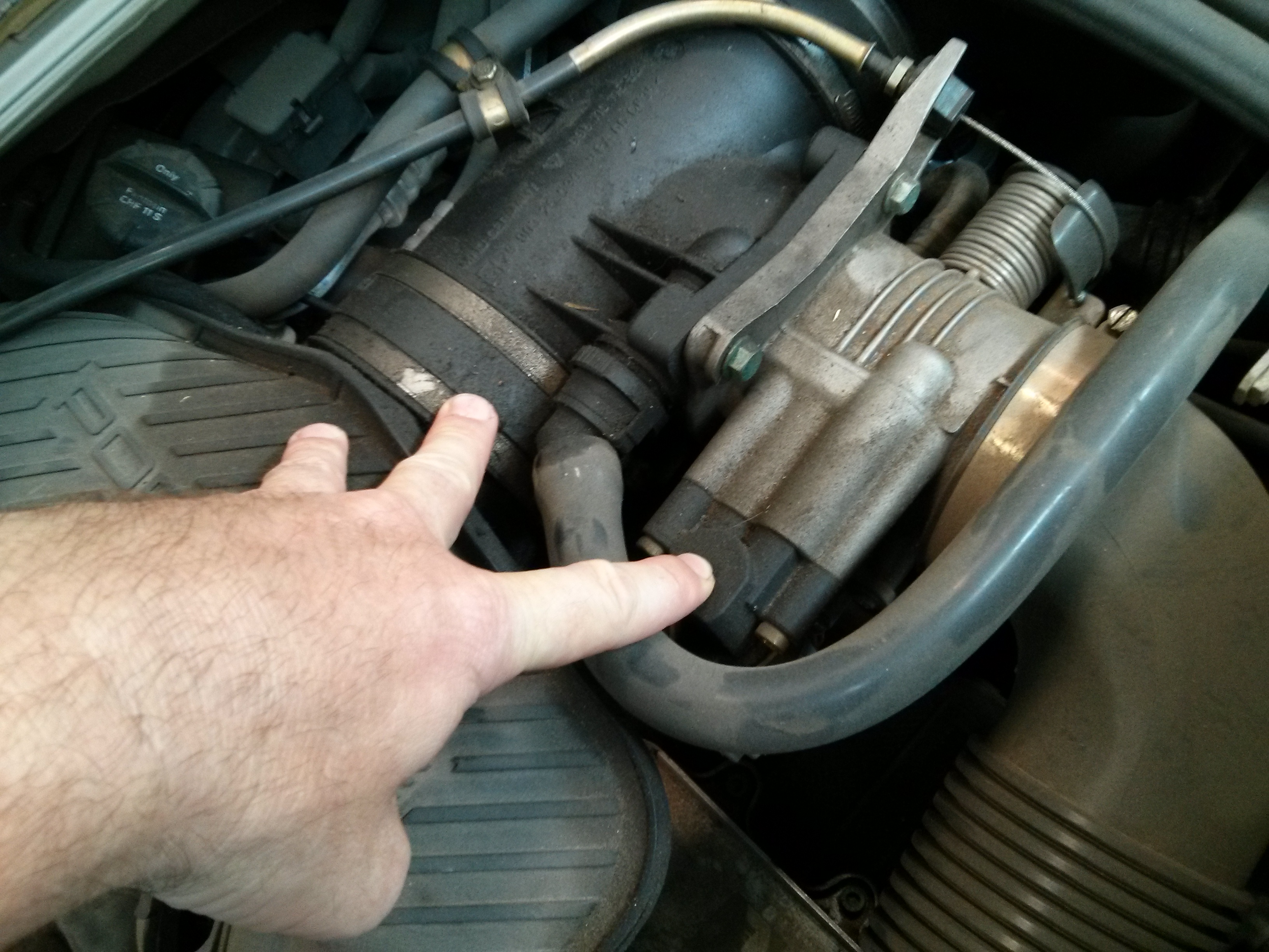

I'd just throw some Webers on it. (IMG:style_emoticons/default/poke.gif) You may want to pull the throttle body and take off the idle air control circuit. It may be plugged up with carbon. That will certainly cause issues similar to what you're seeing.
Woody
post Jun 19 2013, 07:32 AM
Sandbox Rabblerouser and head toilet scrubber
Posts: 3,858
Joined: 28-December 10
From: San Antonio Texas
Member No.: 12,530
It looks like this, the black thingy.

Still waiting to scan but I cleaned the throttle body last night. It was pretty gnarly so I'm glad I did it.

Did you take off the IAC servo on the side of the throttle body? The fans should come on between 180 -190 but should also run all the time if you have the AC on. Do you have a fuel pressure guage?

I did take the servo off while I was clean the throttle body. I reinstalled it afterwards. The contacts looked to be in good shape.
