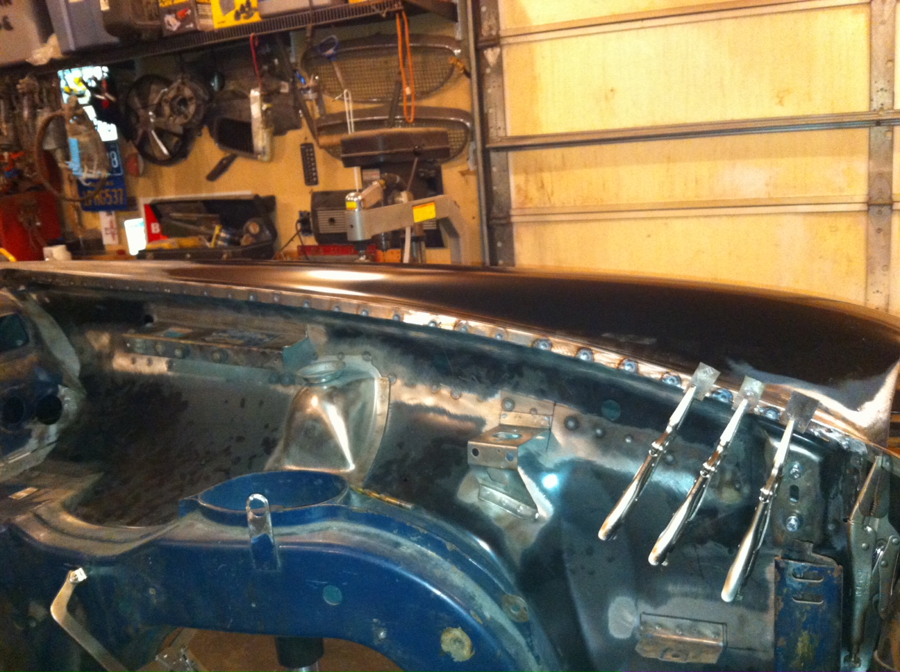

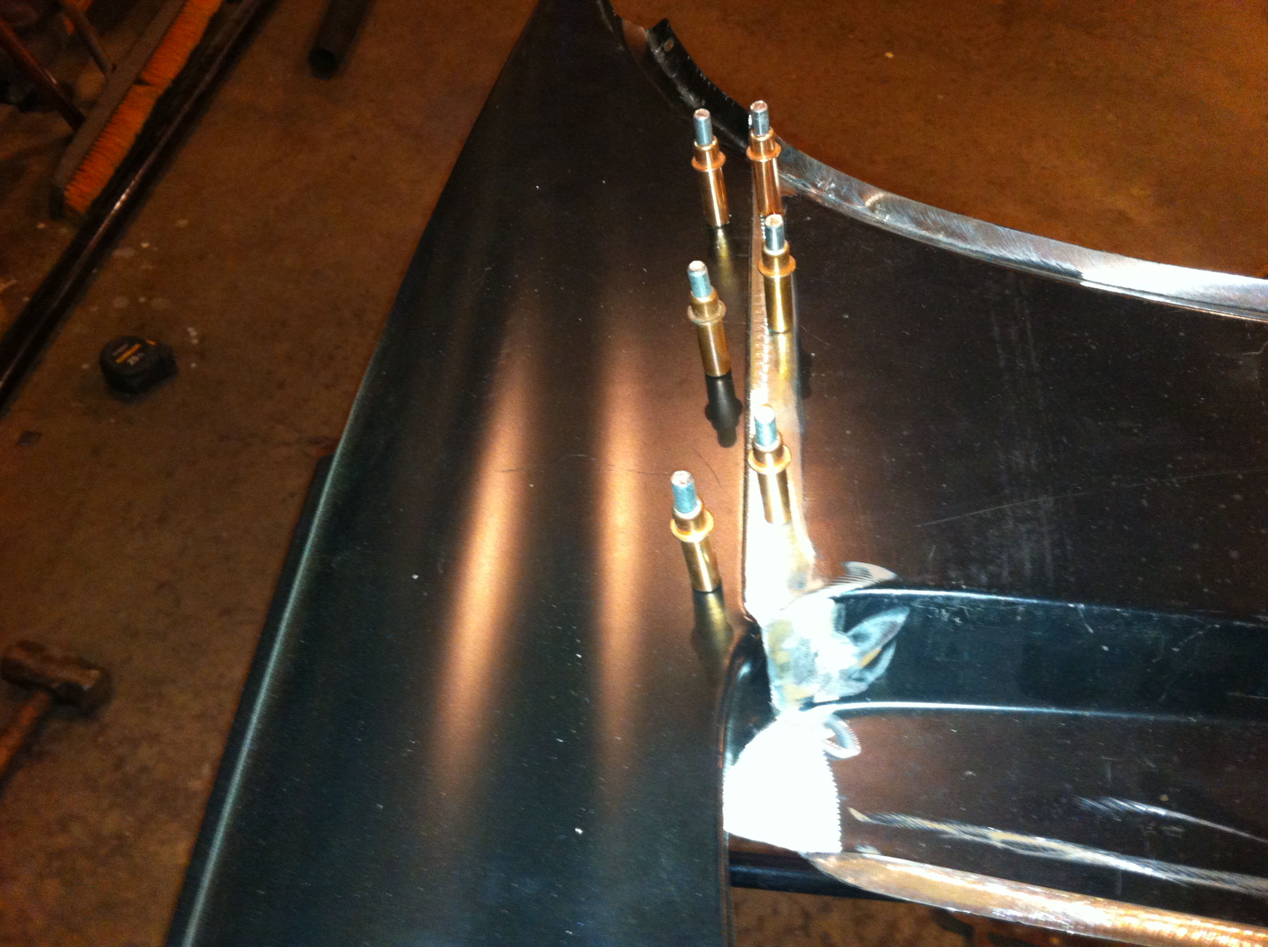

This Mercedes is even challenging my skill set. The factory used to sell the front shroud as a complete unit. It is not available that way anymore so I need to assemble all the pieces and metal finish all the seams before sliding the shroud over the inner structure.
Now in case you don't know the lids and doors are aluminum. The sheet metal is assembled, then the doors and lids are filed to fit the openings. The gaps are perfect and set to 5mm from what I'm told.
So as I assemble the car I have to fit sheet metal parts that is normally welded "close" and fit by hand to the doors and lids that are filed to fit the sheet metal. (IMG:style_emoticons/default/screwy.gif) Not easy.
Here's the shroud As I build it. I hope it fits.... (IMG:style_emoticons/default/unsure.gif)

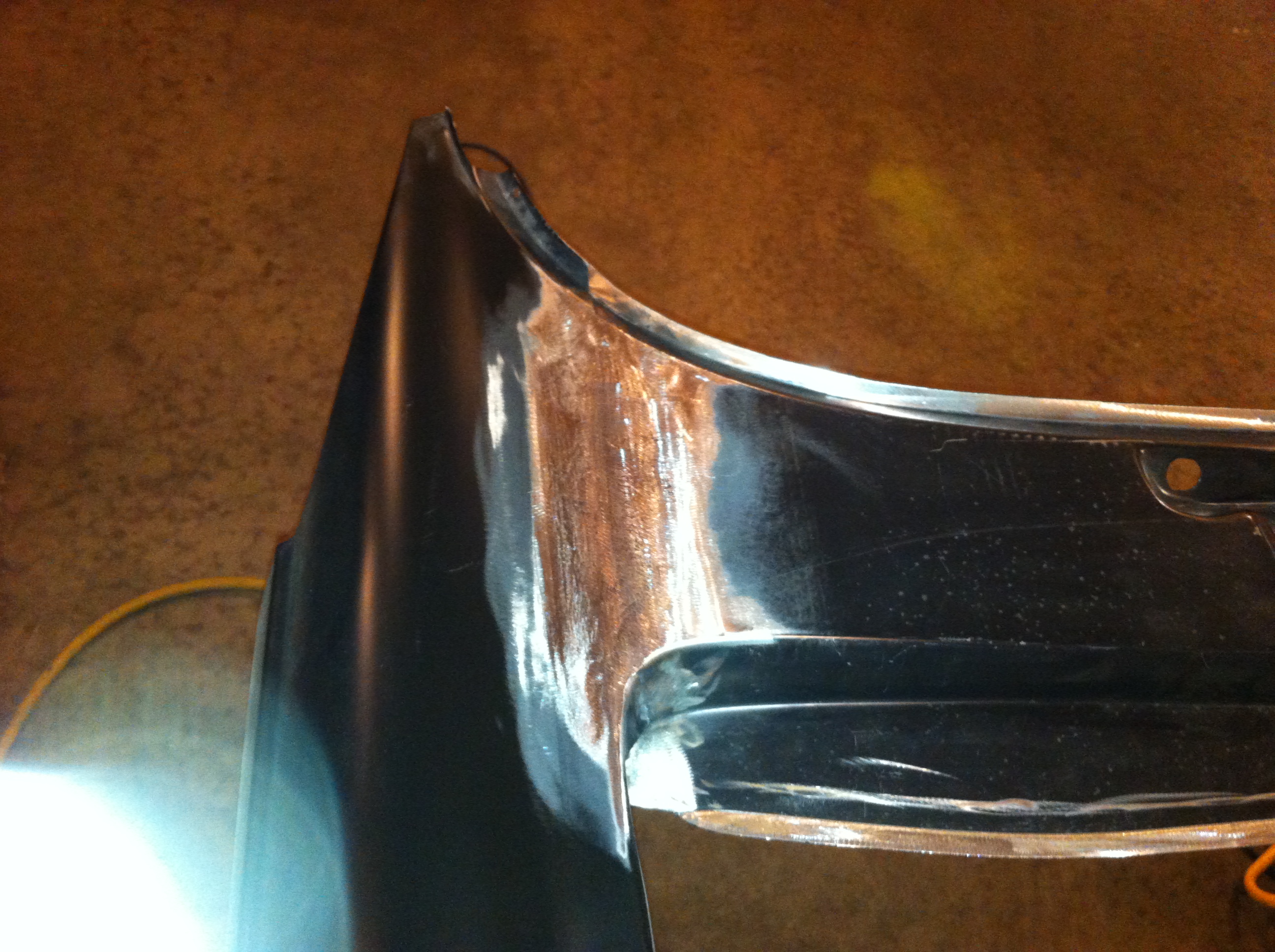

Here's the first metal finished seam from the cowl to the fender.

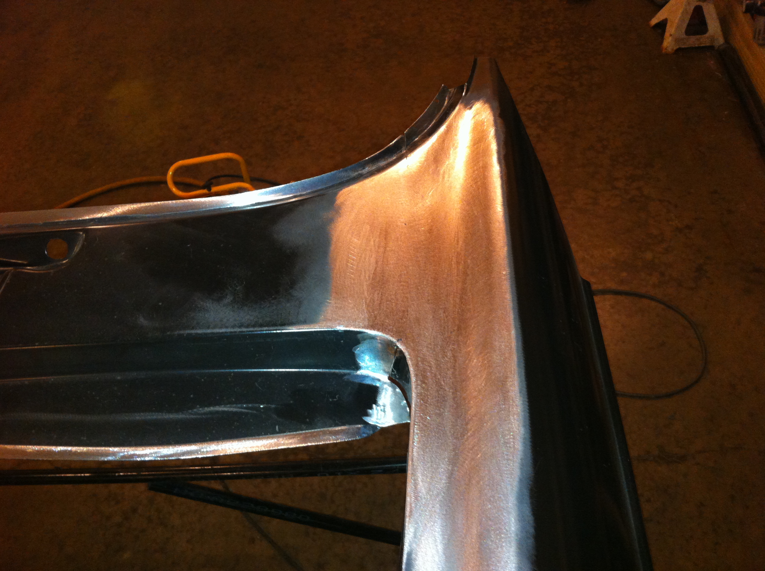

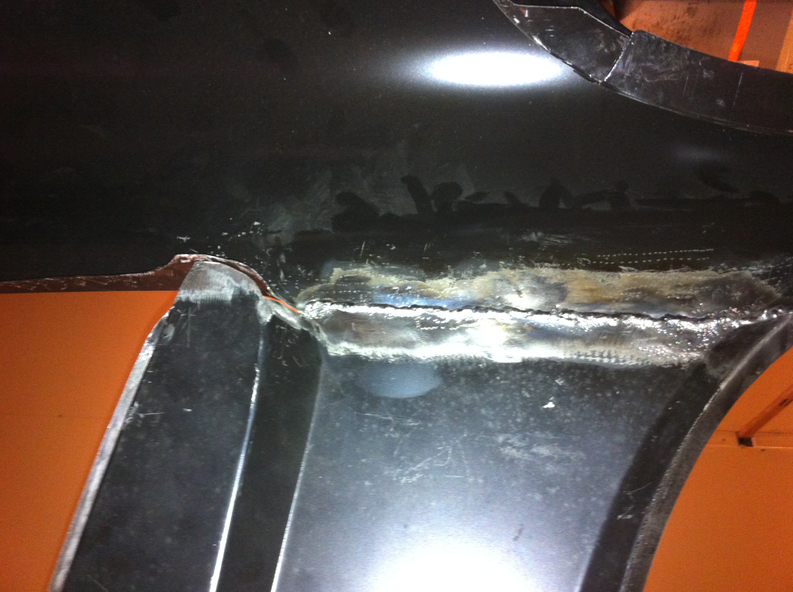

Part of the process when metal finishing is to Anneal the area you want to work. Here is a photo of the process. First you blow acetylene soot on the area you want to anneal. Then using a torch you work the area burning off the soot. Just enough to dissolve the soot and not over heat the metal. You want to relax the molecules not distort the panel.
Here is the second seam after metal finishing.

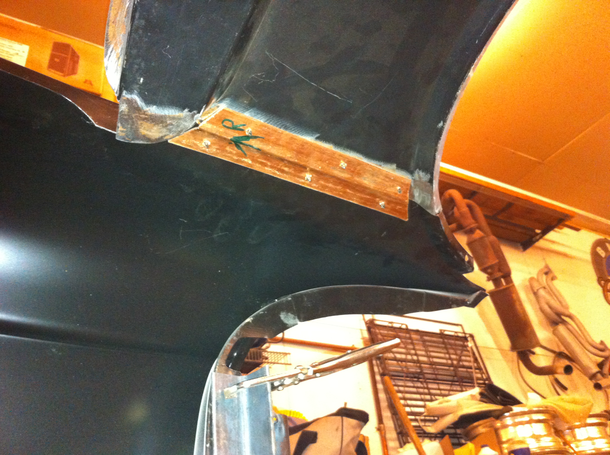

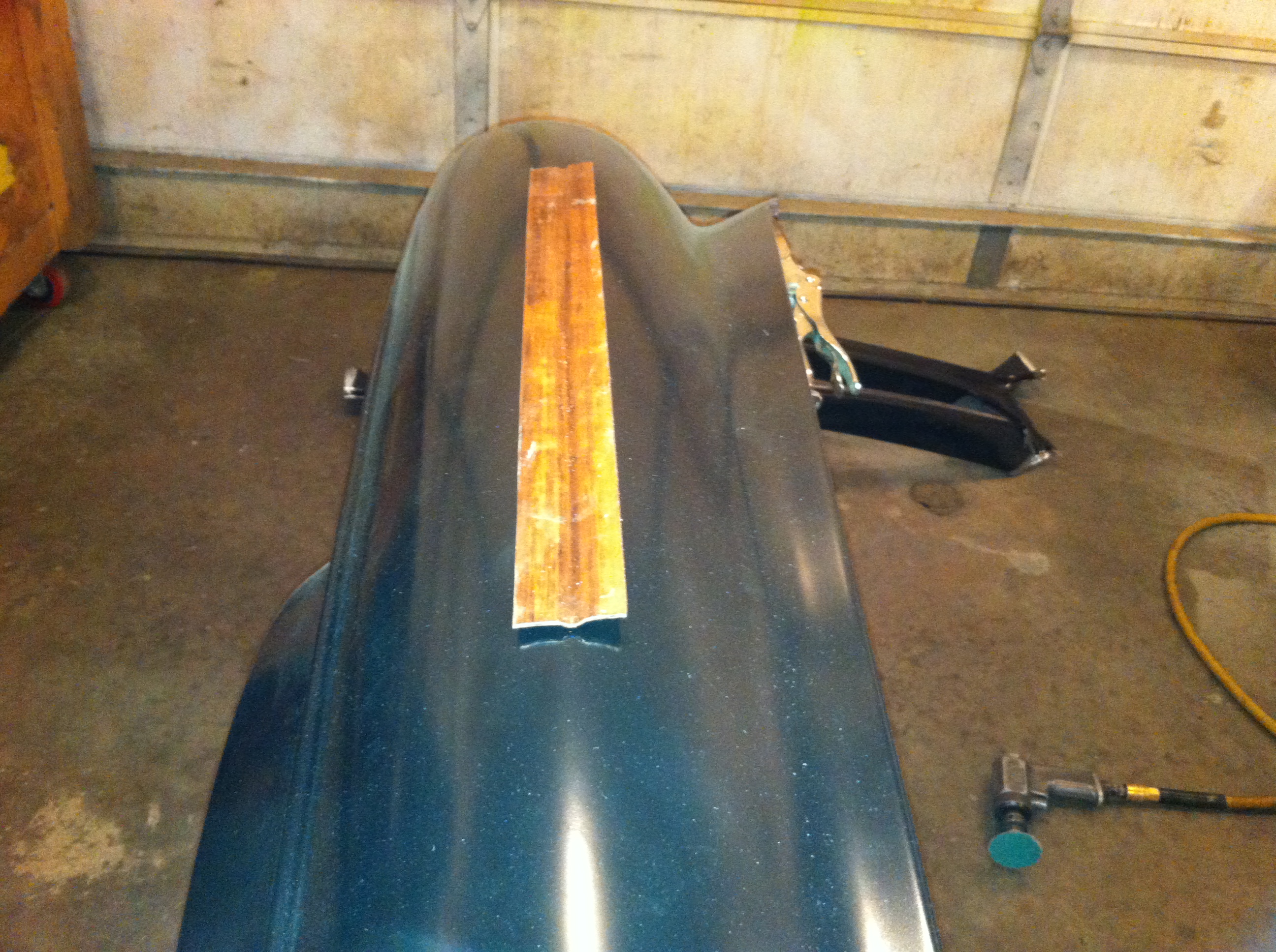

A couple more things you may find interesting. I used a copper strip as a back up. Notice I used my bead roller and rolled a bead groove down the middle. This allows the weld metal to protrude giving a good strong weld.
This is the under side of the fender to cowl seam with the back up strip in place.

Here are the two parts cleco'd together. This gives a nice tight fit to tig weld.
Here is the back side of the weld. Notice the pick marks on the back side from bumping the panels flush. The protruding weld and pick marks are exactly like the factory front end I took off this car.

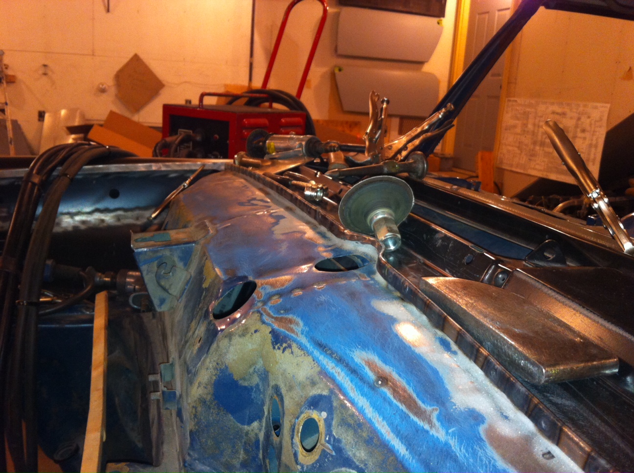

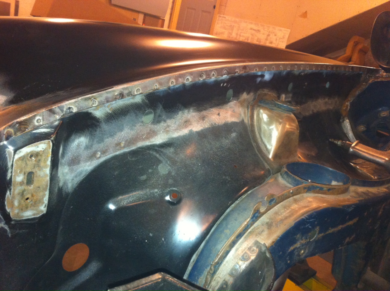

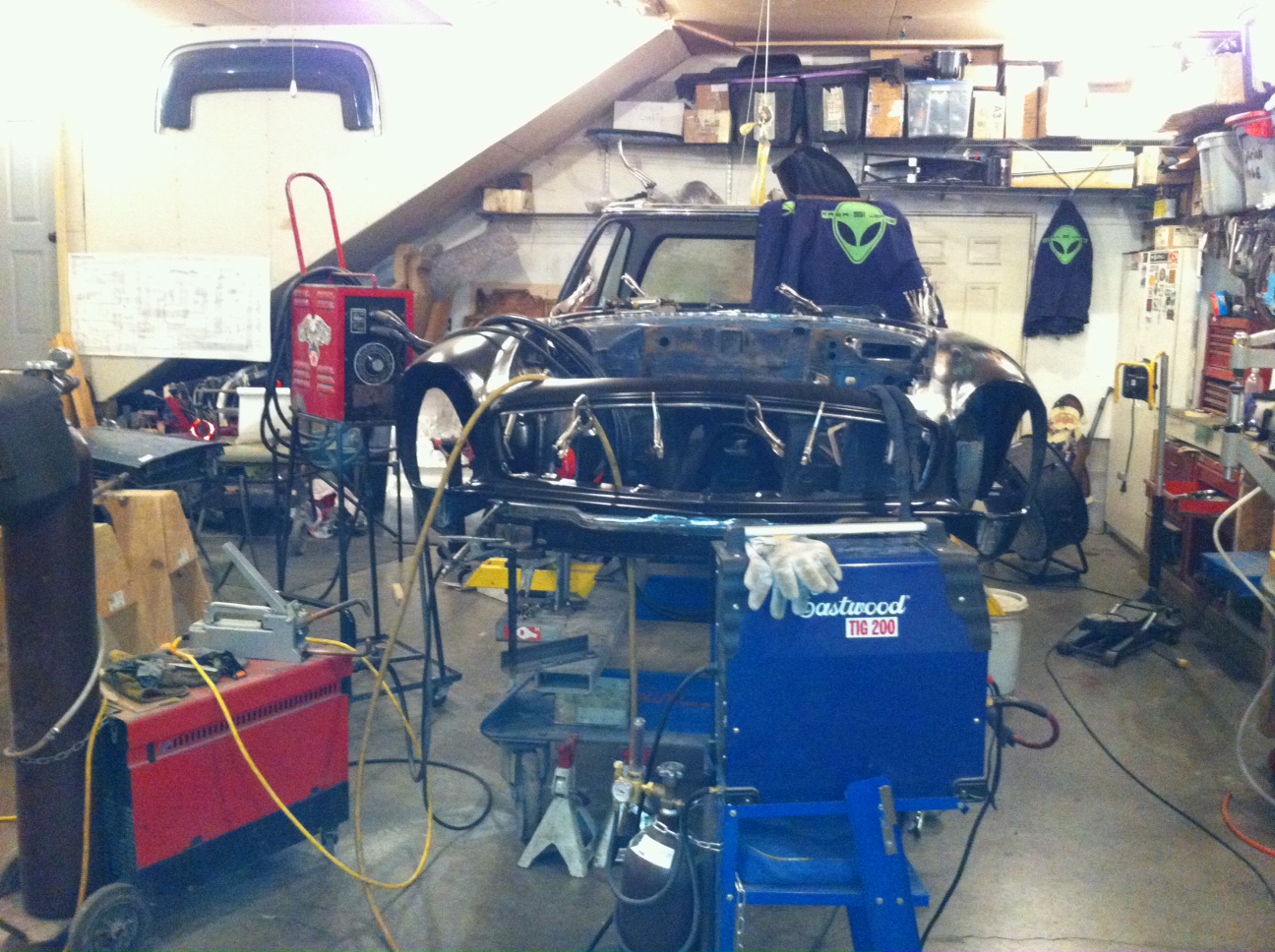

Spot welding and more spot welding. After several fittings I'm welding the front shroud to the inner panels on this 280 SL. Great hobby.
Drug out all the welders for this one.
The cowl top panel has a flange that is hammered over like a door skin then spot welded.
Then lots of spot welds all around the shroud. (IMG:style_emoticons/default/welder.gif)

OT, but how do you like that Eastwood TIG?

It looks like the copper strip is held on with clecos. Do you just weld the cleco holes to fill them when you're done? I should do more with my TIG but the MIG is just so EASY to use. (IMG:style_emoticons/default/biggrin.gif) (IMG:style_emoticons/default/welder.gif)

That tig works awesome! Aluminum and steel. Best bang for the buck.

QUOTE(Elliot Cannon @ Aug 3 2013, 01:13 PM) *
Yep. Easy to tig the 1/8" holes when your done. I switch from my mig to tig depending on what I'm doing.
