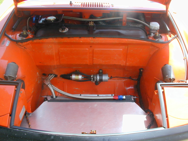

Here's a few (kinda lame) pics of my cooler setup. Note that the shrouding at the front spans all the way between the headlight buckets, and then tapers back to the width of the cooler itself. The taper is nearly 10" IIRC so I figure this gives a bit of "ram" effect. Also I don't have a pic with the top shroud piece removed, but as mentioned before the cooler is laid-back at approx 45 ° angle. The entire trunk floor section behind and under the cooler (back side) is cut out and flared slightly.

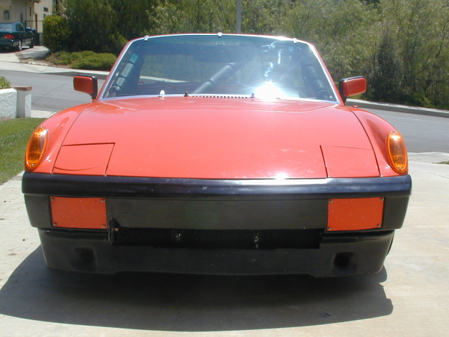

It's hard to see in this pic (black on black) but the inlet opening goes all the way between the headlight buckets axis as well, and is approx 6-7" high, covered with a medium mesh (small enough to keep significant pebbles or large bugs out).
The spoiler factor is interesting; I hadn't thought of it but it seems logical that a tiny stock valence would allow substantially more airflow to pass under the car vs thru the cooler. I will probably go to a spoiler about 1" deeper than this one if I can find one I like.

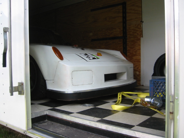

Here is my front end set up.. I formed a piece of aluminum to the shape of the IMSA spoiler on my car. I then riveted some 3" belting to the aluminum..
With this, the air has really only two places to go.... over the car, or through the oil cooler..
With the car at rest there is two inches of clearance....My friends tell me that at speed, the rubber is almost touching the pavement.. and under braking is scrapes the pavement.
My seat of the pants report tells me this works..

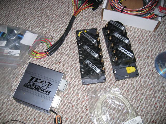

An update for everyone who was wondering what the result was. Took my car to the dyno a couple weeks ago, and it turns out my Autothority chip was -way- off for the modifications I had, and the car was running dangerously lean and had a strange power curve.
So, that's my best hunch as to why I had such high on track temperatures. Rather than throw more money at the Motronic with a custom chip, I decided to get this... Vrooom!
Busy with moving and work right now, but should have it put together in 3-4 weekends...
-Steve
