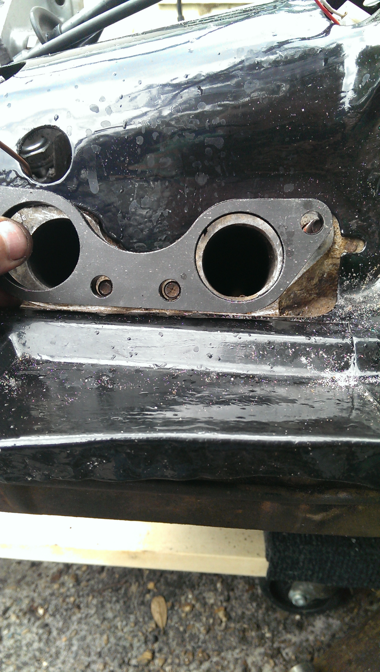

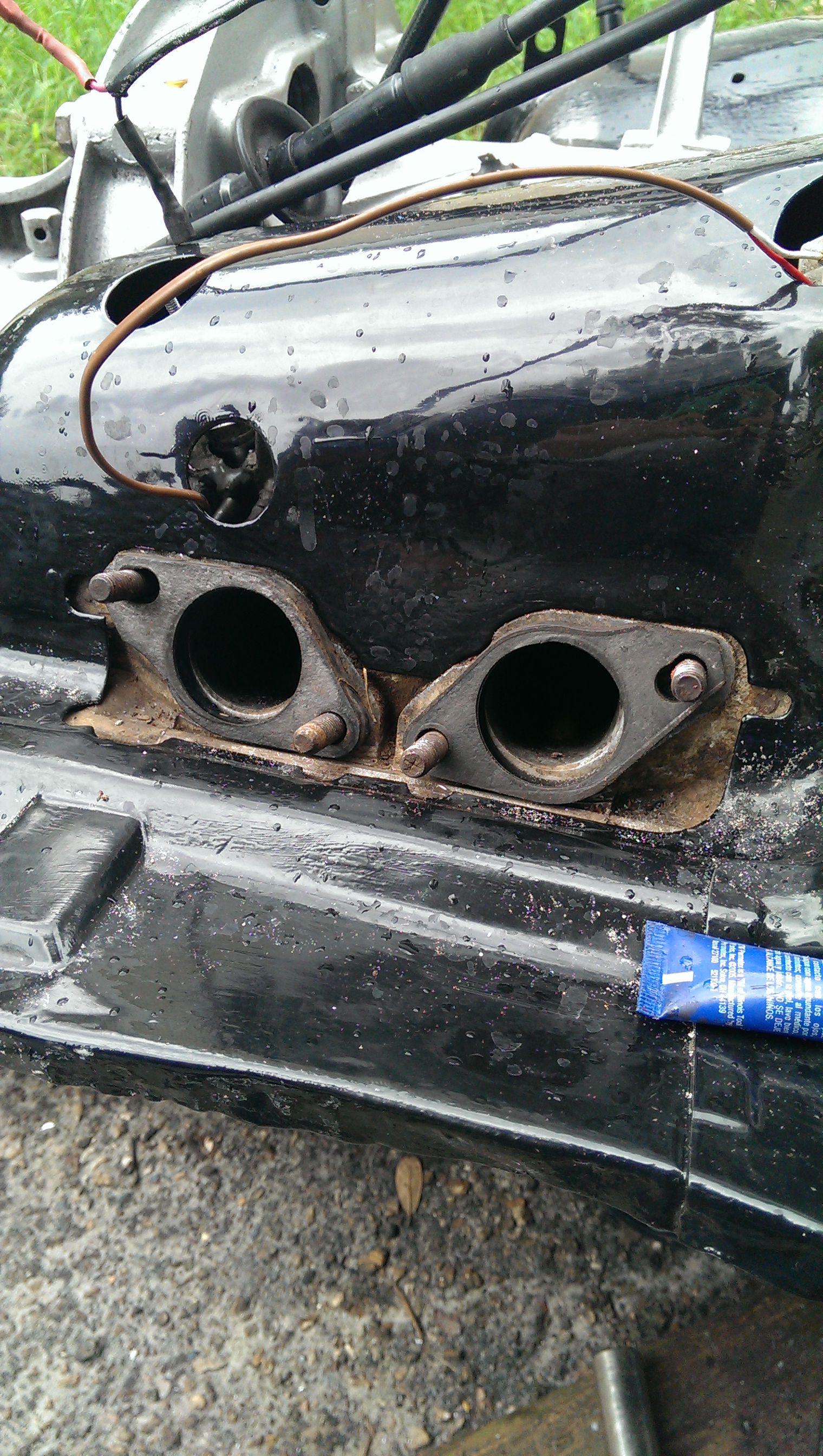

Hey guys,
Just finishing up the prep on getting my spare motor back in the car. Came across something a little "fishy". So, I swapped over just about everything that was on my 1.7, and this engine is *supposed* to be a 1.8. Everything fits just fine, except for the intake manifolds and gaskets. There are 4 intake manifold studs, but the outer studs are about 3/8 inches further apart than on the 1.8. So much so, that the new 1.7/1.8 phenolic spacers that I have do not fit over the studs. I noticed that the previous owner had cut the spacers in half to make two separate pieces, for each intake port. They still didn't fit quite right though, and part of the spacer protrudes into the intake hole/bore.
I'm wondering if these are some kind of other Type 4 head, perhaps from a bus? Pictures to follow in a moment...

The intake manifolds line up fine, from what I can tell. As I stated, they came pre-drilled, it seems, for both dimensions. I.e. the outer holes in the manifolds are elongated as if they were intended for dual-uses.

QUOTE(skeates @ Aug 26 2013, 12:10 PM) *
Was the mis-match the same on both heads? Could be that one of the studs pulled and the PO installed a crooked helicoil?
I was thinking similar when I saw the pix George posted, ("The tins fit normal - what would be the difference?")
George, did you snap any pix of the intake ports without the gaskets? Is there any evidence that the original studs may have been relocated (possibly to fit some oddball intake manifold somebody kludged together)?

ThePaintedMan
post Aug 26 2013, 02:04 PM
Posts: 3,887
Joined: 6-September 11
From: St. Petersburg, FL
Member No.: 13,527
Yeah I knew about the square exhaust ports on the Vanagon heads, but not the intakes.
Both heads were the same (had the exact same dimension). I did see some welding on the backside of the intake stud (i.e. down in the fins area), but nothing blatantly obvious suggesting that it had been helicoiled before. Of course I was in too much of a rush to snap more pics. (IMG:style_emoticons/default/headbang.gif) The intakes that came on the engine are a little odd. They're very short and used bolts instead of studs, so I guess it is possible the PO decided it would be easier to fill in the original stud holes, then re-drill it for these manifolds? (IMG:style_emoticons/default/confused24.gif) They definitely weren't helicoiled though.
