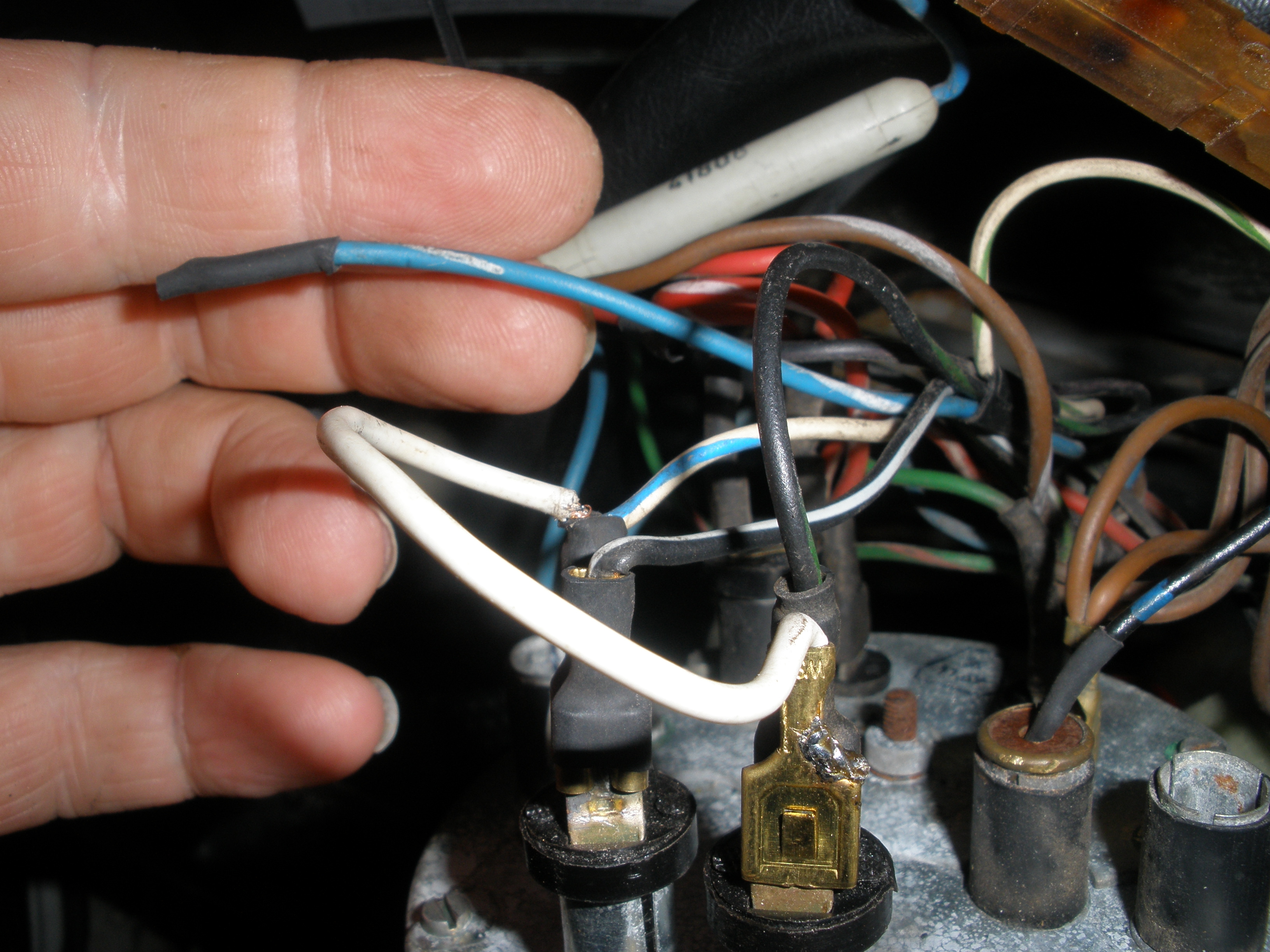

Durnit! Just when I thought we had it nailed (IMG:style_emoticons/default/mad.gif)
The indicator lights we rigged up work, true; but unfortunately when I turn the headlights on both indicators come on at the dash and stay lite which is to say they aren't blinking, just on (and the blinkers themselves stay offm unless I turn them on).
As an aside, if I turn the car off with a blinker on, all the running lights come on (and it always did this).
So, now I'm stumped again. Why on earth would the turn signal dash idicators come on when the headlights are on?

Did you use the blue white striped wire or the white blue striped wire?

Color blind. I used number #4 wire as marked in the picture which I was told is Blue with a white stripe.

Which picture? In the picture at the top of the thread the wire labeled #4 is the wht/blu and the wire labeled #7 is the blu/wht. In the picture in post 17 the wht/blu is #5 and the correct blu/wht is #4. You want the wire that is #7 in the first post and #4 in the second post. That other wire (#4 in the first post of the thread) is 12volts to the high beam warning light when the high beams are activated.
BTW the running lights on the side that the turn signal switch is turned towards will come on when the car is shut off. If both sides come on then you've got another problem, but separate from the turn signal one.

Reckon I'll unzip it and snap a picture so ya'll can double check it for me :-(

Pretty sure I goofed
What say you'ze
Jonathan Livesay
post Aug 30 2013, 08:25 PM
Post #32
Posts: 746
Joined: 13-March 10
From: La Canada CA
Member No.: 11,461
QUOTE(HalfMoon @ Aug 30 2013, 06:41 PM) *
What say you'ze
Yup.

Yes, the one you are holding should go to the turn signal indicators. The one you attached to the indicators goes to the high beam indicator light as Jonathan indicates. Maybe you should put number tags on the wires in future pics. Also, you may want to get a proper tach down the road and hook up all the proper indicators? They are cheap in the classifieds. You can use the 914 tach with your V8 with one of these adapters-
