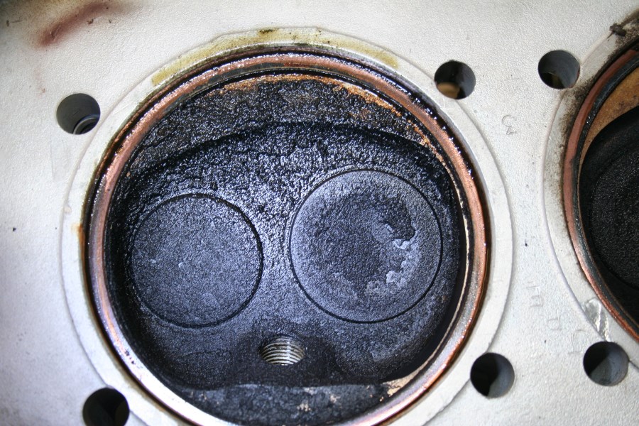

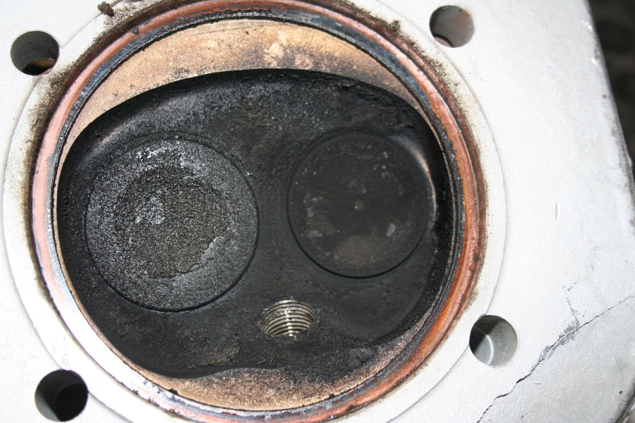

Member No.: 7,407
I finally got the head off. These are cylinders two and one respectively. Does it look like cyl. two has been burning some Mobil 1? Number one is much better although it shows it's been running a little rich maybe? I really don't have the experience to tell. I'm pretty sure about number two though. (IMG:style_emoticons/default/lol-2.gif)

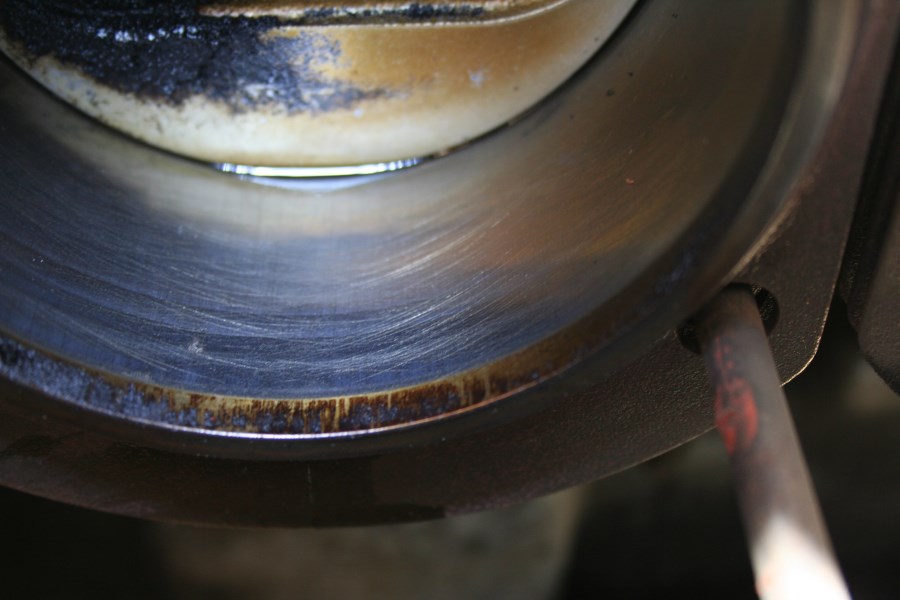

Member No.: 7,407
The cylinder walls look pretty good to me. I can't see any scoring. Both one and two look great. (IMG:style_emoticons/default/smile.gif)

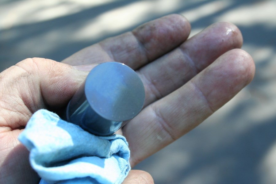

Member No.: 7,407
I pulled out one of the ceramic valve lifters. After 25,000 miles they look just like they did when I installed them about 8 years ago. Thanks Clayton, (where ever you are).

Member No.: 1,696
Not much wear .... you can still see the cross hatching on the cylinder walls. Looks good to go to me.
