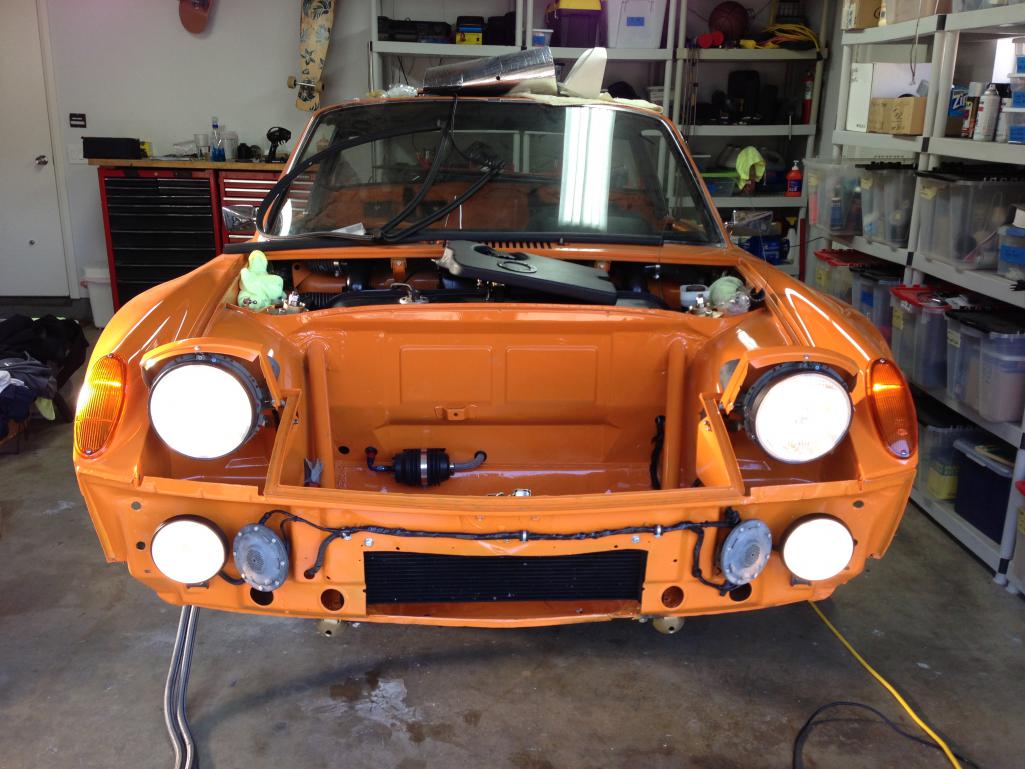

The objective of the dual rad install is to avoid the big hole in front.
filling the trunk with bulkheads and ducting,thereby rendering the
utility of the design moot.The 911 has the very same 2 cooler approach
by necessity of purpose.Are there any wassermensch here who have made
a doppel cooler setup?Not simpler or expedient to merely drop a vette rad
in and be done with it.Having modified the 914 to the degree of a V8,what
class and against what Porsche would you be competing?
The 2cooler approach has it's own difficulties,however when the lid is lifted,
it would look normally stock,with a spare.There is plenty of room for 2.

QUOTE(veekry9 @ Oct 25 2013, 05:08 PM) *
Right About Here
That's basically where the headlight lives when it's not popped up. How are you dealing with that again?
--DD
post Oct 25 2013, 07:17 PM
Post #43
Resident German
Posts: 42,469
Joined: 21-January 03
From: Oakland, Kalifornia
Member No.: 179
QUOTE(Dave_Darling @ Oct 25 2013, 05:32 PM) *
There's plenty of space under the bucket to duct air into the wheel well ...

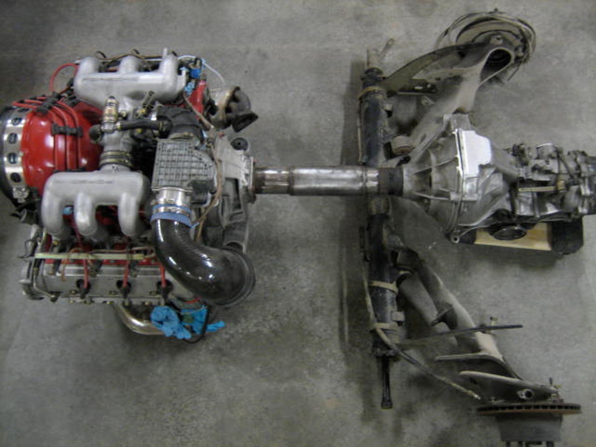

http://rennlist.com/forums/944-turbo-and-t...ild-thread.html
https://www.youtube.com/user/garcia171/videos
Here is a V8 running a 951 TX,and there is no doubt that steps were taken
to ensure the survival of it.Not cheap but certain.
Certainly Better Suited for V8 Torque.
Proven Track Use

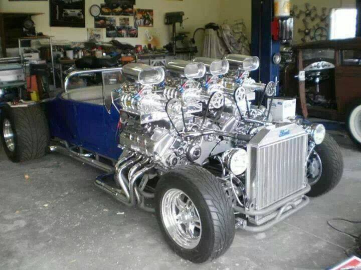

Saw this
and made
me think
of
this thread (IMG:style_emoticons/default/cool_shades.gif)

QUOTE(Dr Evil @ Oct 28 2013, 10:56 PM) *
Saw this
and made
me think
of
Ah.. the Spectacle.
1400+Lbs engine located behind the front axle
makes it a mid-engine,yes?
How do you make an adapter for 2 blowers?
Ask no more,there it is for you to peruse at your
pleasure.
Hemis no less.
Tractable Locomotive Power at 500 rpm.
http://jalopnik.com/5262849/bow-to-the-fur...ed-1970-mustang
https://www.youtube.com/watch?v=b1E_OBPpEVs
What could be cooler down at the A+W?

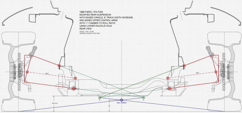

To what advantage would anyone consider
a wheel to o/p flange 5-stud conversion?
I suppose the springplates carry the majority
of the load.Would totally change the way the car rolls.
Incidentally,has anyone here done a graphical
analysis of the 914's suspension geometry?
(haven't seen any mention)
Something like this

By the way,How does this look to you all?
Hate those mirrors, can't stand them ... (IMG:style_emoticons/default/barf.gif)
But i'm guessing you're talking about the dual fog lamps.
PS: I really like what they did to the taillights on that widebutty.
Yeah
I won't be doing the massively intense widebody 914 on this trip.
I've kicked the idea around a little in GIMP and it kinda looks
like what the factory might have done if they decided to
install the round sloped headlamps ala 911.
I even tried the trioval shapes similar to Boxster/Cayman.
The job should/could be done by a panelbeater with skill.
The result would look as a 914/911 hybrid genetically.
Not the usual flares.And who can tell what a teener's visual acuity
would prefer?A deviation from bone stock is narp.
The larger(wider) grills purpose it to facilitate the placement of the
coolant/oil exchangers in front of the low pressure area of the
wheelwells.911 sop.If one was inclined to install a sohc/dohc
Porsche V8 why would the rad have to be centrally placed in the
trunk and take space?It's likely true the latest Panamera Ex has
a single rad up front but the 914 is a unique piece of engineering.
In that way you may say I am a purist at heart.
