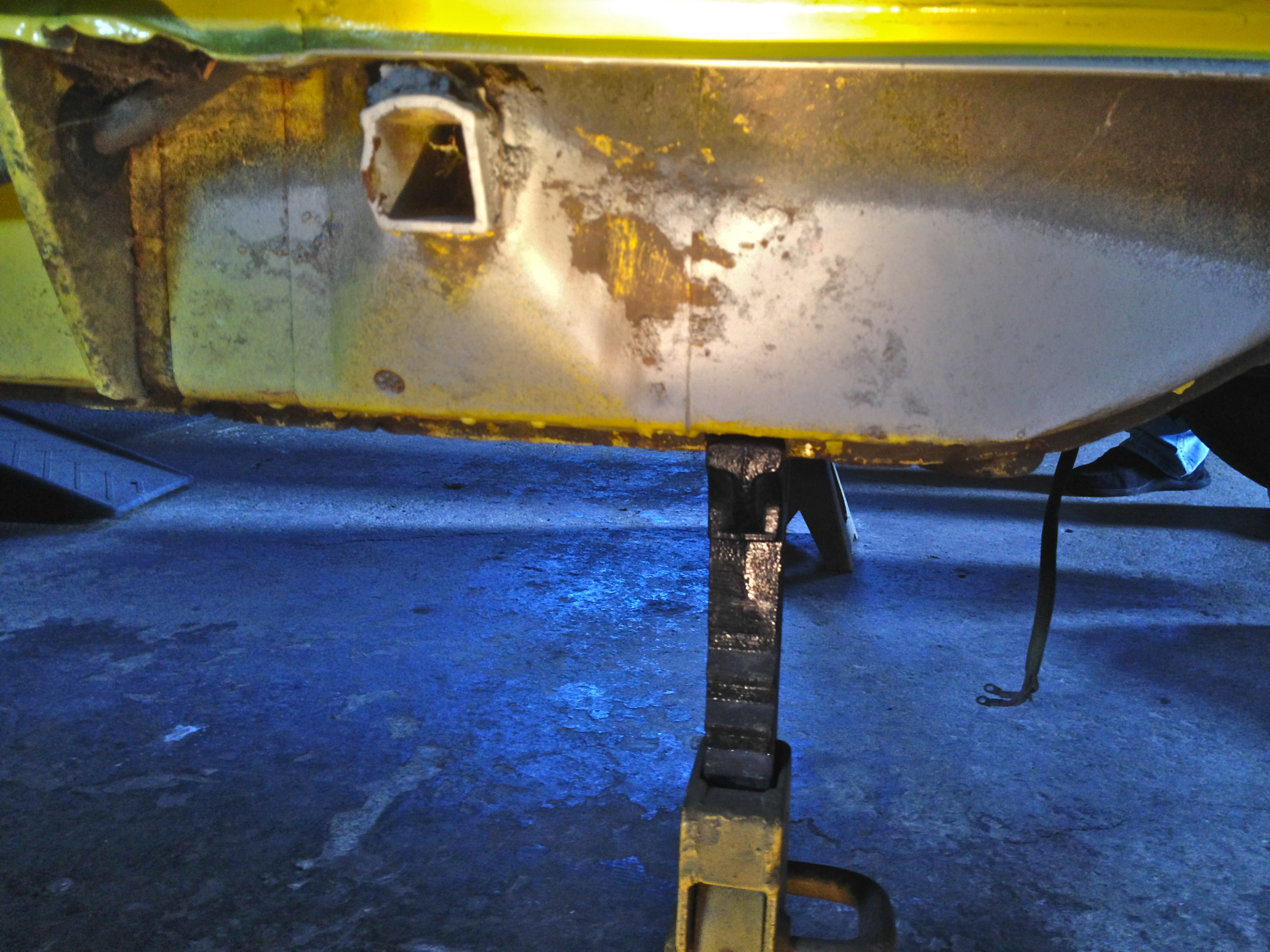

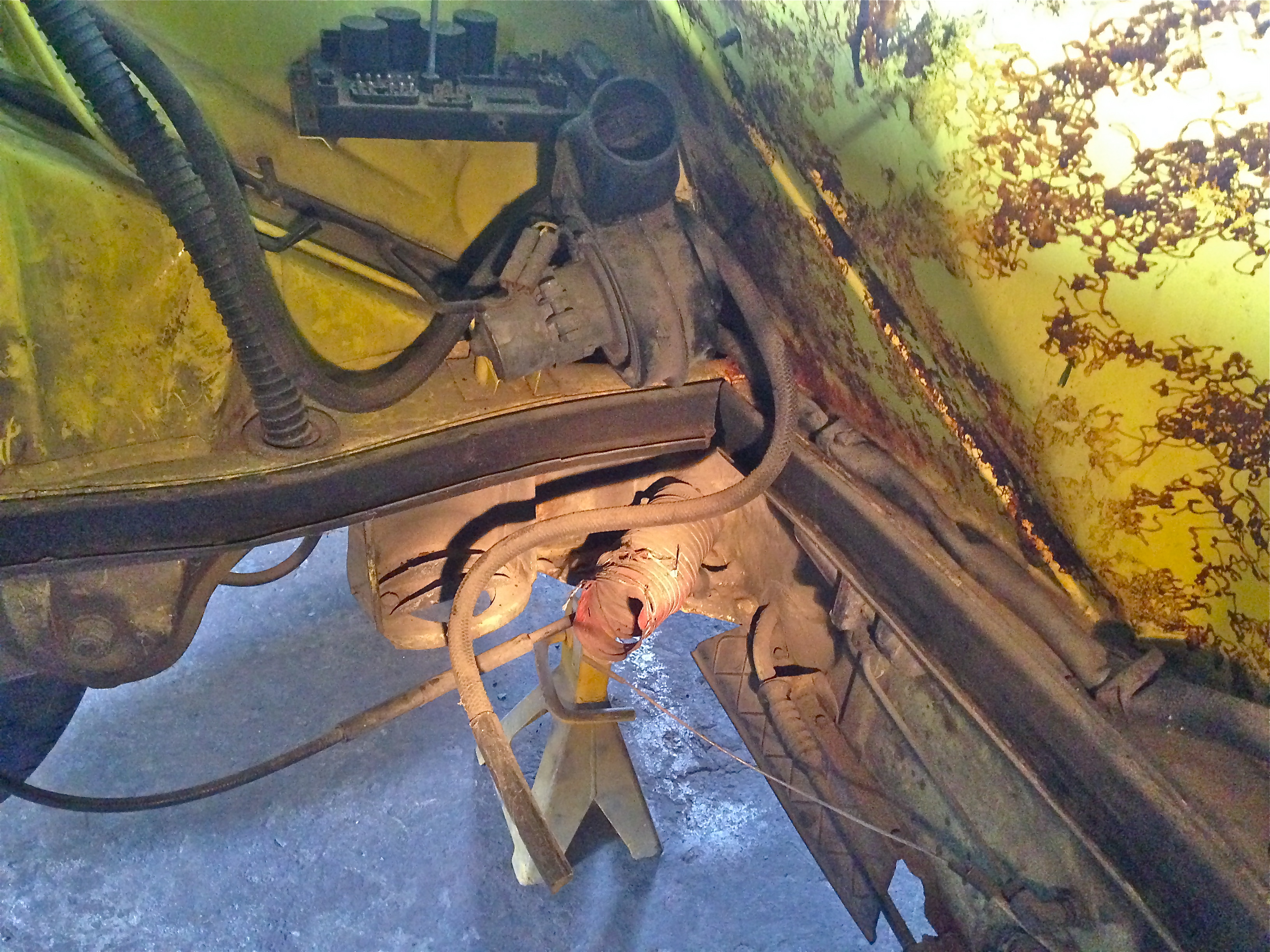

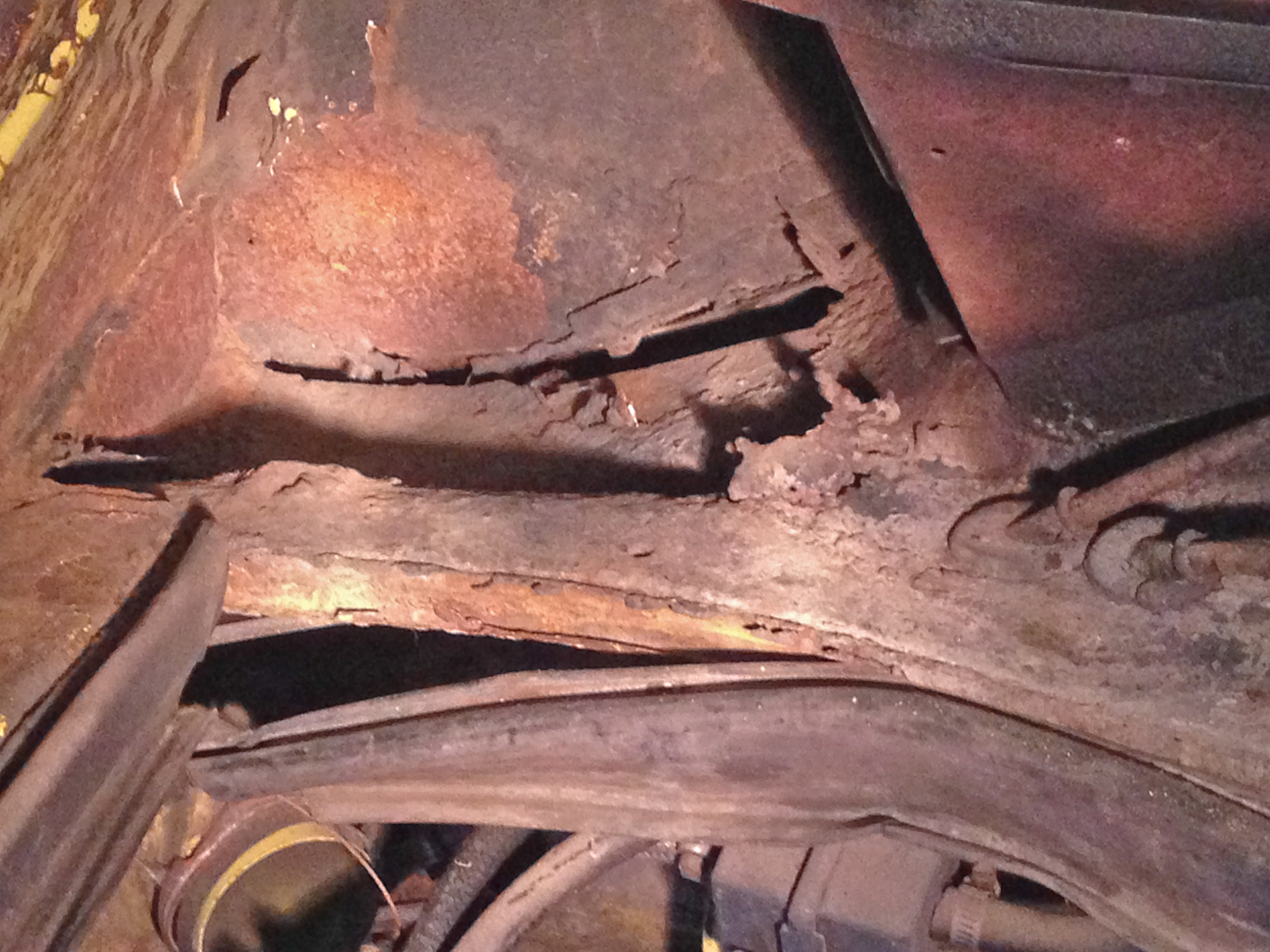

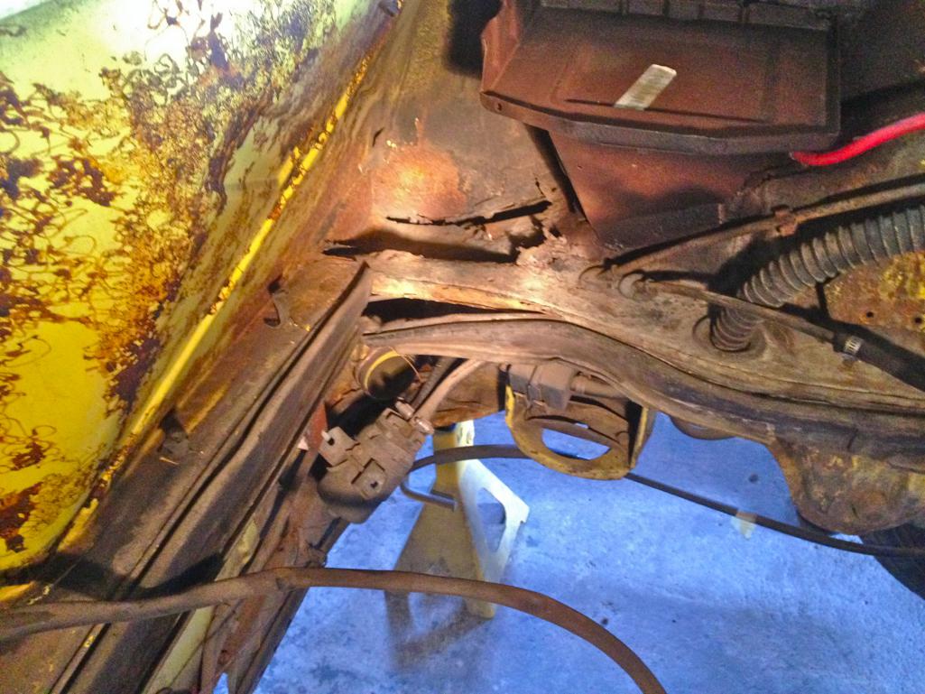

I don't know what your welding skills are?
or what your budget is?
but your rust may be beyond what a hell hole kit was designed for?
if you have a budget, meaning some cash, you may want to touch base with mcmark at http://www.originalcustoms.com/
and have him do the stuff that is beyond bolt-on?
he is about 60 miles from you.
can we see some more pics of this area and of the rocker below, and of the same areas on the drivers side?
jim

wes
post Nov 14 2013, 02:41 PM
wes
Posts: 1,600
Joined: 8-December 07
From: Ukiah Ca
Member No.: 8,436

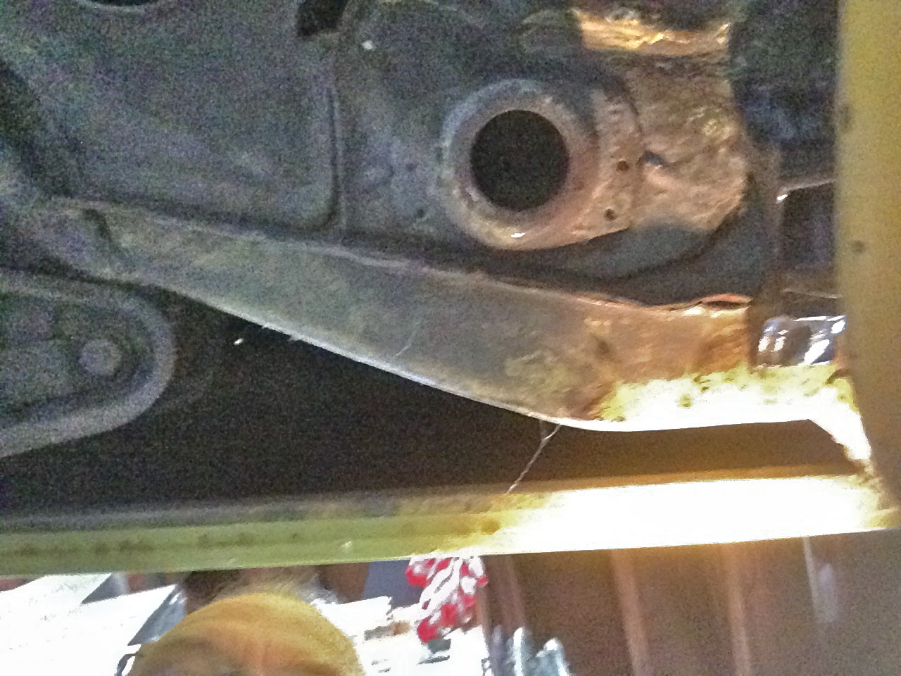

Looking up from under the car
wes
post Nov 14 2013, 02:44 PM
wes
Posts: 1,600
From: Ukiah Ca
Member No.: 8,436

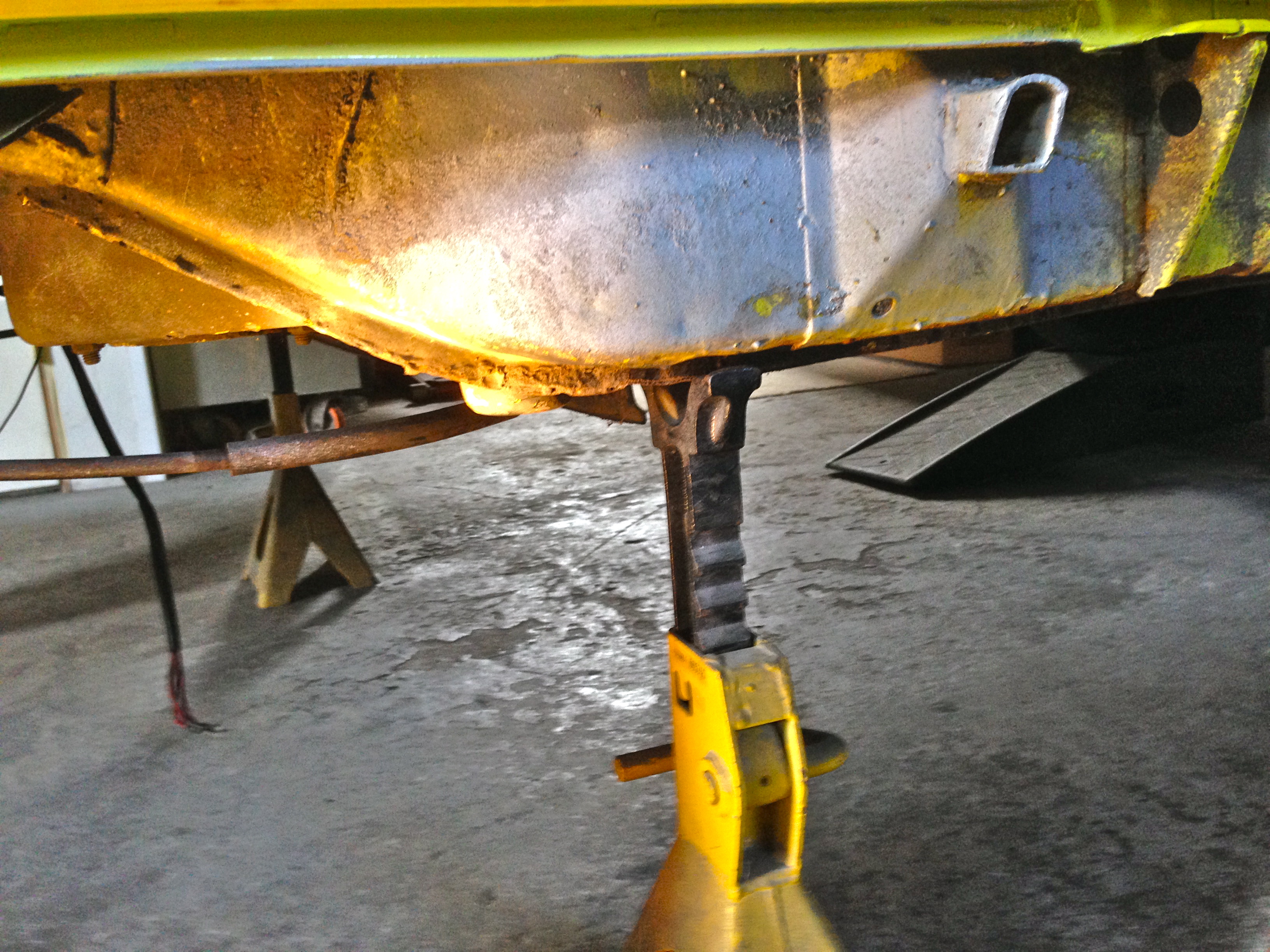

Passenger side view
wes
post Nov 14 2013, 02:48 PM
wes
Posts: 1,600
From: Ukiah Ca
Member No.: 8,436
Driver side view
wes
post Nov 14 2013, 02:50 PM
wes
Posts: 1,600
From: Ukiah Ca
Member No.: 8,436

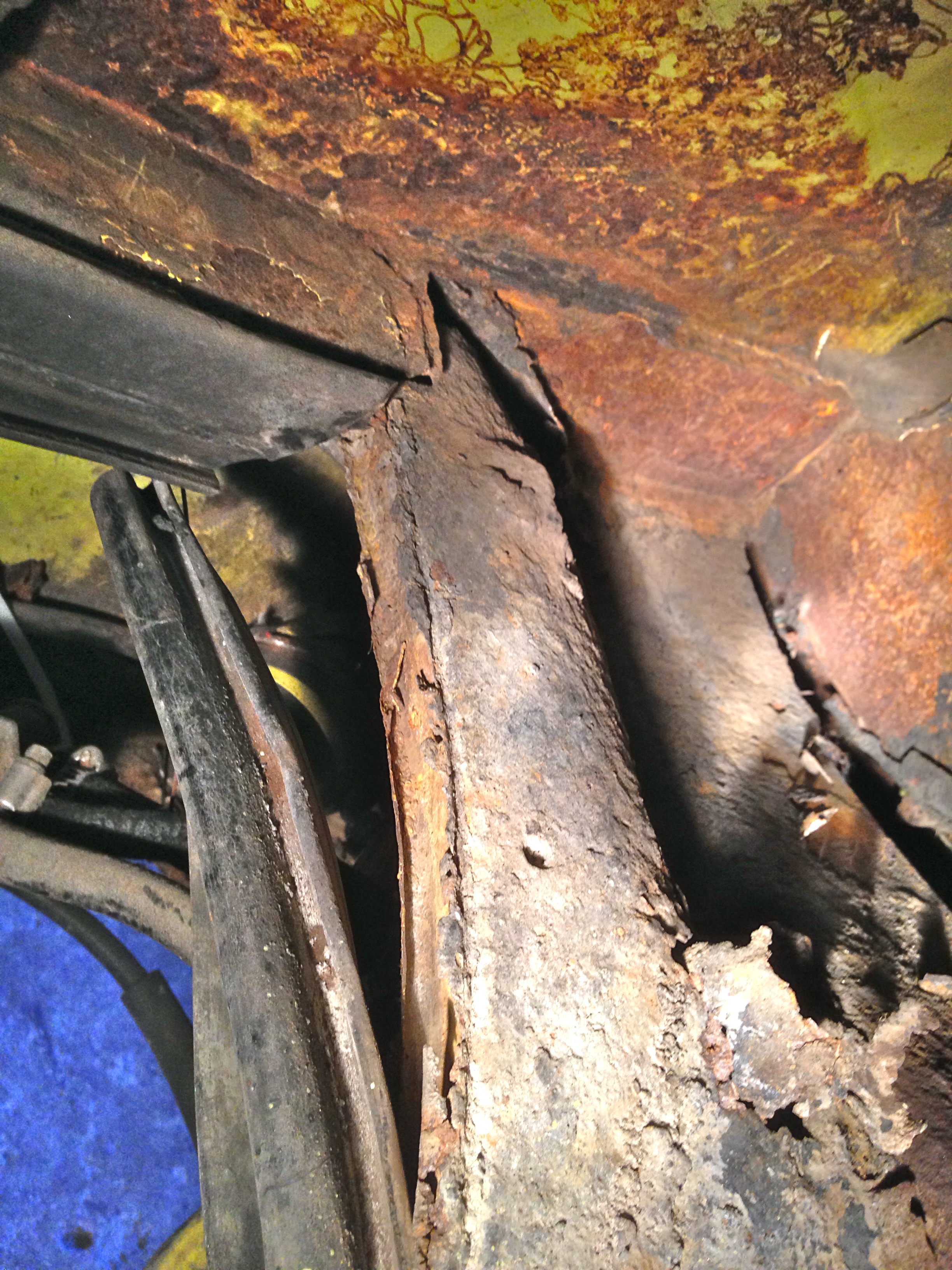

Driver side looking up
wes
post Nov 14 2013, 02:51 PM
wes
Posts: 1,600
From: Ukiah Ca
Member No.: 8,436
looking at driver side inside eng compartment.

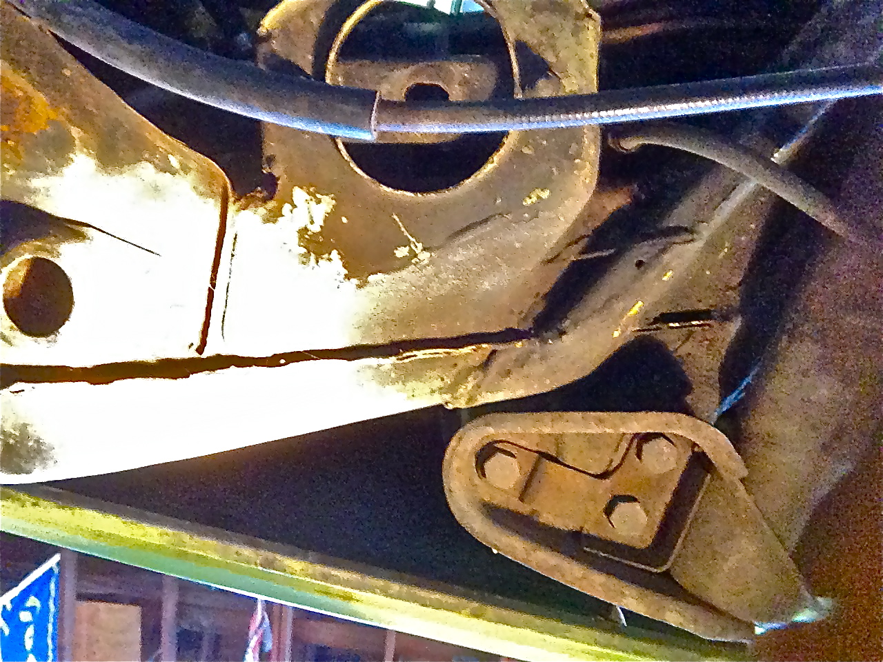

The bad! note the new battrey try the 1st painter welded just above the rust!!

closer!

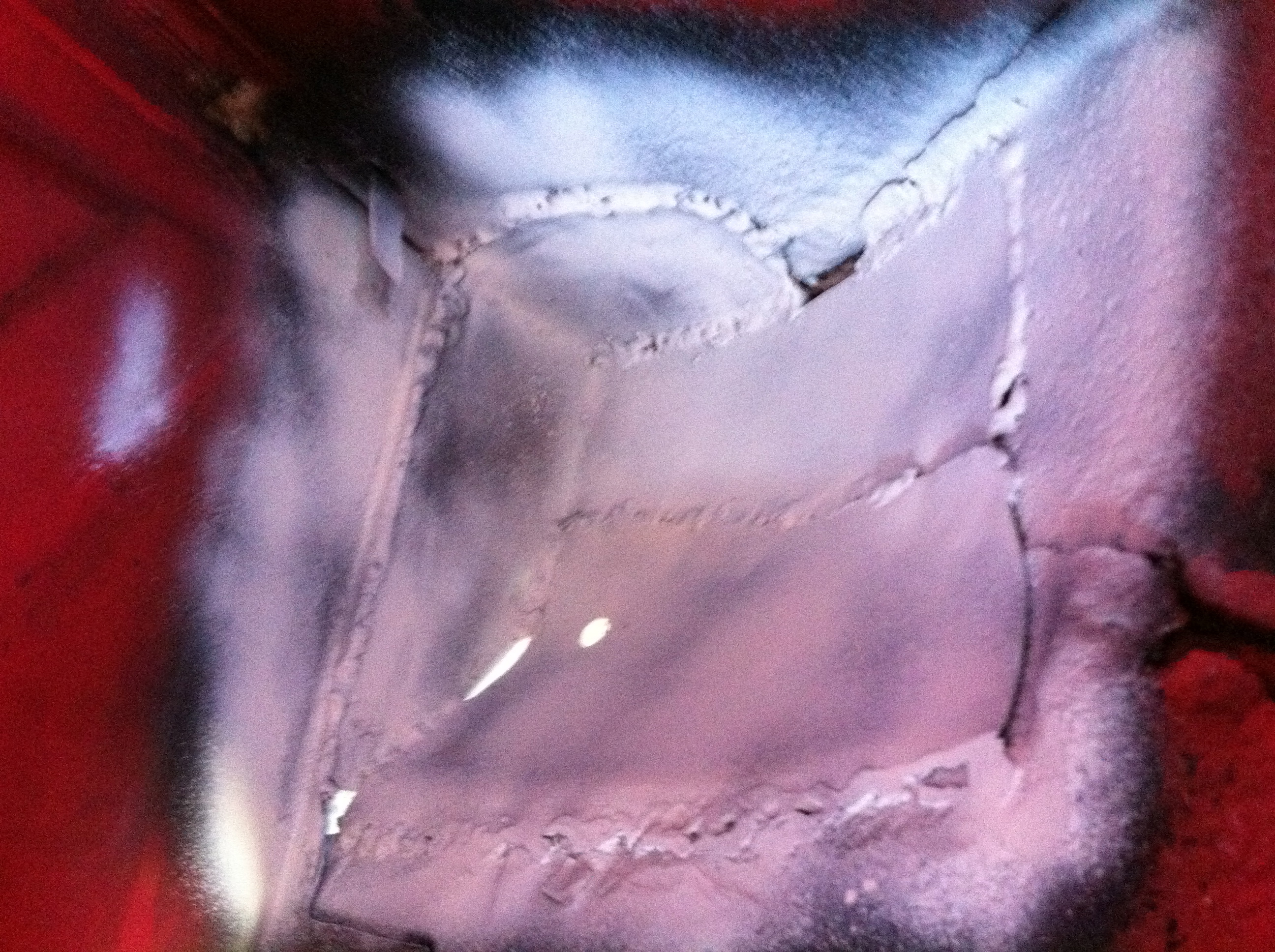

Work in progress! (IMG:style_emoticons/default/beerchug.gif)

After it was cleaned up it's not as bad as I thought, that is it's my first time after 5 914s (just drove them) and I thought it was much more serious. The worst of it is the engine tray and surrounding metal not the inner longitudinal!
Im happy to say I am actually learning about the car I've loved for so long though I think Im going to change my name to Oldenbroke! (IMG:style_emoticons/default/beer.gif)

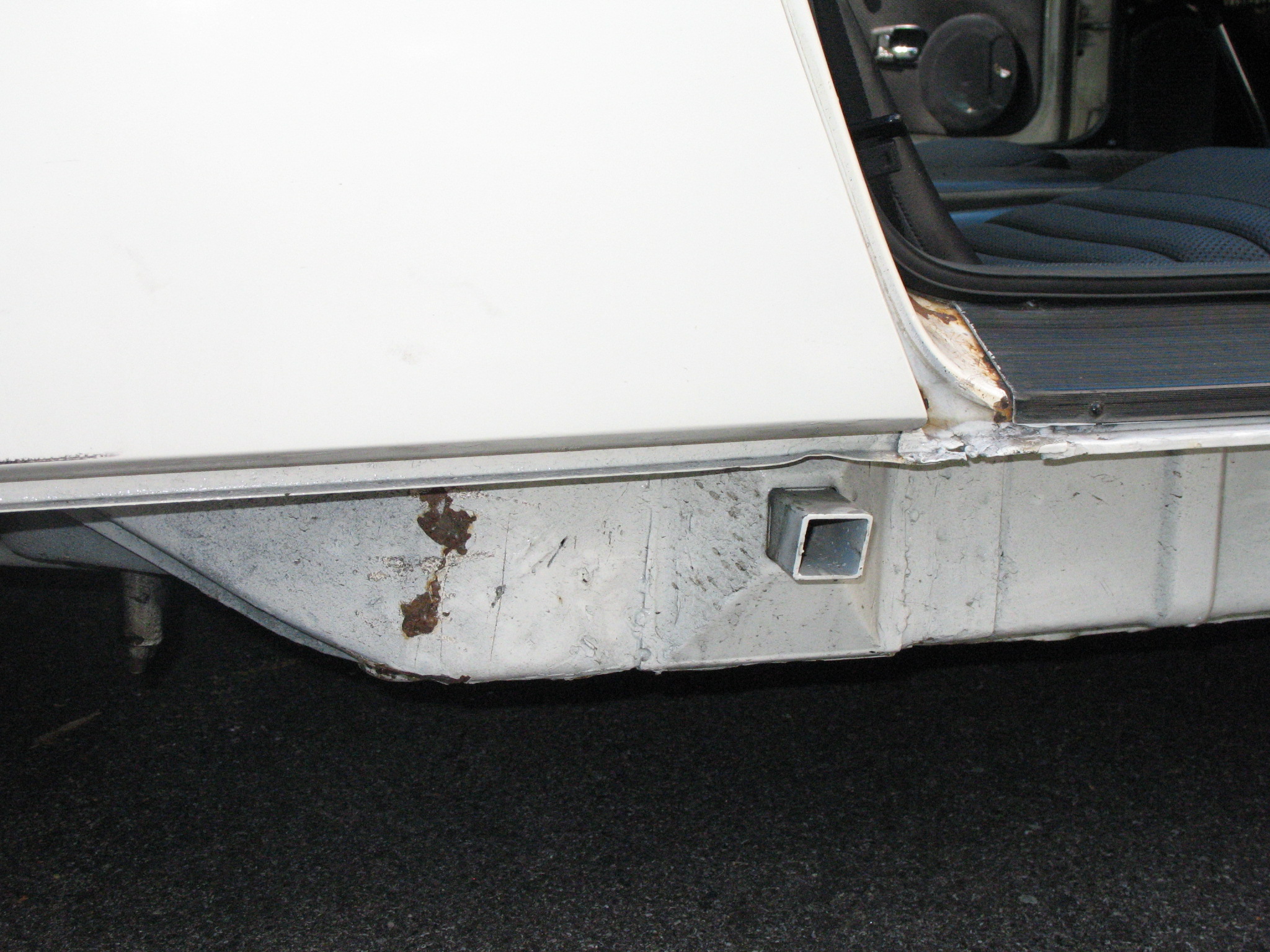

wes
post Apr 11 2014, 04:53 PM
wes
Posts: 1,600
From: Ukiah Ca
Member No.: 8,436

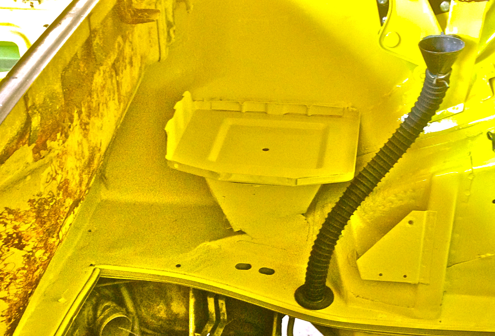

Well, really happy with the way it has turn out its done and new paint, now for next step!Attached Image
