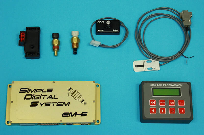

Then SDS looks like an option at $ 1200.00 for the second level unit? or am I still not getting this. (IMG:style_emoticons/default/slap.gif)
The MS will work out cheaper when all is said and done if you go the DIY route. To me it's at best break even if you go the pro built.
If your not doing a turbo the MS has a map sensor good for NA on the board, on the SDS the map is not included.
Remember the SDS like the MS will still need injectors, injector connectors,rails, wideband, pump, hose clamps, some tools, etc....
One thing of confusion is the 2 different terms on MAP and MAP...one MAP is a sensor and the other "MAP" is the values you input into the software program.

(IMG:style_emoticons/default/agree.gif) this is why my complete setup is $3000. (IMG:style_emoticons/default/wink.gif)
SDS is not cheaper overall, and the tuning process is terrible (IMHO). I know people have had success, but it's just clunky. Of course, complex computer based systems are familiar to me. ALL aftermarket FI systems absolutely demand you learn all about them. Otherwise it's just a matter of time before they bite you.
There is a trick to tuning SDS, once you get your head around it it's not that bad. It took me a while to figure it out.

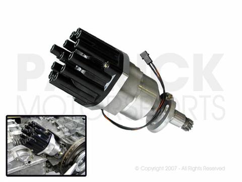

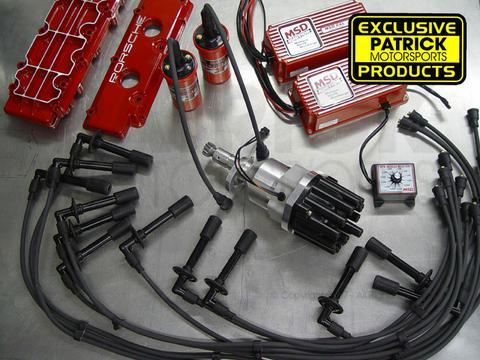

This is for my engine
It's a six with a jarvis/patrick twinplug MSD dizzy, kind of like to keep it....I'll see how it's on carbs first.
(IMG:http://www.914world.com/bbs2/uploads_offsite/patrickms.s3.amazonaws.com-26-1385758882.1.jpg)
(IMG:http://www.914world.com/bbs2/uploads_offsite/patrickms.s3.amazonaws.com-26-1385758883.2.jpg)

I got that dizzy dirt cheap for helping a bud with his FI install. it only has about 10 -15 hours on it. It was on a custom CIS turbo that he could never get the FI to idle right
With SDS I could get the ignition configured to control the advance curve on that dizzy with the MSD.
You would have to lock out the advance in the dizzy and use a crank trigger.
If I don't like like the webers this is what I love to do and why I'd consider doing it. All the sexiness of a twin plug Weber /6 engine with FI tunablity
I asked about doing ignition like this on the MS forum a while back and they thought I was on dope.
The SDS system number is EM-5E/MSD
About a third of the way down this page http://sdsefi.com/specific.html
(IMG:http://www.914world.com/bbs2/uploads_offsite/sdsefi.com-26-1385766541.1.jpg)
