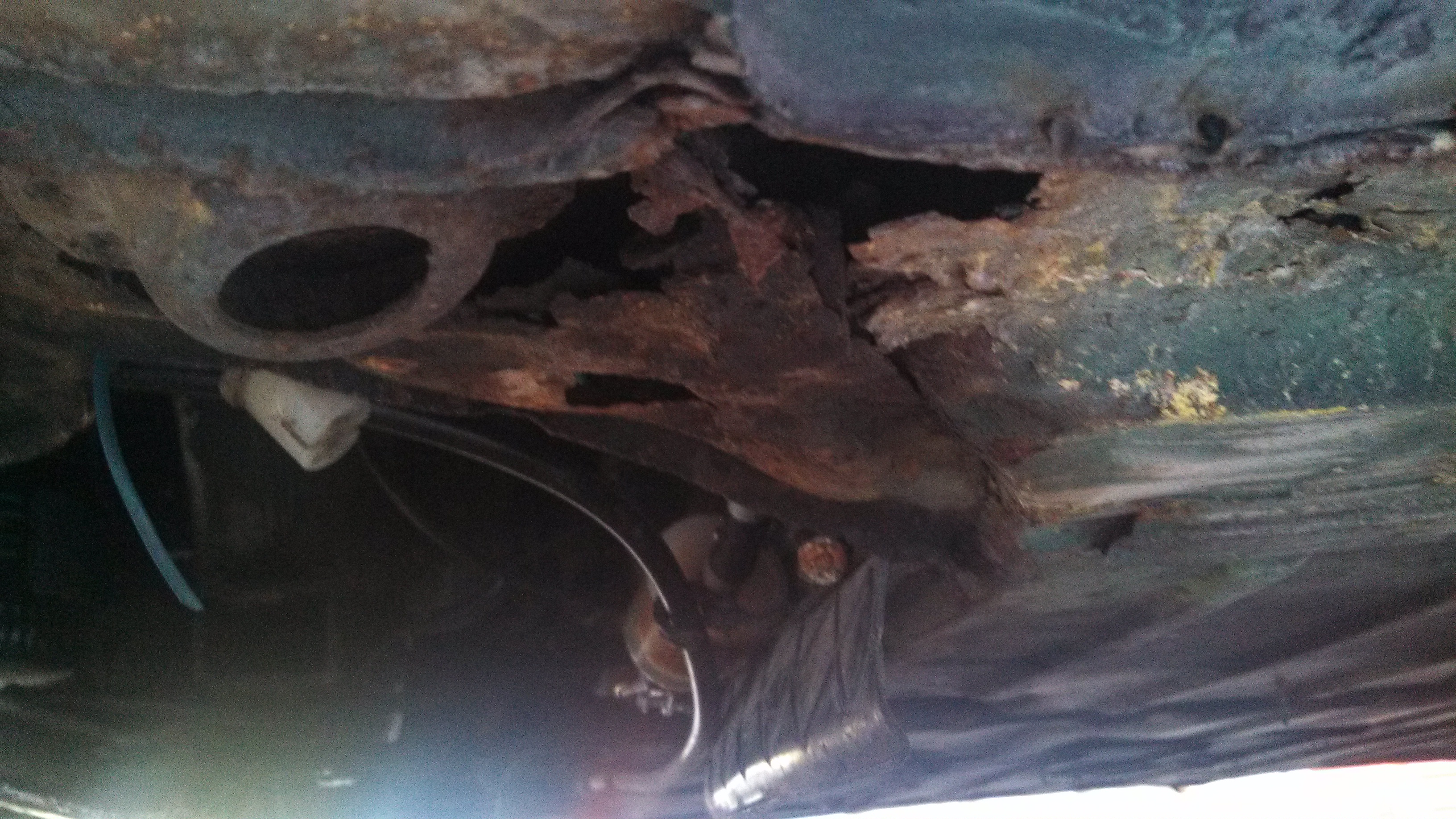

Okay, well after a day thinking about my day at the track yesterday I am quite curious what it would cost to get someone else to fix the hell-hole. I honestly dont even know anyone close to New Orleans that would work on this thing. Anyone got any ideas of a reputable shop in my vicinity and what I should expect to pay.
I have access to my own shop and a couple really good welder buddies but I am just intimidated by the project. Some of the repairs I have seen here are so extensive

QUOTE(last337 @ Dec 2 2013, 03:35 PM) *
How bad is it? Show us some pics ...

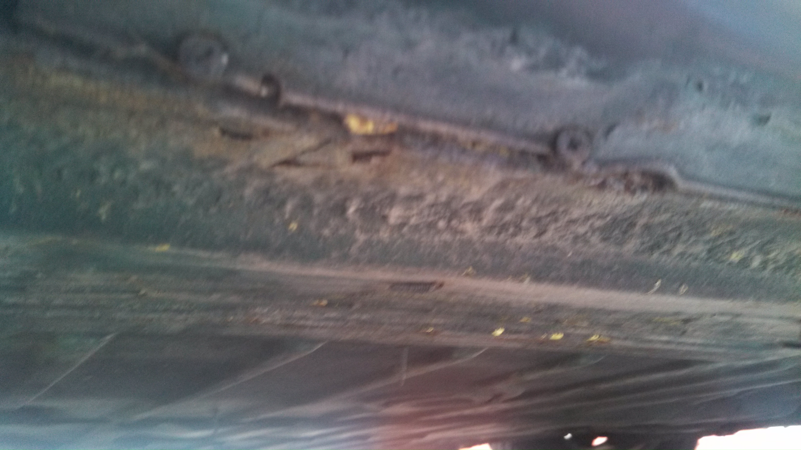

QUOTE(SirAndy @ Dec 2 2013, 05:42 PM) *
I would love to do this myself if possible but I have just never done any kind of metal work. I only have a few pics at the moment and it is hard for me to tell what would be involved in fixing it but Im sure you guys can tell a lot more. What other pics would be helpful? I can take off the rocker panels but I just dont want to lose the drywall screws holding them in hahah; previous owners do weird things (IMG:style_emoticons/default/blink.gif)

You pull the engine and interior. Budget $ 6k but who knows until you pull the engine and interior

From those pics I'd guess there's some more hidden nastiness lurking.
Disassemble to obtain better access, then start poking questionable areas.

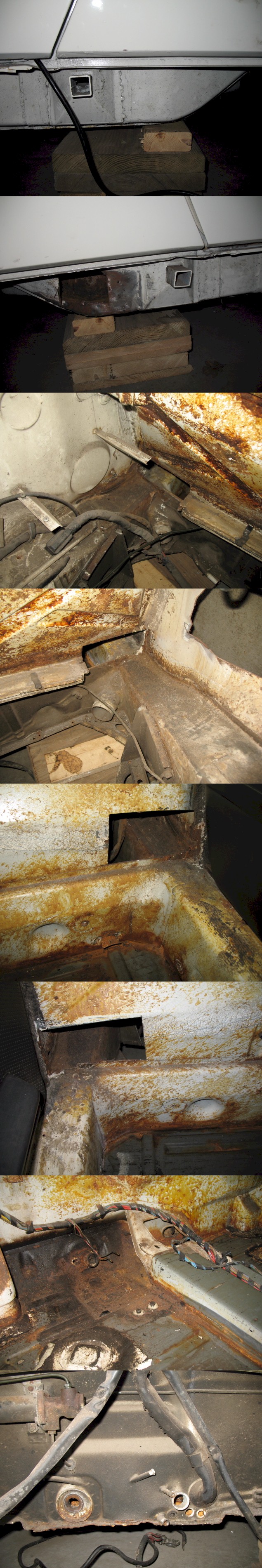

don't be fully invested in restoring this particular car until you know the FULL extent of the rust. based in these pics, you are looking at a big bill and that is before bondo and paint.
some potential areas of rust...

QUOTE(jimkelly @ Dec 2 2013, 06:28 PM) *
That looks like you have some substantial rust in the longs. That's the backbone of your car.
Not good ...
(IMG:style_emoticons/default/sad.gif)

that looks more extensive than just the hell hole.
show us a picture of the longitudinal please
I'd be aprehensive of tracking this car until its repaired.

QUOTE(last337 @ Dec 2 2013, 07:40 PM) *
So are you guys saying that this is beyond repair or just beyond being worth repairing? If I dont repair it then what else do I do with it? Is there are market for one like this?
No, it's not beyond repair, but it doesn't look like a quick fix. You'll have to invest some time and money to fix this right.
This thread will give you a good idea of what is involved in fixing this:
http://www.914world.com/bbs2/index.php?showtopic=16748
(IMG:style_emoticons/default/sawzall-smiley.gif) (IMG:style_emoticons/default/smash.gif) (IMG:style_emoticons/default/welder.gif) (IMG:style_emoticons/default/driving.gif)
In the meantime, please don't take it back to the track.
