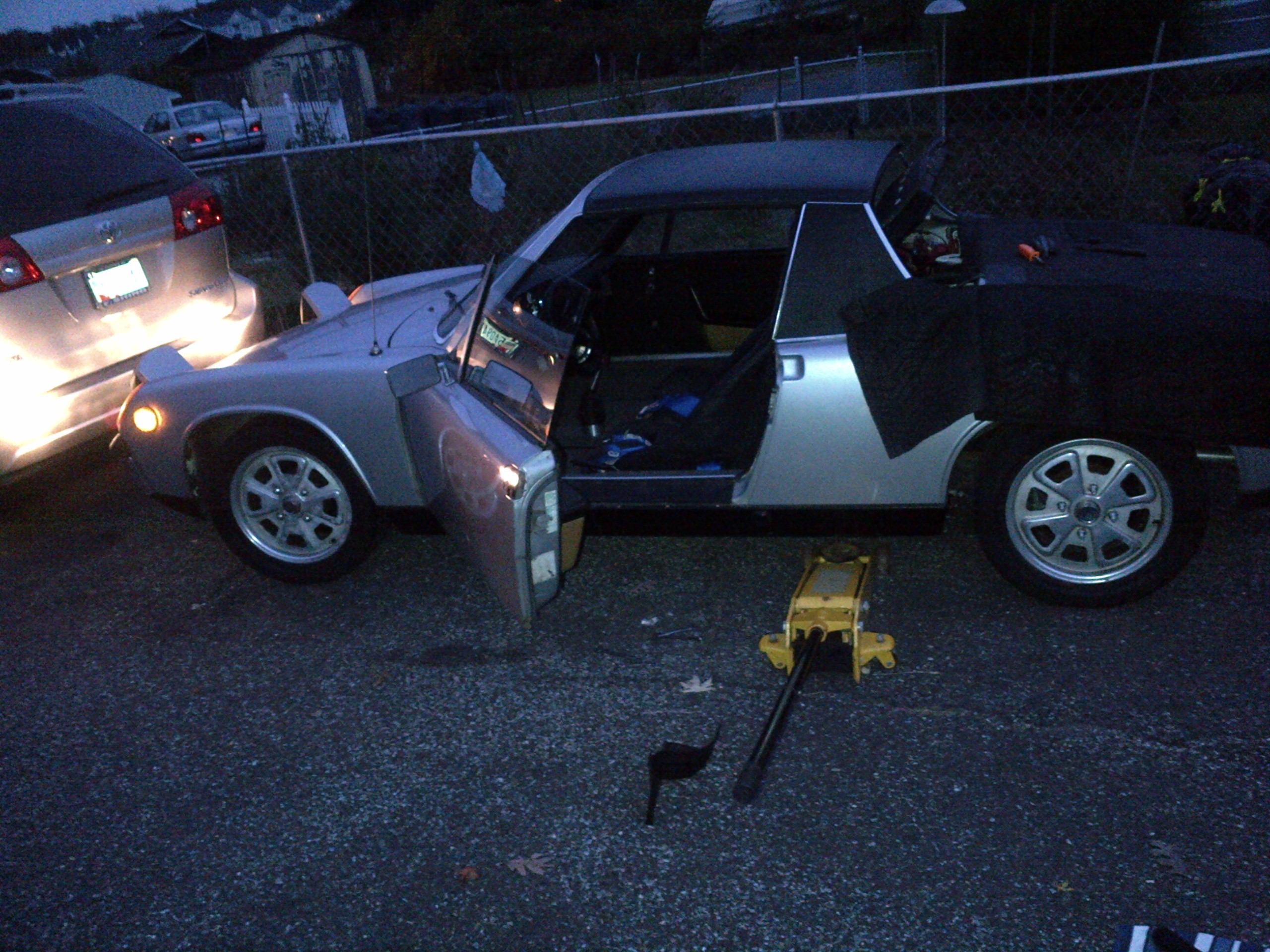

First off, let me say the car has been a blast (IMG:style_emoticons/default/piratenanner.gif)
But I didn't really understand what a "track" car was.
have ordered some of the needed parts from tangerine to get heat in the car.
I have also gotten a working bellows thermostat and ordered the cable wheel to hook the cooling flaps back up.

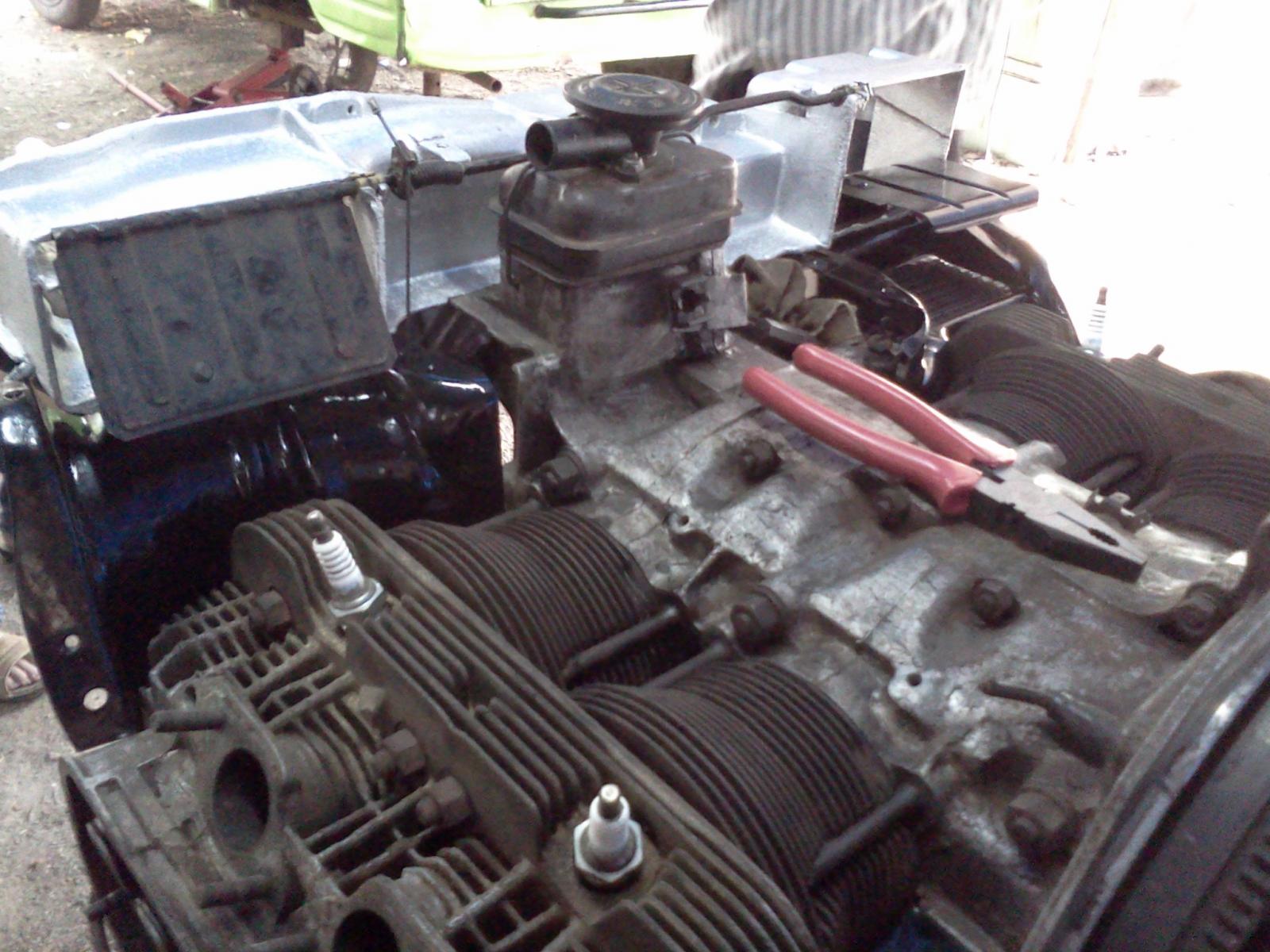

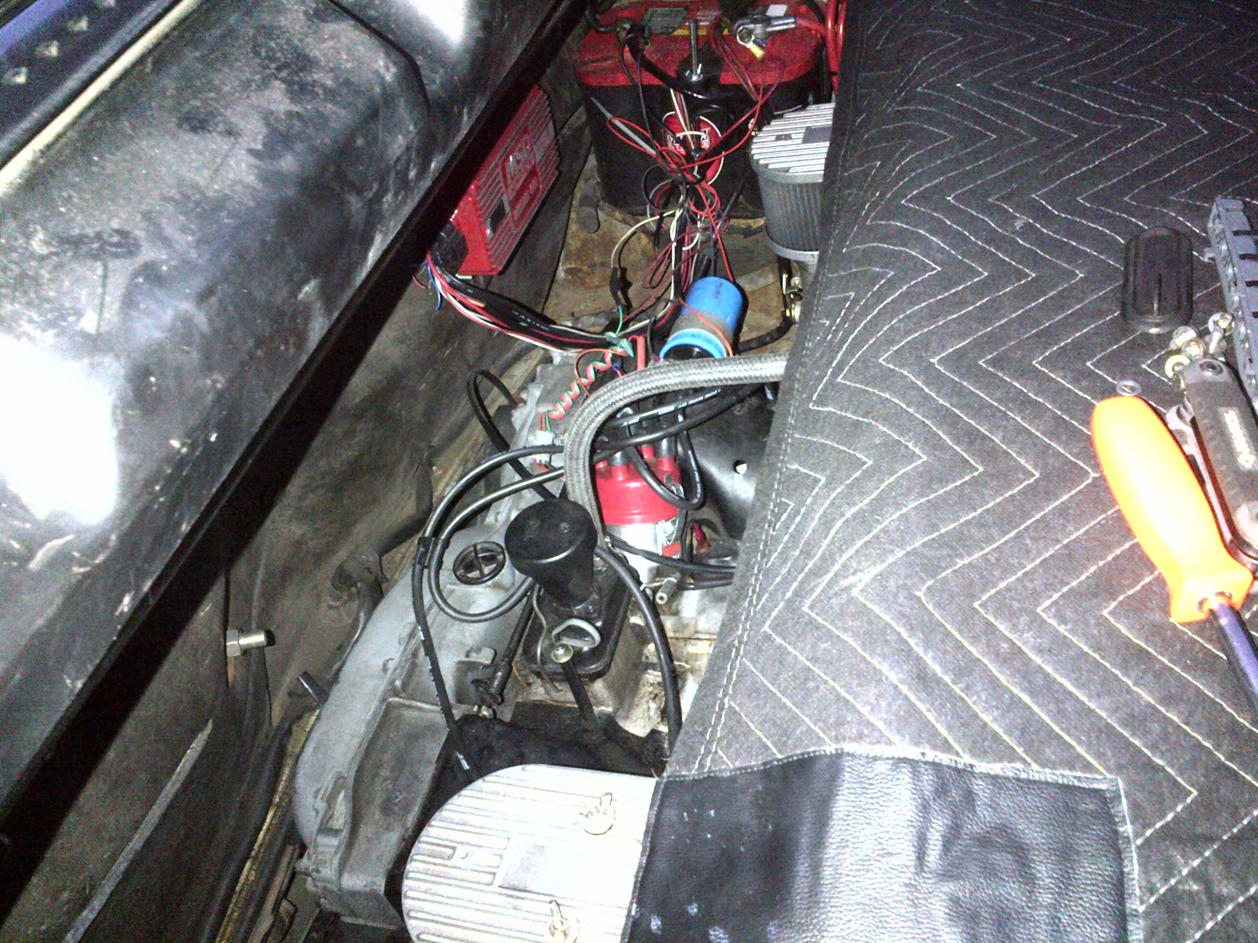

But my question is, what if any tin pieces am I missing in these pictures.

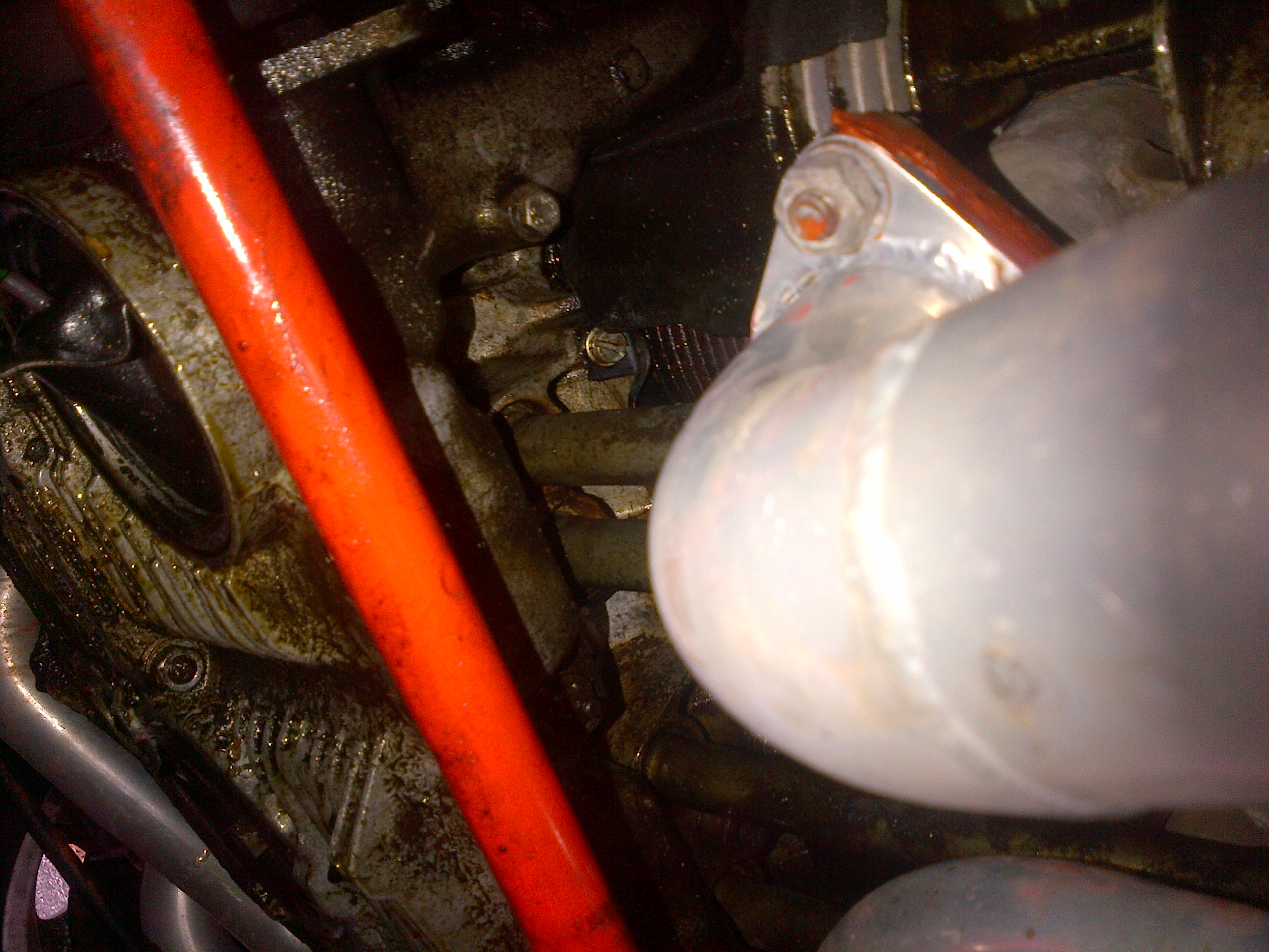

only one pic here and it is pretty tight
though that does look like a steel nut on your exhaust stud which I believe is not ideal.

the previous picture is where the thermostat and wheel go. If as I suspect I am missing a piece of tin what does it look like and where can I find it? I also think I may be missing some on the other side which this pic is of.
I have gotten some of the heater tins I need and have recieved some hoses from 914rubber and ordered the HE and modified parts from Tangerine.

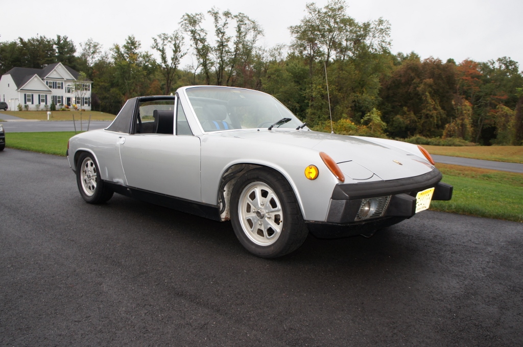

Attached are some pics of the car, the first night I got it the alternator belt kicked and had fun putting it back on. (IMG:style_emoticons/default/rolleyes.gif)

Looks like you have headers or at least not heat exchangers. Air guides (the tin pieces you got from Tangerine) may not fit unless you have HE's. Check the link to parts catalog in my signature for part diagrams

my guess is you are adding a tangerine heat exchanger.
http://www.tangerineracing.com/914headers.htm
I do not know how tangerine's interfaces with the cars stock system but I assume you will still need heat control boxes #8 and #9
http://www.autoatlanta.com/porsche-parts/h...;section=202-15
as far as engine cooling tin, see this link or type47's
the bellows and wheel you are talking about is for engine starts to get engine up to temp faster.

yes i have ordered the heat exchanger from tangerine along with modified parts to attach to the headers
I also have gotten the bellows thermostat and ordered the cable wheel which is missing.
will look at the links for the tins I think I am missing.
thanks guys

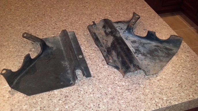

Looks like you are missing the "warm air guides". I think have a set if you want them cheap. PM me.

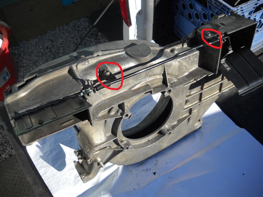

Little stuff I saw missing, the little metal pieces that hold down the cooling flaps.
(IMG:http://www.914world.com/bbs2/uploads_offsite/images.thesamba.com-11782-1386251779.1.jpg)
and the spark plug wire hold downs which plug the holes in the engine tin
(IMG:http://www.914world.com/bbs2/uploads_offsite/thumbs3.ebaystatic.com-11782-1386251779.2.jpg)
There's also a metal piece that holds one of those on the front of the breather tower, to hold the wires as they go across to the 3-4 side. You can kind of see it here
(IMG:http://www.914world.com/bbs2/uploads_offsite/images.thesamba.com-11782-1386251779.3.jpg)

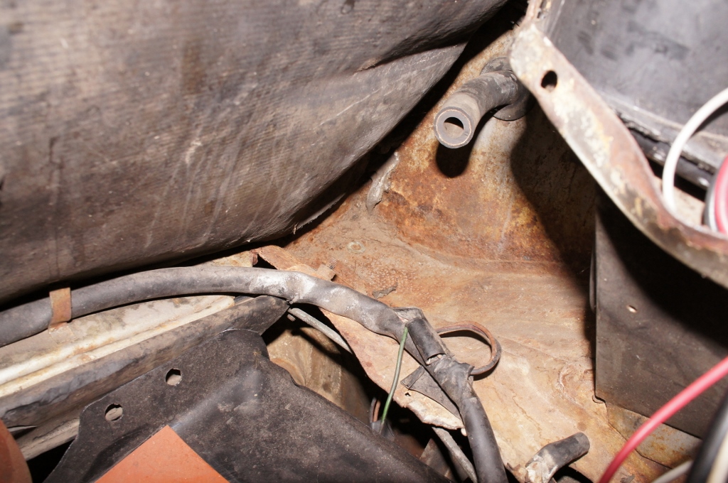

It looks in this pic like the passenger side engine seal is missing? along with the part of the engine shelf that holds it? I'm confused by the engine tin at the lower left here, too. It looks like the wrong piece there?
(IMG:http://www.914world.com/bbs2/uploads/post-2845-1381526957.jpg)
I was wondering what is the hose coming through the inner fender by the battery there?
I am guessing they go to the lines you can see in the front wheel well here. Any idea where those go? - I don't think they are stock.
(IMG:http://www.914world.com/bbs2/uploads/post-2845-1381526732.jpg)

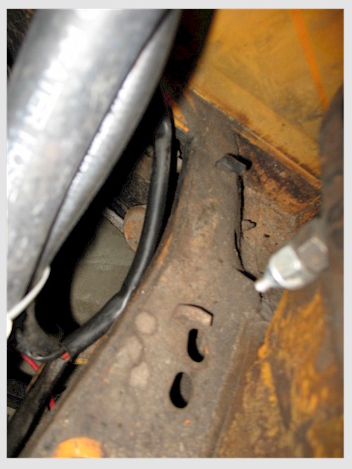

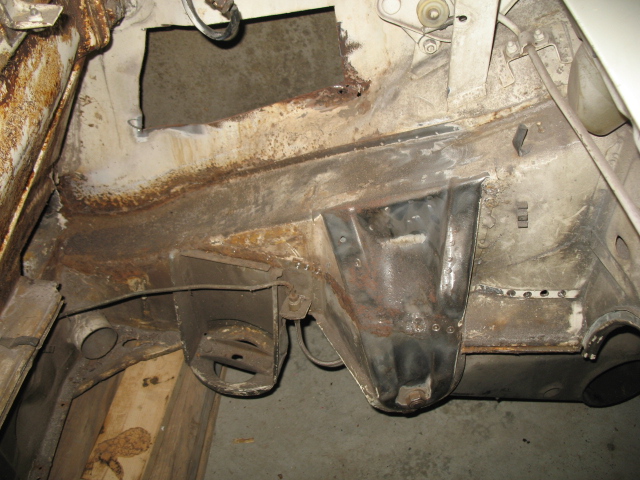

jimkelly
post Dec 5 2013, 08:17 AM
Delaware USA
Posts: 4,969
Joined: 5-August 04
From: Delaware, USA
Member No.: 2,460

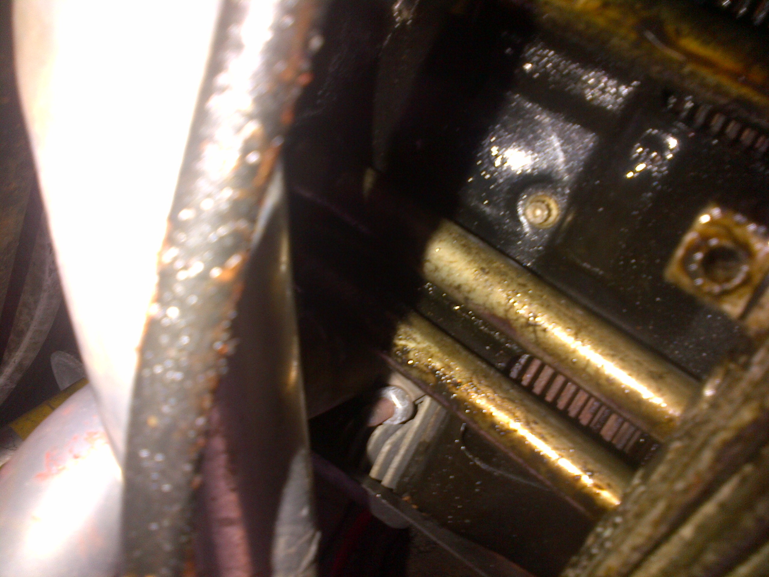

best pic I can get of pass long in engine bay
and one with all welded on engine cooling tin removed, you can really see the long within the engine bay in this pic.

nathonsnathon in an earlier life the car was an AC car so the hoses I believe were refigerent lines. They will go and the holes will get plugged later, maybe next year, maybe sooner.
I assume I can use 20 gauge metel to make the little pieces for holding the flaps down. I will try pelican or a type 4 vw store for the wire holders.

Oh yeah, I forgot about the AC. I think they butcher the engine tin and the shelf to install that at the dealer. The odd tin is probably a patch. The engine compartment should ideally be sealed so hot exhaust doesn't come up and make it run hot.
The bolt for the thermostat pulley is special and has a larger shoulder.
The stock flap hold-downs are like hardened or spring steel. You might want to use heavier than 20 gauge as the spring is pretty strong there on the one.

the special bolt makes sense; will have to try an aluminum bushing as the original bolt is missing. 1/8 steel should work for the hold down for now.

ericoneal
post Dec 5 2013, 09:31 PM
Posts: 327
Joined: 13-August 12
From: Crestwood, KY
Member No.: 14,795
QUOTE(ericoneal @ Dec 4 2013, 10:21 PM) *
I think these may be what you need, but you will want to confirm with others here.
Will PM you paypal info

looks like you need to find and fix some oil leakage... (IMG:style_emoticons/default/sad.gif)

The factory used steel exhaust nuts, albeit Helicoiled. What would you have him use? Brass? Aluminum? Those POS "copper" lock nuts (which are actually copper plated steel with a self locking device to make them lock tho the stud and impossible to torque properly).

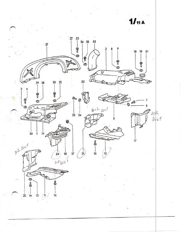

Ericoneal those look like parts 11 and 12 from the exploded view I got from Bowsly and am sure I need, I think I may also need parts 17,20,21 and 24 they are all called air ducts. was going to scan it in but the scanner wont scan (IMG:style_emoticons/default/sad.gif) will have to look closer tonight about the other parts.
Mike yeah, I got the adaptor and dual oil pressure sender and plan on installing that, I think I have seen on here where sometimes that is the source and also plan on replacing the gasket under the "tower" (? might be the wrong term). But I figure at some time I may need to get into it more then I want to right now. (IMG:style_emoticons/default/unsure.gif)

Got the scanner working. I circled the pieces I think I need.Attached Image
Will have to crawl under and look closer when I put the t-stat bellows and cable roller in.
