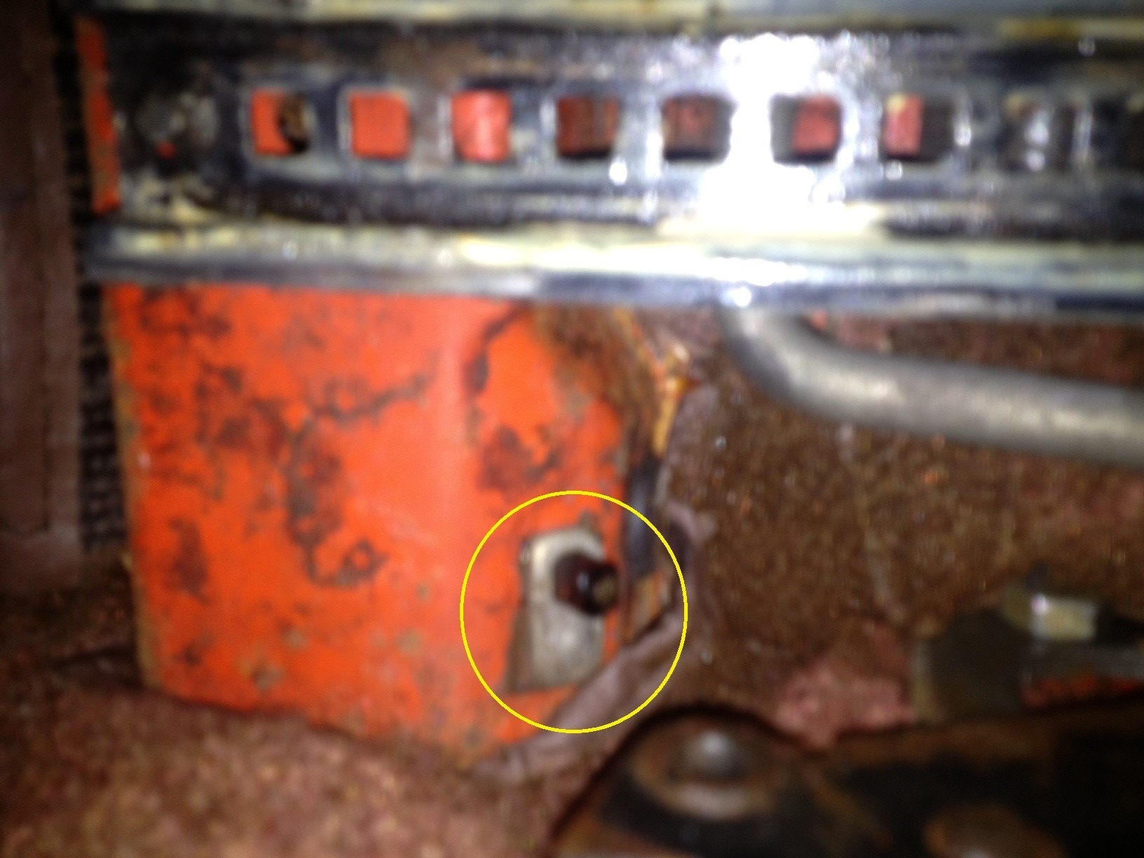

Do you know where the handbrake contact is located on the car?

little button just under the front of the handle mounted in the body cross bar in front of the seat. . same switch as the door contact switch.

Uhh...I don't think it's there. Where is it now?

This pic (bad focus) shows the push button switch. Pic is taken while kneeling outside the driver door - seat is removed and the seat rail is at the top of the pic. Part of the e-brake is seen at the bottom of the pic, seat crossbar is to the left.

Its on the floorpan?

It's just above the floor pan, on the crossmember that goes across the body of the car under the front edge of the seat.
I'd double-check that before removing or disassembling your brake system...
