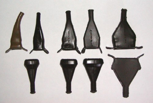

The injector connectors (as well as all of the other electrical connectors in the engine bay) have/had rubber boots that stretch and pull over the body of the device connection(s) to keep them secured and somewhat water tight.
Replacement boots are as rare as hen's teeth, but do show up from time to time. If you run across some decent ones in a bone-yard car, grab 'em. The best method is to remove the pins from the connector bodies and pull the boots off the wire. This will help to keep you from destroying the boots in the process (IMG:style_emoticons/default/shades.gif)
