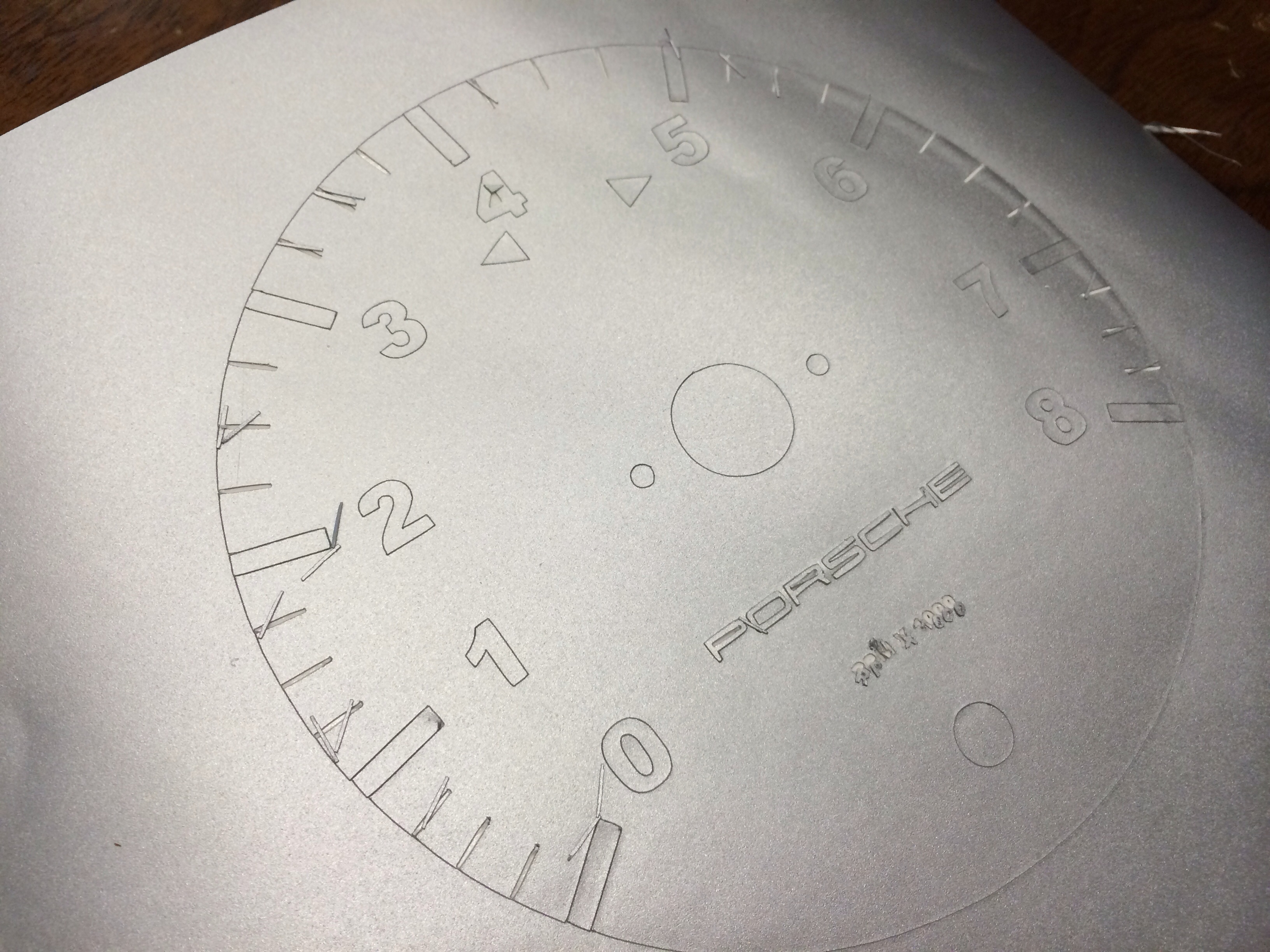

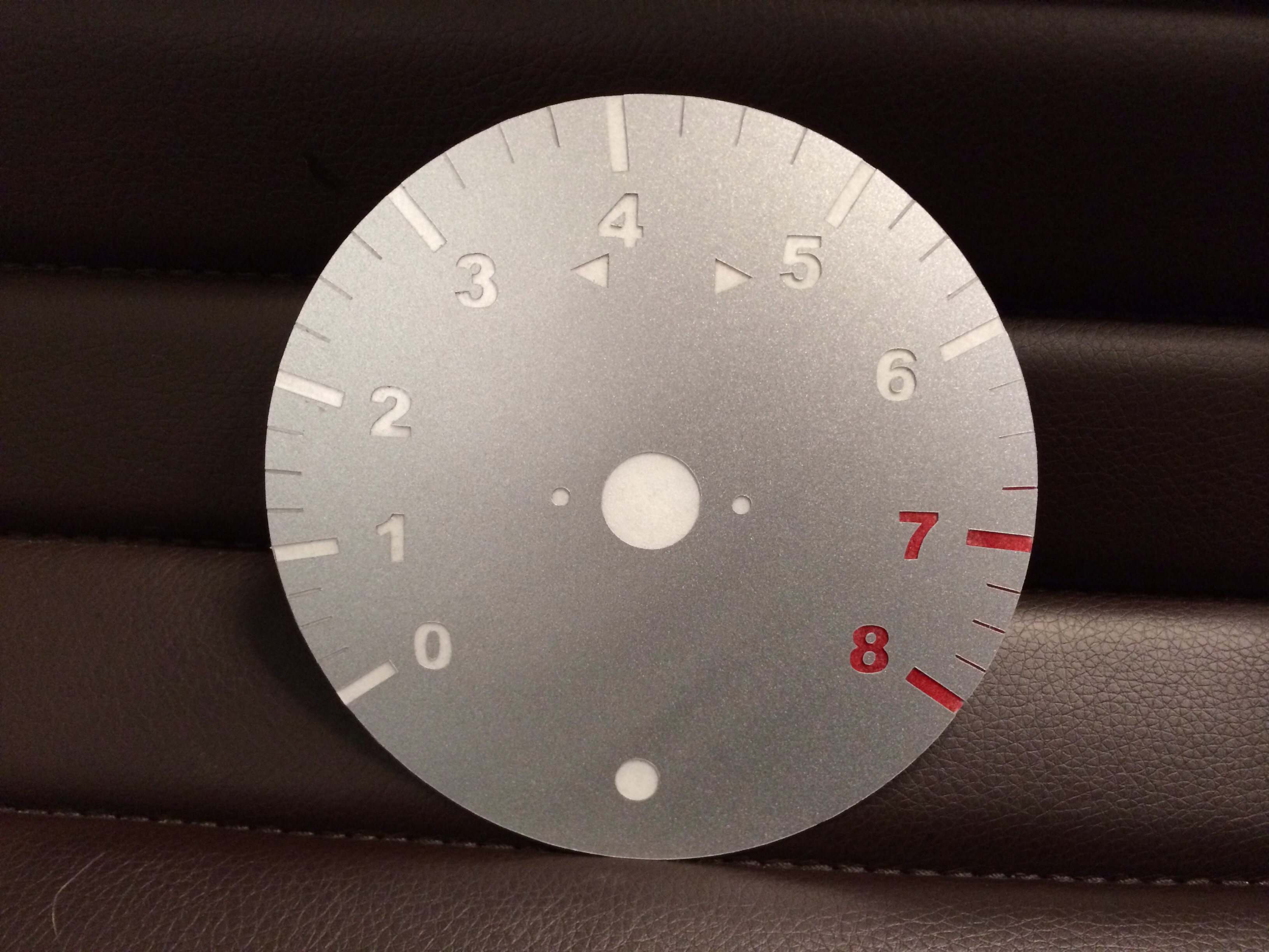

First step was making the gauge template. This is JUST A TEST so I wasn't going for scale.
CptTripps
post Dec 12 2013, 12:16 PM
:: Punch and Pie ::
Posts: 3,585
Joined: 26-December 04
Member No.: 3,342
Then I transferred it to my Vinyl Cutting program and loaded it up.
CptTripps
post Dec 12 2013, 12:17 PM
:: Punch and Pie ::
Posts: 3,585
Member No.: 3,342
Cut it on Silver vinyl. Not the best vinyl, but worked for the test.
CptTripps
post Dec 12 2013, 12:18 PM
:: Punch and Pie ::
Posts: 3,585
Member No.: 3,342

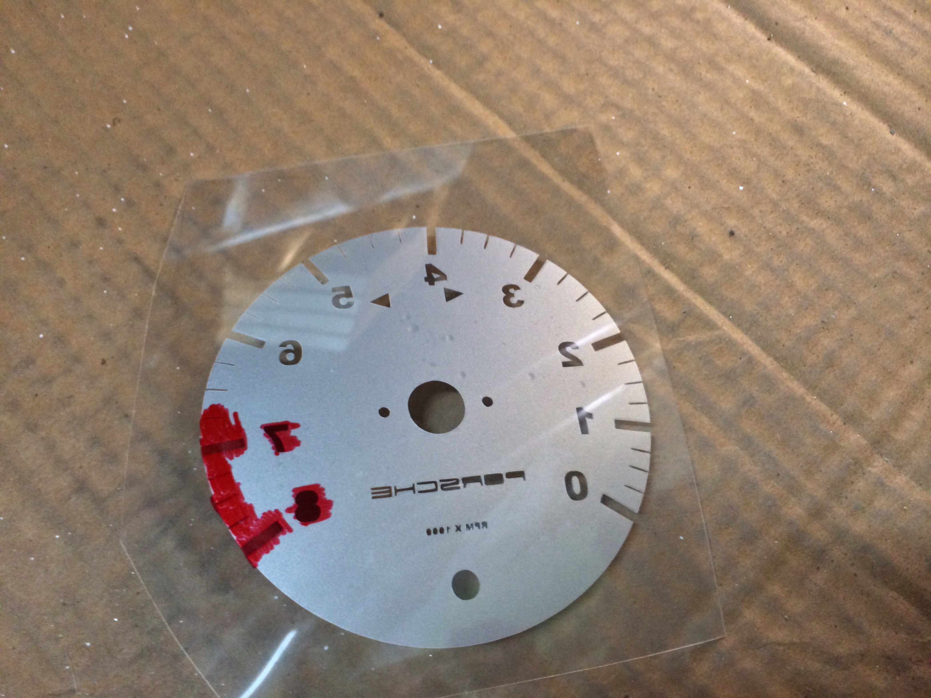

Next I transferred it to some thick-ish Lexan.
CptTripps
post Dec 12 2013, 12:20 PM
:: Punch and Pie ::
Posts: 3,585
Member No.: 3,342
Using my "RC Car Body" skills, I hit the redline with a sharpie real quick before the backing.
CptTripps
post Dec 12 2013, 12:21 PM
:: Punch and Pie ::
Posts: 3,585
Member No.: 3,342

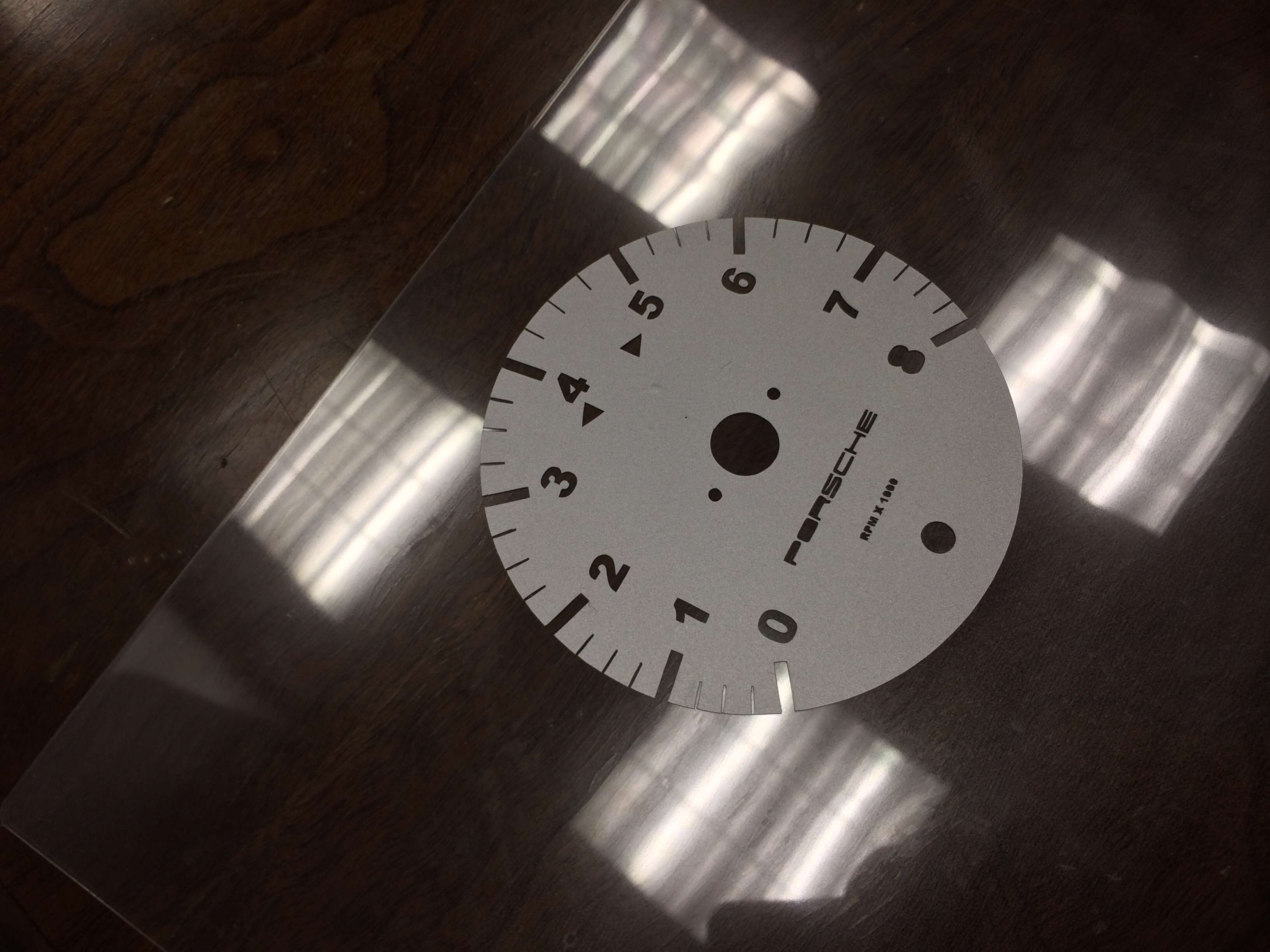

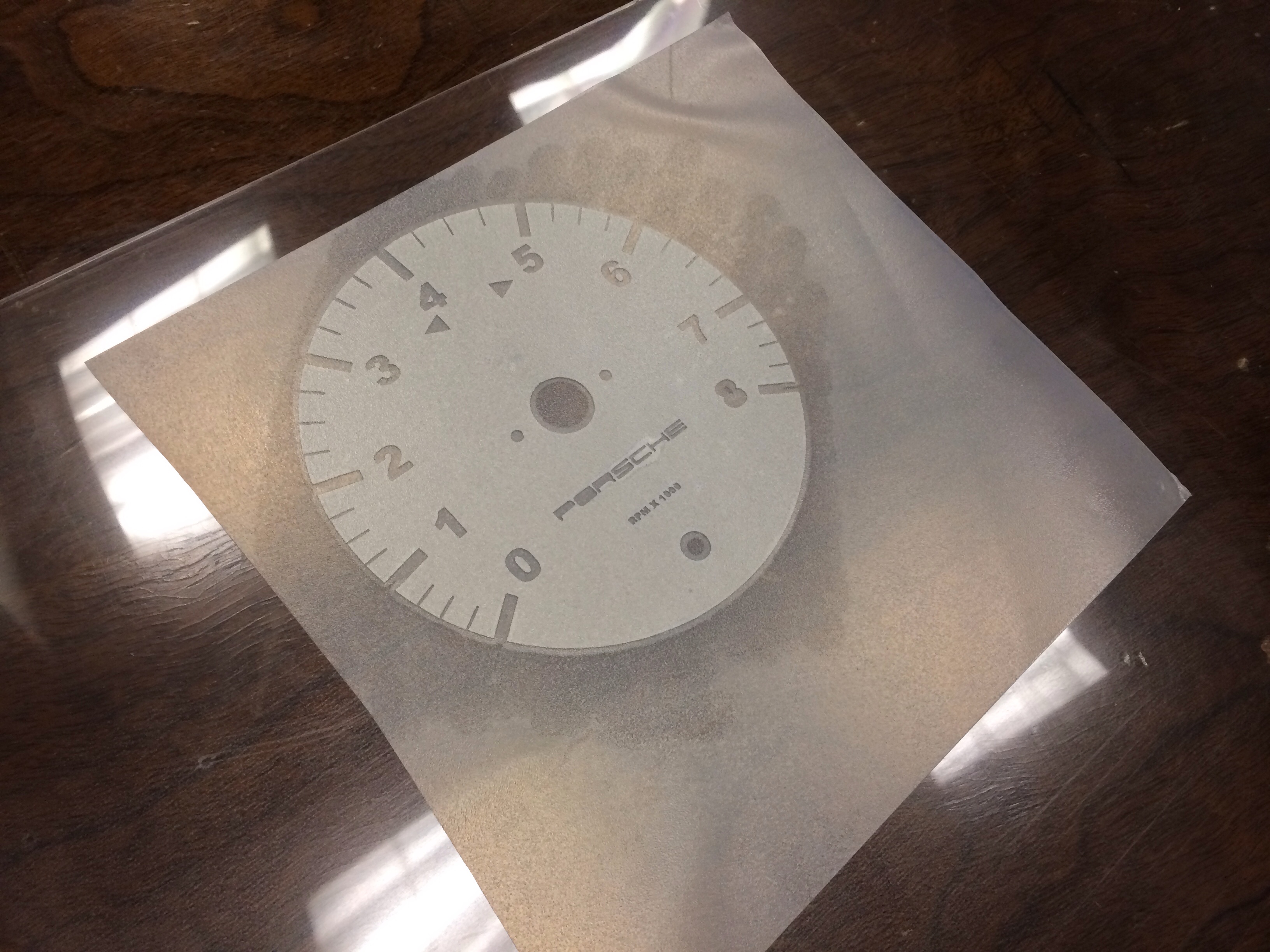

Next I painted over the back with a quick coat of white primer. I'll use proper Lexan paint later, but this would give me an idea.
CptTripps
post Dec 12 2013, 12:24 PM
:: Punch and Pie ::
Posts: 3,585
Member No.: 3,342

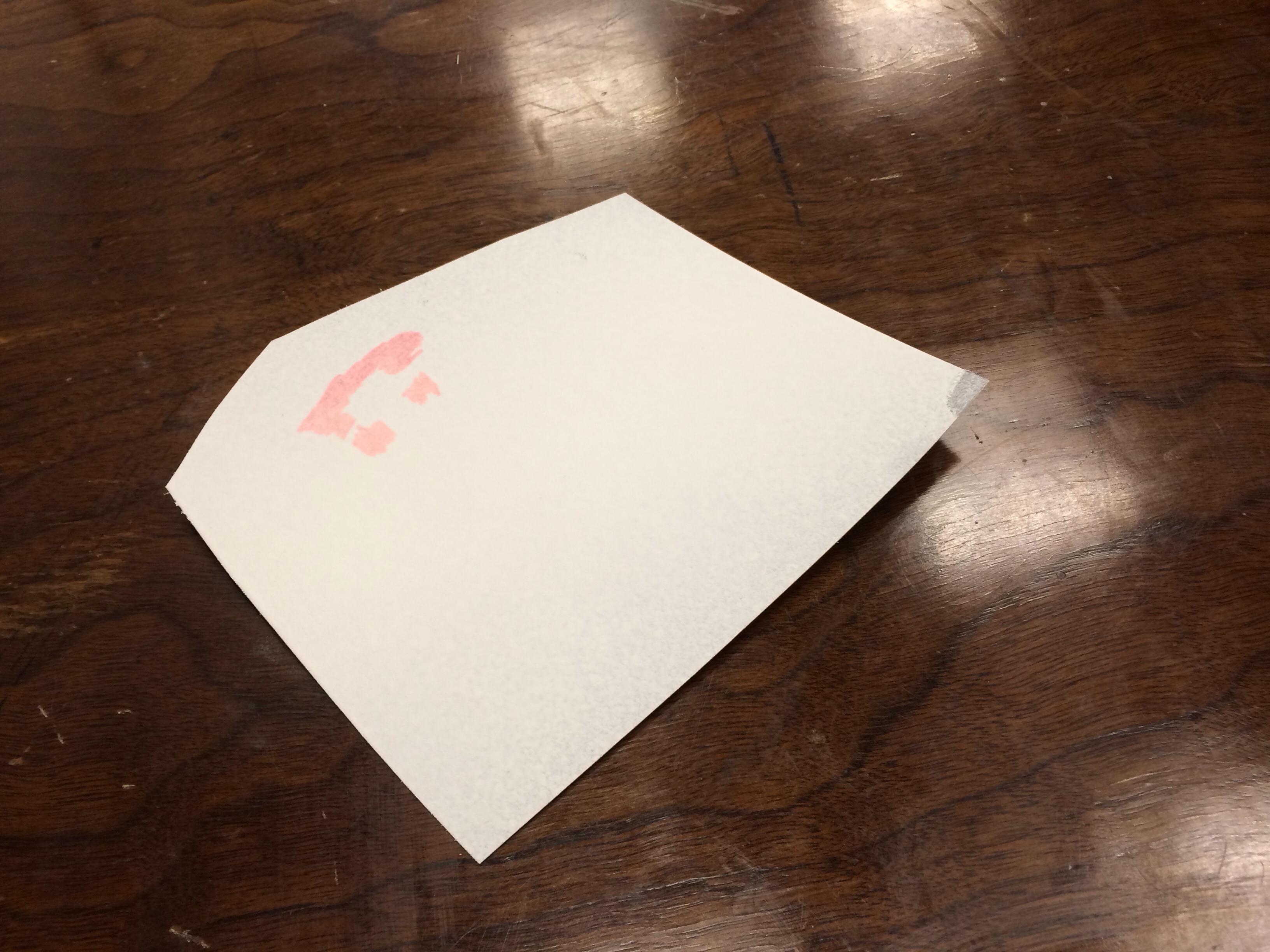

Viola! After a second coat, I'm getting an idea of how it'll look.
I'm going to let it dry a little more and then cut it out. I can already tell that the red sharpie isn't going to cut it. I have some red vinyl that I'll eventually use on the back before paint. That should do the trick a little better.

I'm going to have to get rid of the bubbles before I put it through the laminator again. (Just a thought...it may not work at all.)
So...at the end of the day, I think it was worth 30min of time to see if I had a viable plan or not.
Some things I learned:
1: The lettering is a little TOO thin to do reverses on the PORSCHE and the RPM piece. Perhaps I'll do those in black vinyl and apply after the fact.
2: I need to pull the centers for the 4, 6, 8 so I can apply them afterwards. No biggie there.
3: Maybe a little thicker plastic with an additional black backer that's the reverse. That'll help focus the light on the numbers and I won't have any bleed for the light hitting the silver vinyl.
I'm going to thicken up the middle-ticks so they are a LITTLE thicker.
That's all I got for now...what do you think?

I just trimmed this one. Came out pretty bad, but now I know what I need to do. You never learn until you try!

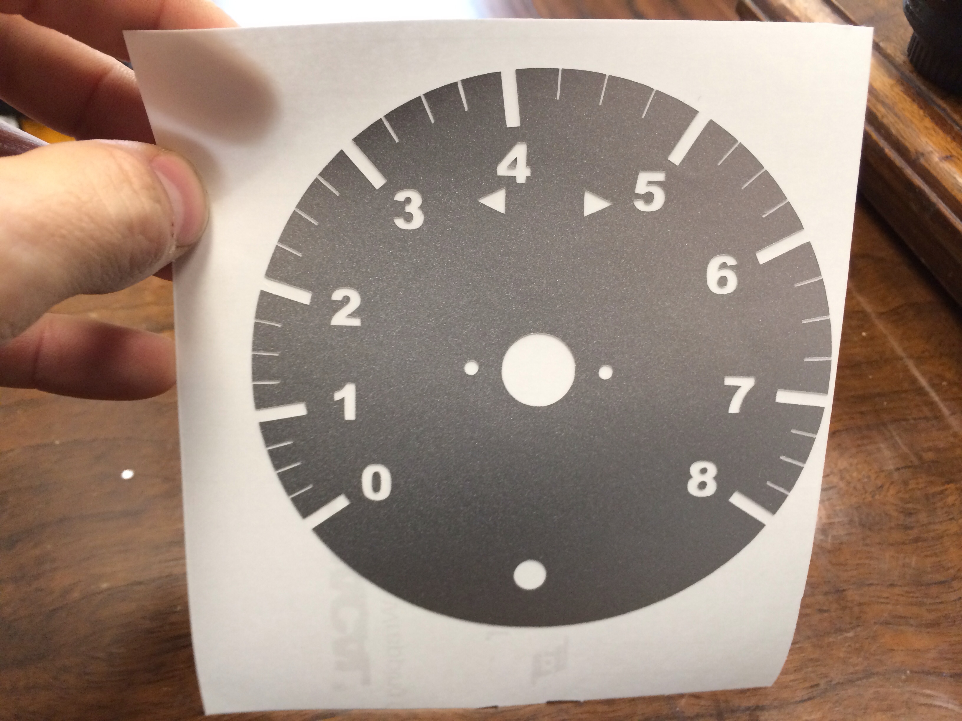

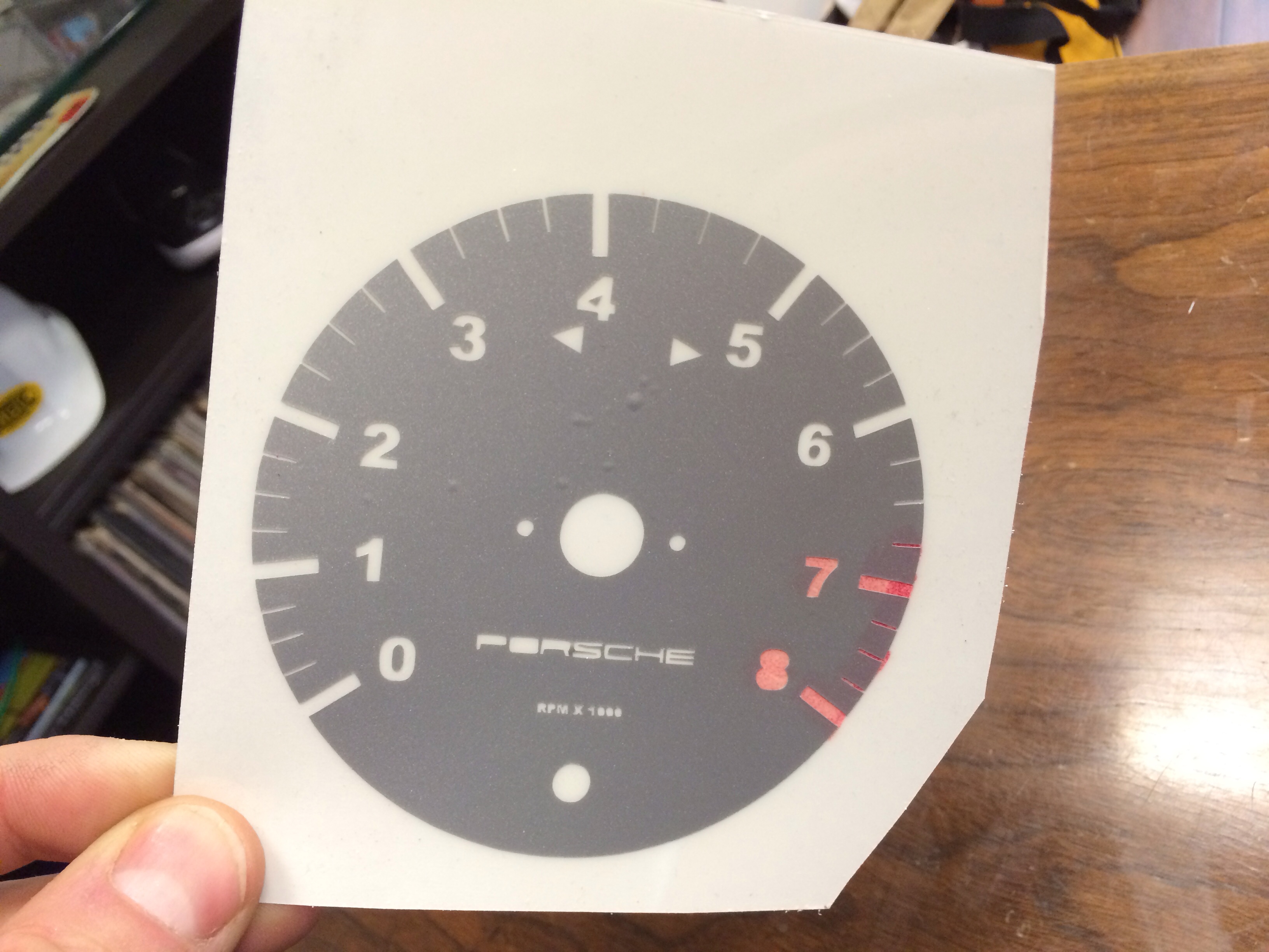

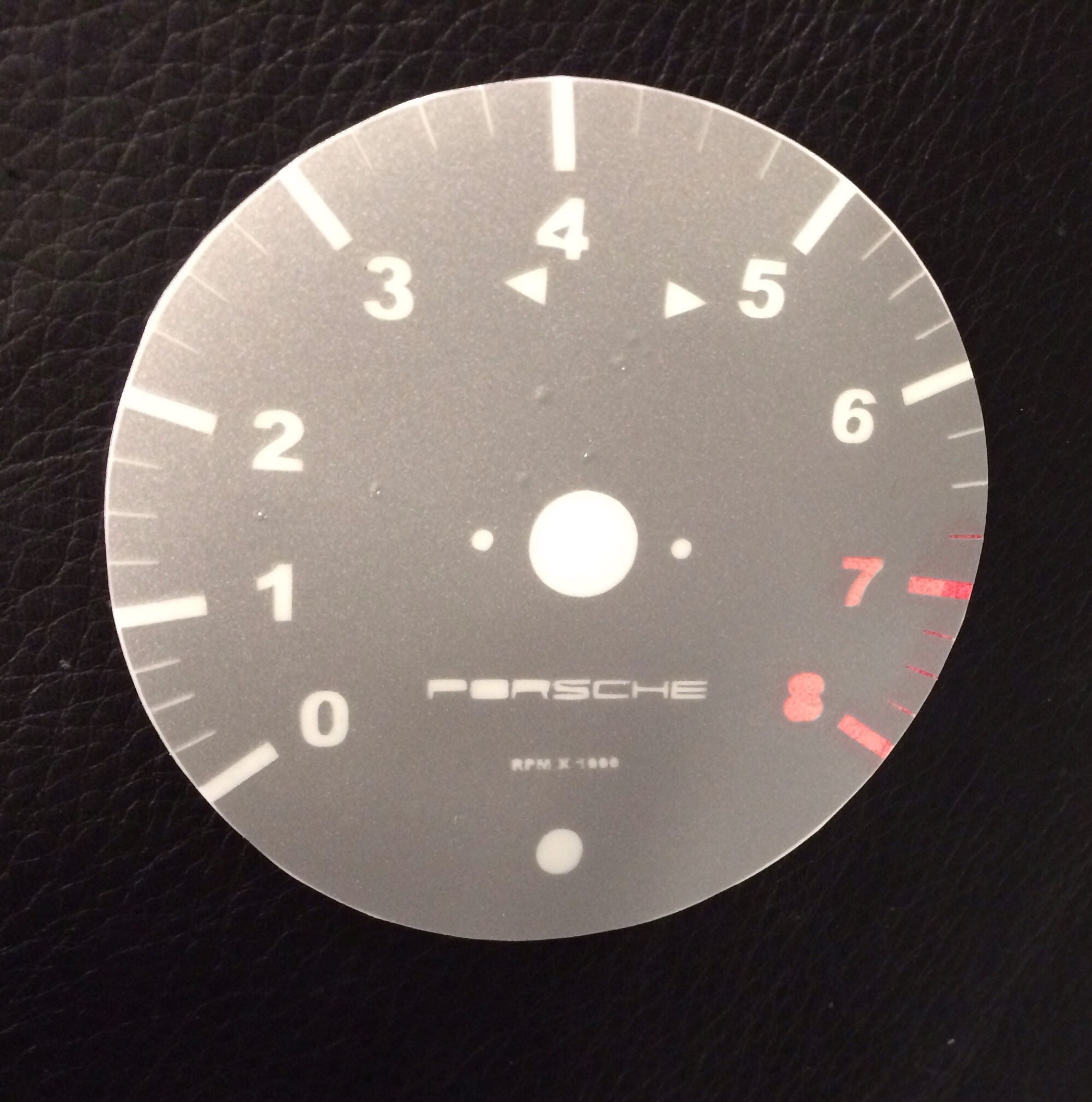

Attempt #2: Much better.
Used a thicker vinyl and thin white plastic backing. Light comes through evenly and the red was a lot easier too.
Dave_Darling
post Dec 13 2013, 10:54 AM
914 Idiot
Posts: 15,335
Joined: 9-January 03
Member No.: 121
The minor ticks still need to be fatter. Especially the red ones; the darker color (red vs. white) will look thinner so you need to thicken it up a bit to compensate.
