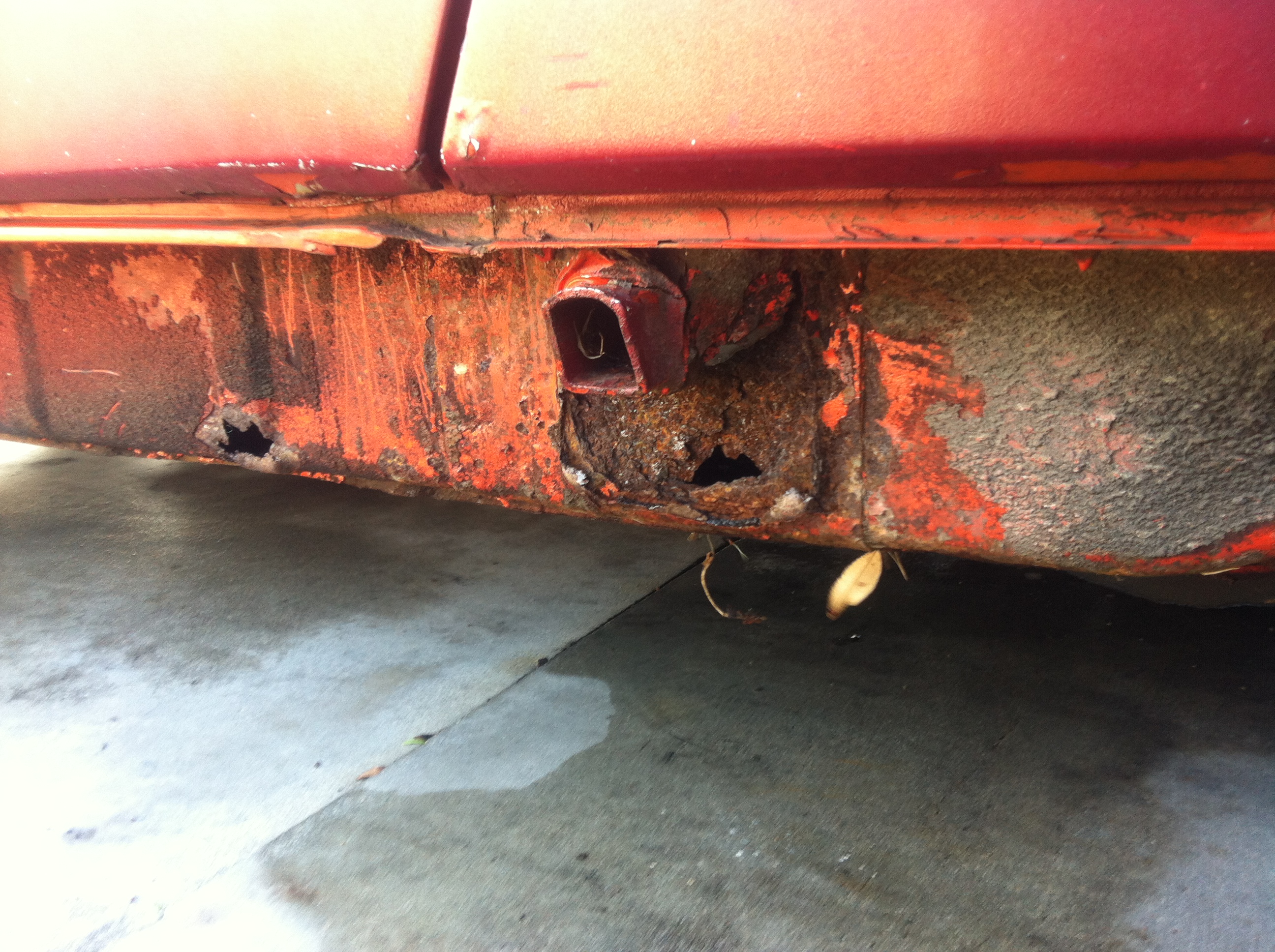

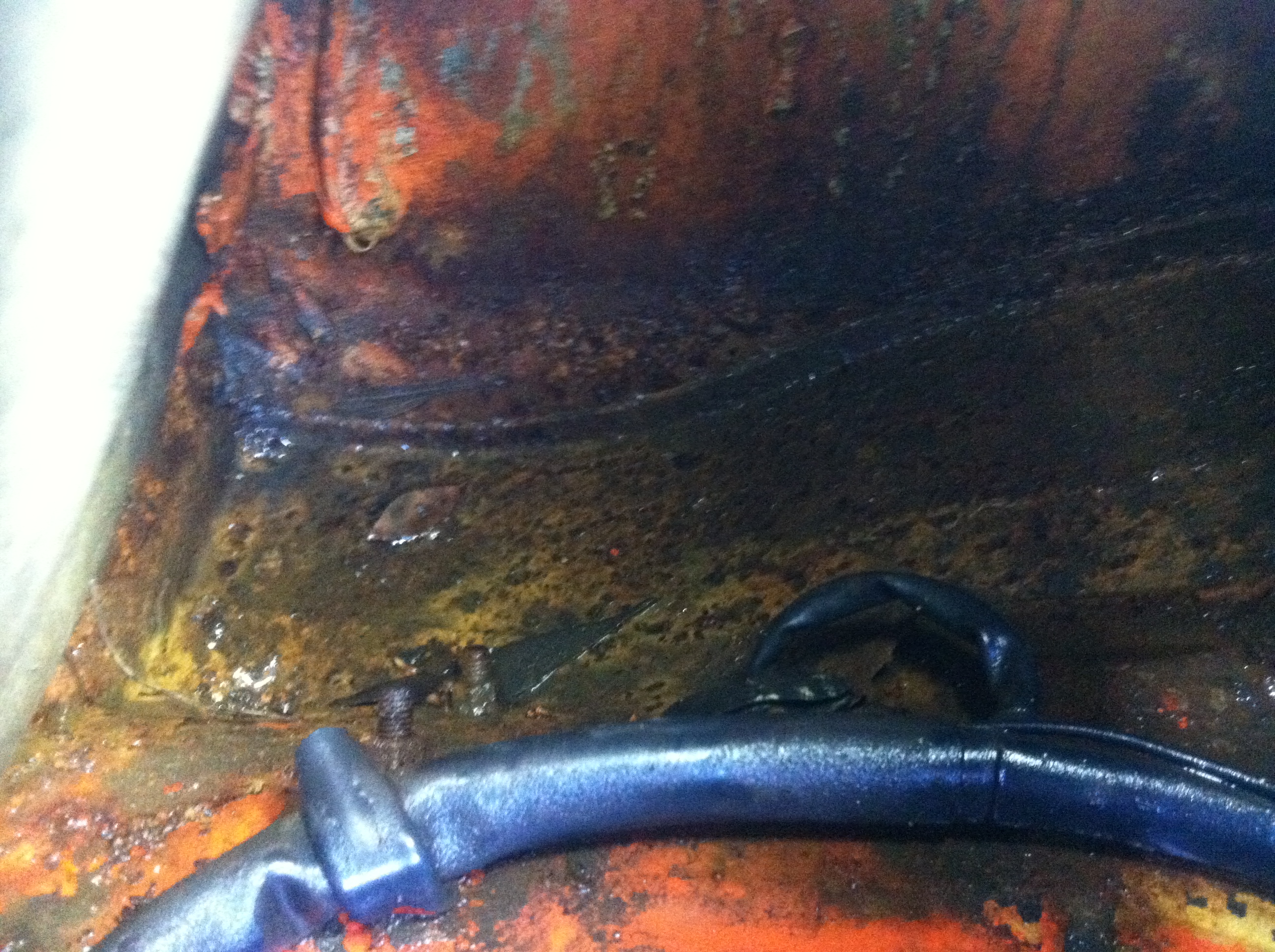

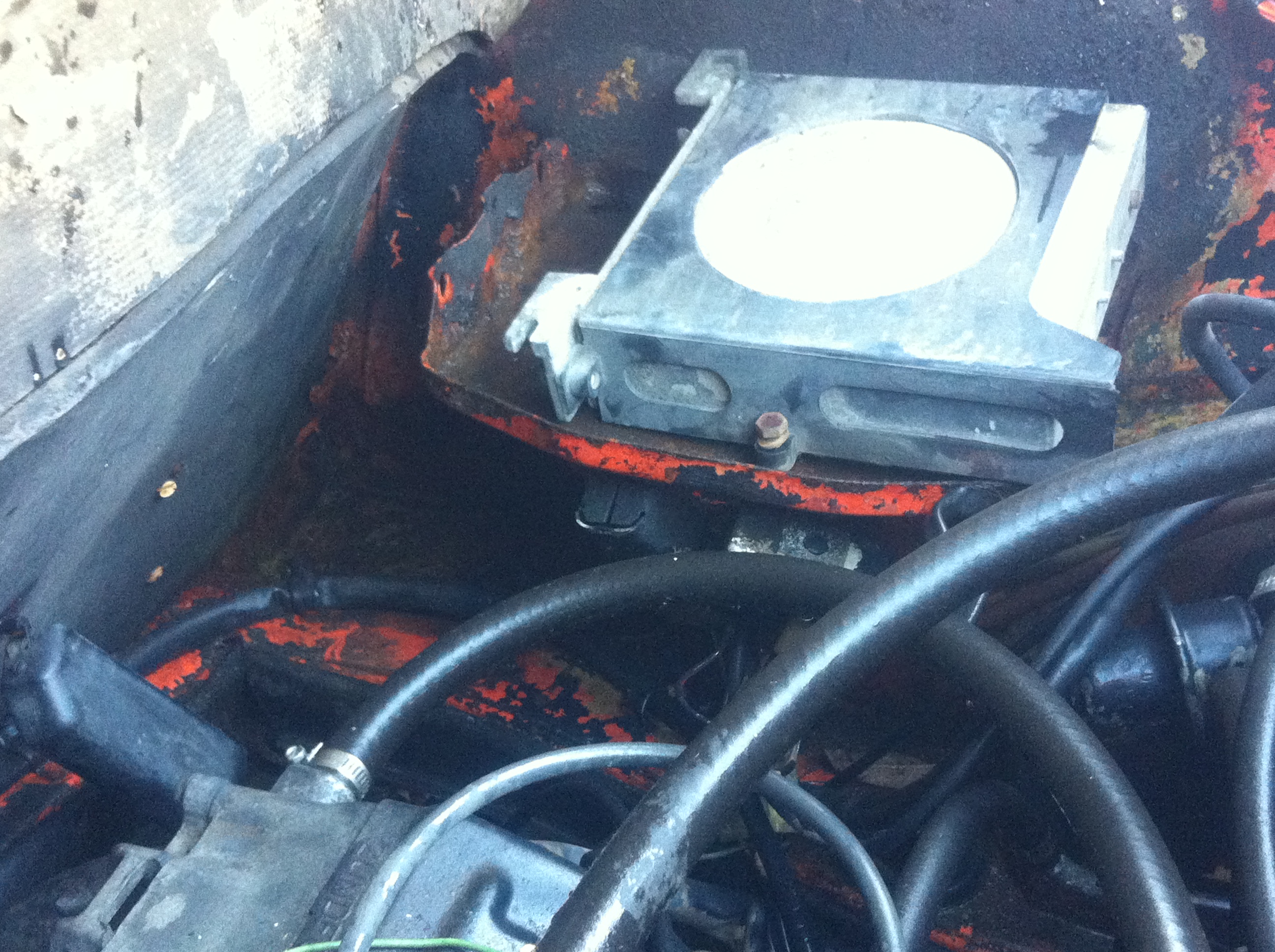

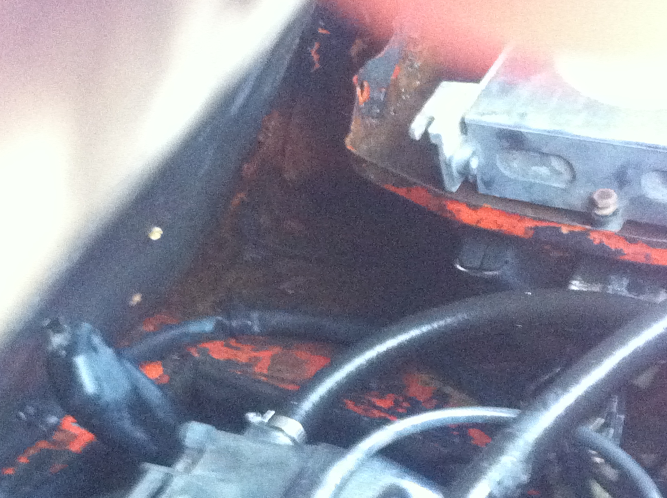

Update:
I removed the ECU attached to the battery tray to be able to see the hell hole.
Unclogged the dirt stock on the drain hole with dirt and flow a hose of water to drain all debris in this mini pool (hehehe).

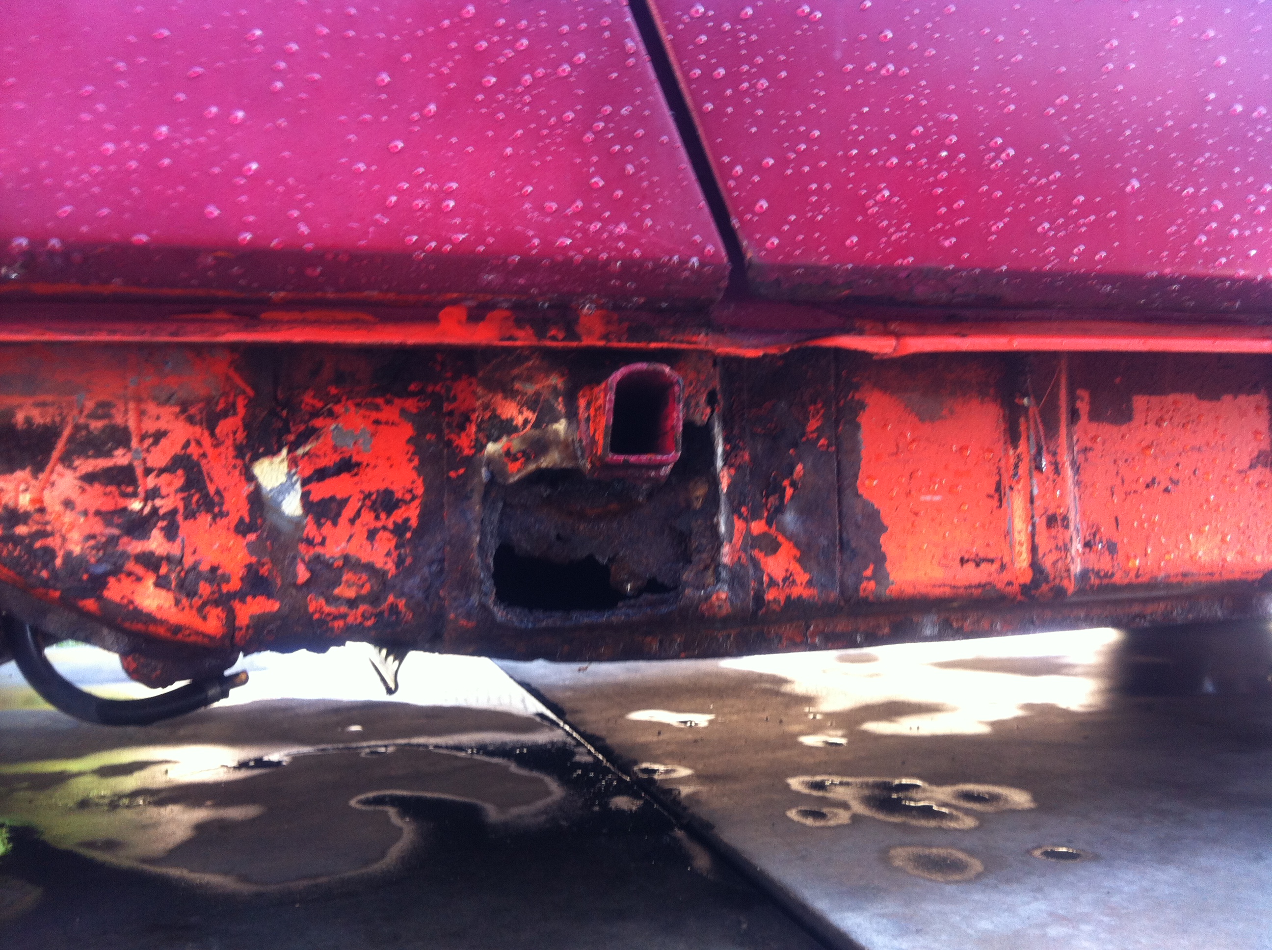

passenger side

Hey! See, there you go, that's good news! The other stuff is a piece of cake compared to the hell hole. May consider redoing the very top portion of the hell hole anyway, depending on how pitted it is.
Also, check out the suspension consoles for signs of rust in and around the ear.

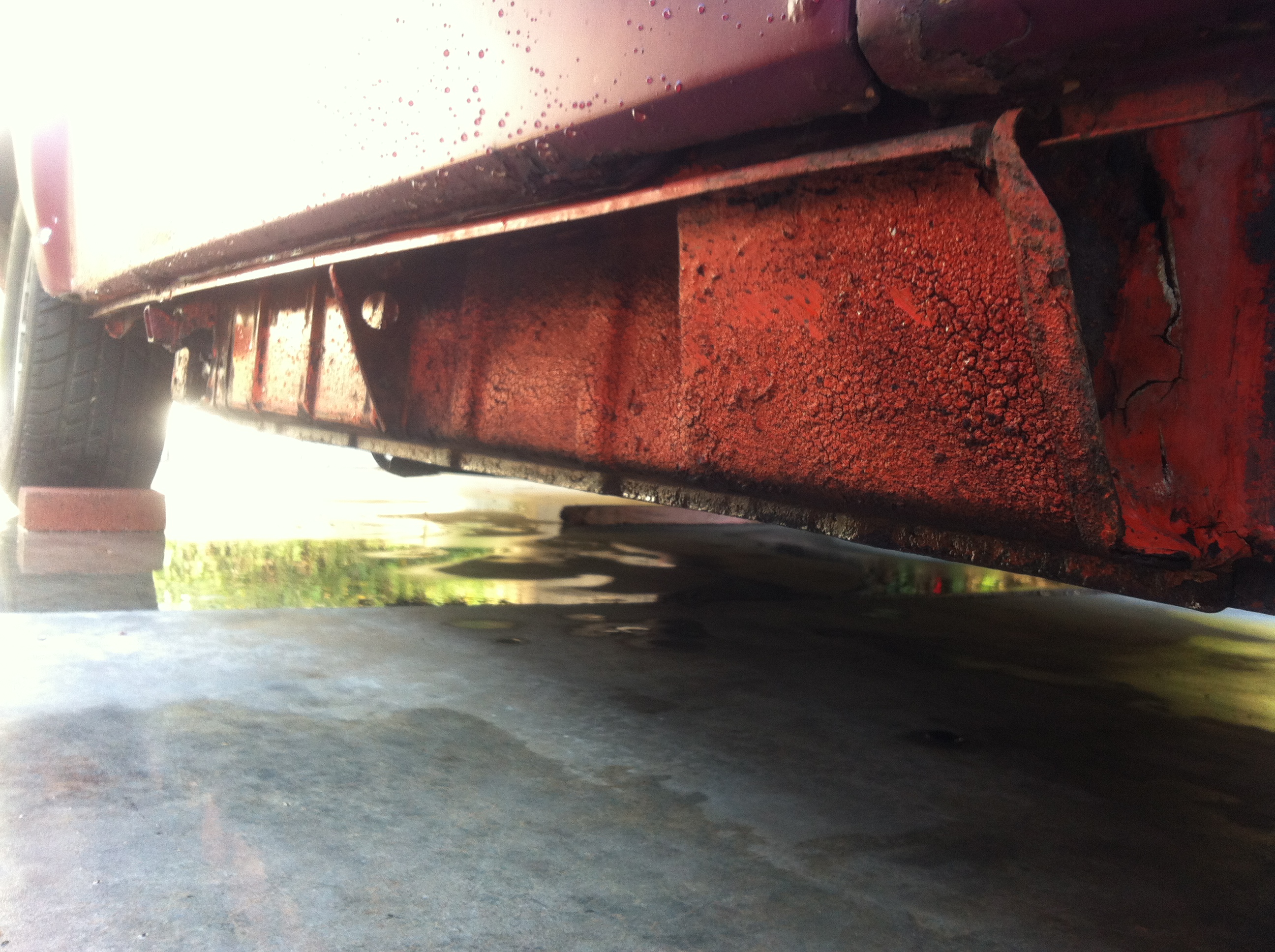

passenger side
driver side

My 73 had the typical jack point rut. Repair was tipping the car 45 degrees to weld the back of the jack points.
I agree on the hell hole. Grind or blast to get a better idea of the needed repairs.

where ever a car is from, crap collecting around the jack post is going to screw things up. how big of a pile gunk was behind the rocker cover?
