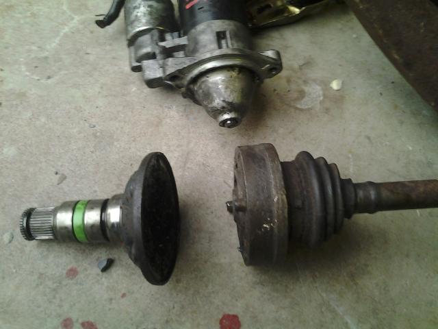

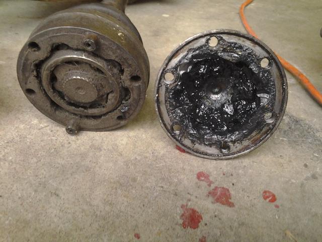

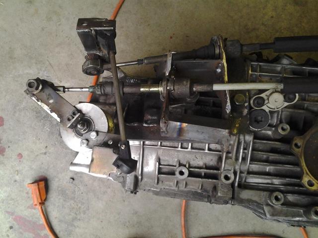

QUOTE(championgt1 @ Nov 26 2013, 10:29 AM) *
I'm still working on the car. Just this weekend i pulled the axle stubs off a passat, cost me only $10, here they are next to a 911 cv 100mm
(IMG:http://www.914world.com/bbs2/uploads_offsite/i106.photobucket.com-1888-1388531099.1.jpg)
(IMG:http://www.914world.com/bbs2/uploads_offsite/i106.photobucket.com-1888-1388531100.2.jpg)
also I built a rough cable shifter out of boxster shift cables and some old mk3 vw linkage
(IMG:http://www.914world.com/bbs2/uploads_offsite/i106.photobucket.com-1888-1388531100.3.jpg)
I grabbed the flywheel, clutch pressure plate, and stater off that passat, It cost me only $60. I've been waiting years for a passat or audi manual 1.8t to come into the pick a part, so I'll be putting it all together at last.
