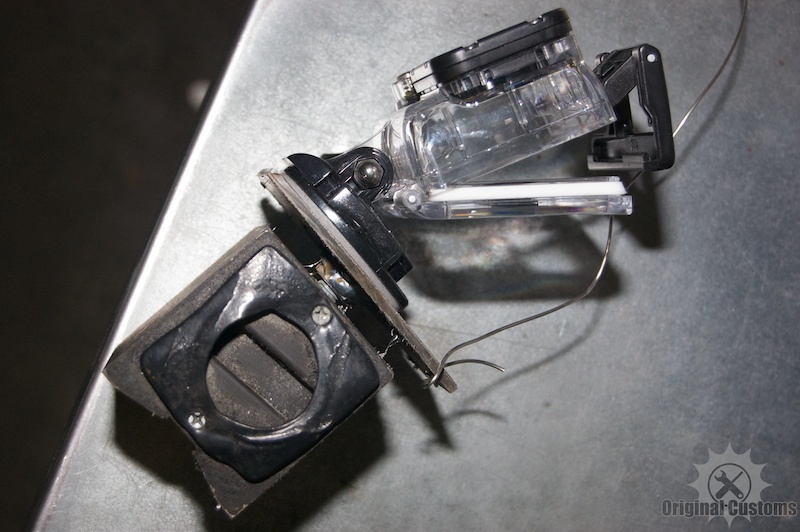

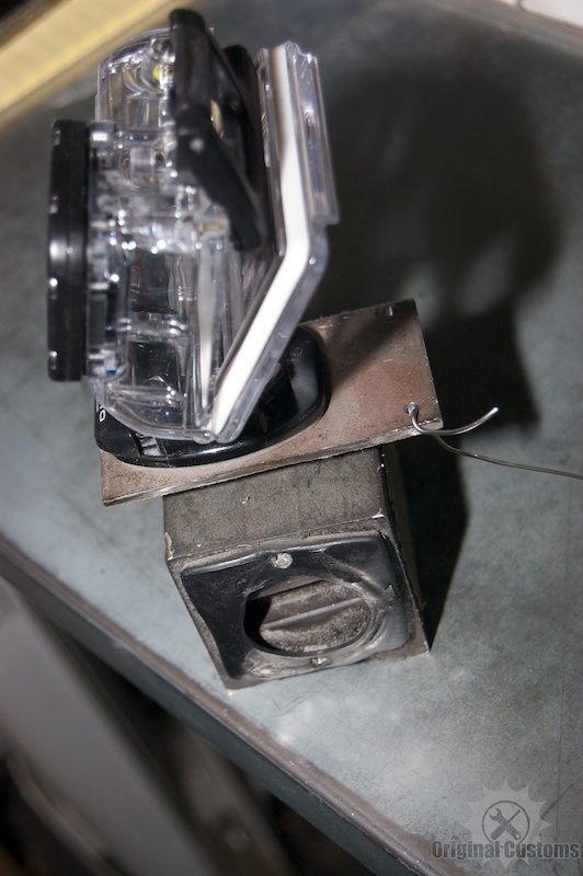

The GoPro was mounted on a strong magnet. Mine came from a dial indicator setup. The base portion has a M8x1.25 thread. So I welded a small bolt to the bottom of a plate and threaded that in place. Then used one of the GoPro stick on mounts. I also drilled the plate for a backup safety wire so I wouldn't see the GoPro bouncing into the gutter out the rearview mirror.
For this video I just stuck the magnet to my muffler, and under acceleration it just shifted backwards until it hit the raised edge.

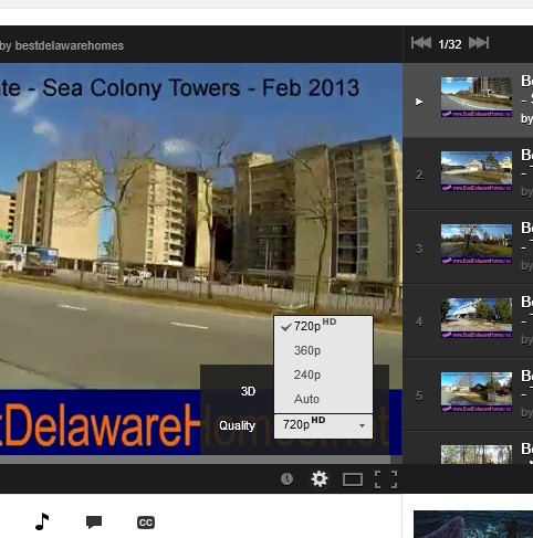

seems like my computer has recently begun to limit youtube res at 720p. odd?
seems like a known problem, I see.
http://www.networkedmediatank.com/showthread.php?tid=68728
