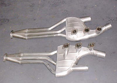

I've been told the the B&B fit like (IMG:style_emoticons/default/stromberg.gif) and throw less heat than a pile of (IMG:style_emoticons/default/stromberg.gif)
What's you budget like?...or how bad do you want heat?
http://www.haywardandscott.com/porsche/914...exchangers.html
(IMG:http://www.914world.com/bbs2/uploads_offsite/www.haywardandscott.com-26-1392180211.1.jpg)

That would put the H&S heat exchangers at about $2500, which is way outside of any budget I would have. I believe that I can purchase Bursch headers for around $700. So, I was looking for someone that could fabricate heater boxes and infall them on the Bursch headers. I guess there is not enough demand to have anyone tool up for such a product.
