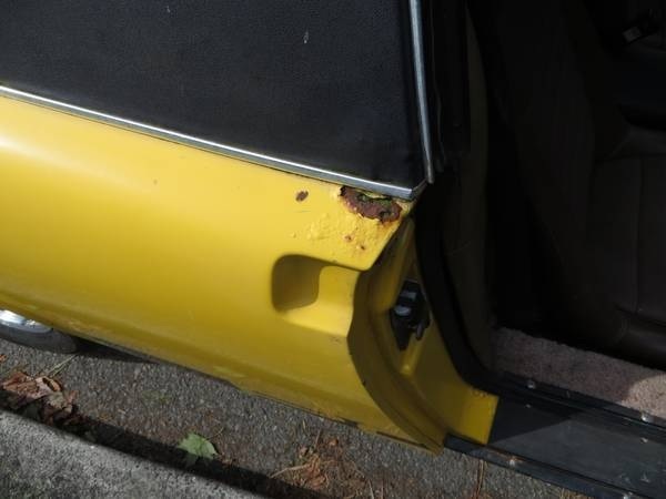

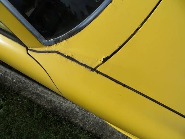

I haven't seen this car in person but the body has some rust. The "hell hole" has been repaired. But I haven't done body work before. I'm a decent mechanic but have never done body work. (although I have drywalled the basement).
Looking over the forum, I know there are other areas to look for rust, but how difficult is this to repair?
Thanks for any help you can give

partwerks   I have a small rust spot on the passenger side als...   Feb 10 2014, 09:36 PM
Ferg   Based just on those two pics, if u can't weld ...   Feb 10 2014, 09:57 PM
Mike Bellis   I've seen better cars that were free... :(   Feb 10 2014, 10:18 PM
KELTY360   It's an iceberg.   Feb 10 2014, 11:36 PM

somd914   Looks like you have rust at the lower end of the d...   Feb 11 2014, 04:56 AM

Chris H.   Yep this is the clincher right here... It...   Feb 11 2014, 07:24 AM
ClayPerrine   Yep this is the clincher right here... It...   Feb 11 2014, 10:24 AM
76-914   This would be a much better start with a little ru...   Feb 11 2014, 09:58 AM
Chris H.   Oh I'm aware it's common for a 914 to rust...   Feb 11 2014, 10:40 AM
rdauenhauer   BTW that's not so much "foam" like t...   Feb 11 2014, 11:04 AM

ClayPerrine   One suggestion... show up with an ice pick and pok...   Feb 11 2014, 01:09 PM
rdauenhauer   :agree: Best option would be to remove the rocker...   Feb 11 2014, 01:33 PM
