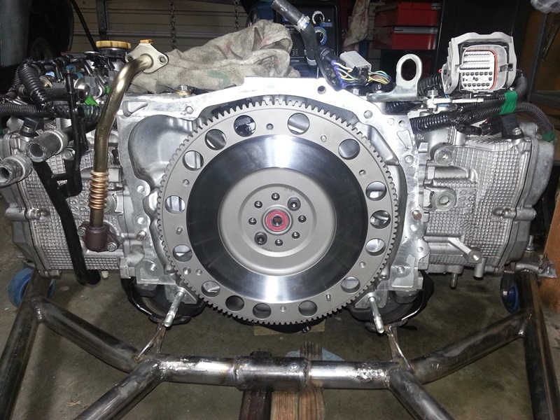

I just got an Exedy set-up and am waiting for some flywheel bolts to install. My kit came with a lightened flywheel that is supposed to be something like 14lbs so it's not the stock, but I can weigh the whole set-up (clutch disc + flywheel + pressure plate) when I get home tonight. I'm not super excited about the lightened flywheel, but the price was right at the time. Down the road I may be replacing it with the stock single-mass flywheel...only time will tell.

Ok Just weighed everything, but keep in mind that my scale isn't all that accurate:
Flywheel: 12.6 lbs (This is a lightweight one!)
Clutch disc: 3.4 lbs
Pressure plate: 11.1 lbs
Total: 27.1 lbs
I think I read somewhere that the stock flywheel weight for the '02 WRX is something like 22 lbs. So, if you keep everything stock just add 10 Lbs to the total weight above. I figured I'd throw in a gratuitous picture of my shiny new flywheel below. Got the bolts today from the dealer and will be getting everything installed and torqued down tomorrow! (IMG:style_emoticons/default/aktion035.gif)
