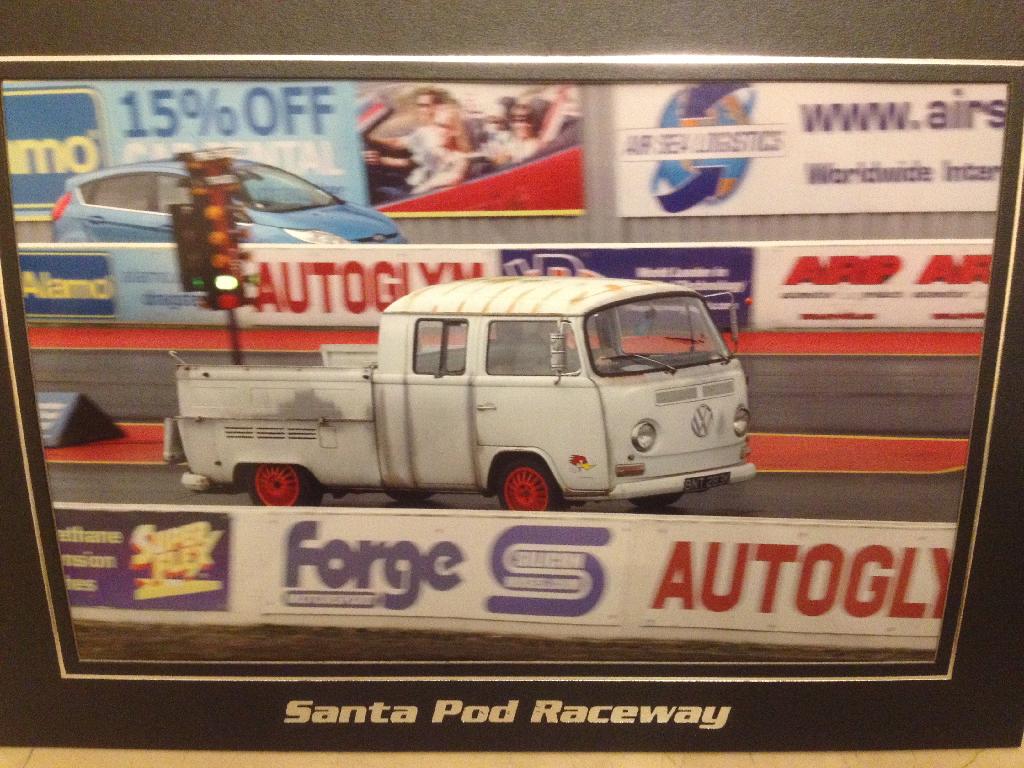

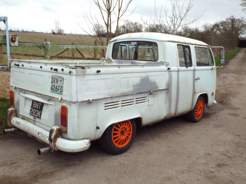

Hello. I'm joker on other forums, I'm Not sure if I should be posting here or will get kicked out straight away, but I'm currently running 914 engines in a 1972 VW double cab
(IMG:http://www.914world.com/bbs2/uploads_offsite/i747.photobucket.com-17118-1394872306.1.jpg)
(IMG:http://www.914world.com/bbs2/uploads_offsite/i747.photobucket.com-17118-1394872306.2.jpg)
I have 2 engines, a 1.7 WO with 40mm dellorto carbs and LA performance exhaust putting out around 100hp and an 1.8 AN.
On return from the above drag strip a rocker shaft sheared and I've suffered some noun or damage to an exhaust valve. The questions I have are, where is it possible to buy valves for these engines? I understand that they're all odd sizes valves compared to the usual 'type 4 bus engines' and that they also have sodium filled valves. Is this last point correct, and if so where do you guys get them from?
I plan to take the AN code engine up to a 2056 with 44 weber idf's, web cam, vintage speed exhaust hoping to push around 140hp to get me a better strip time, sub 18 second at least. The 1.7 will go back to being a street engine.
