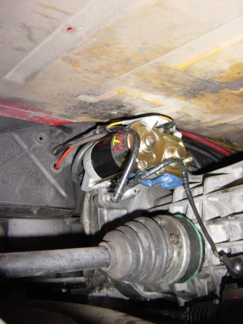

QUOTE(Andyrew @ Aug 9 2004, 08:44 PM)
I have plans on going with a big ol high tq, gear reduction starter, but currently I couldnt pass up the 911 starter for 25 bucks total...
what you need is one of those ...
