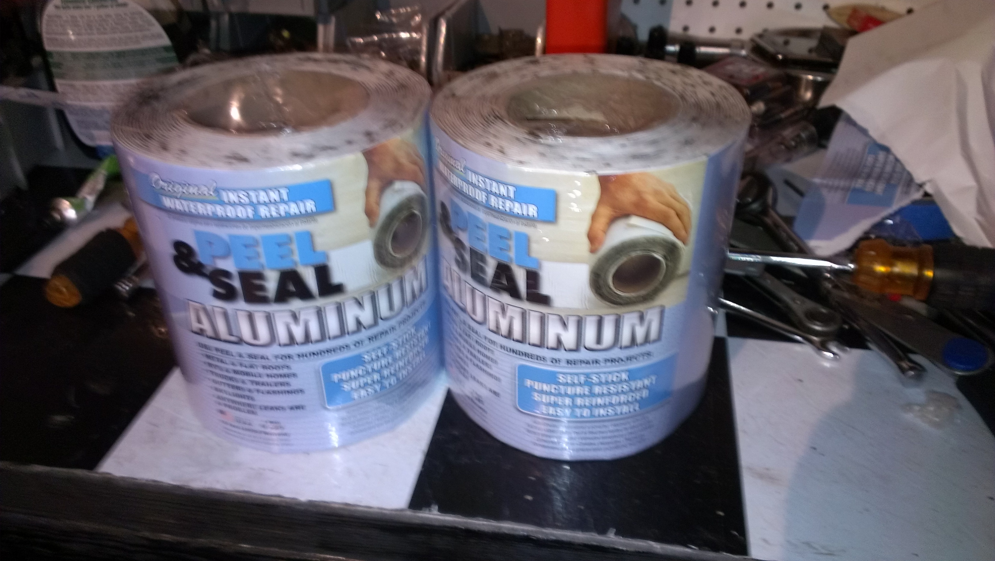

QUOTE(boxstr @ Mar 14 2014, 09:00 AM) *
I have used the peel and seal roof patch material, same as the other more exspensive products. Same thing just no name brand stenciled all over the backing.
Try it you will be glad you did, so will your wallet.
Craig at CAMP
I just bought Peel and Seal. 100' sq for $109. If it's good enough for Craig, it's good enough for me. It came in a 3'x 33' roll. Cuts easy and sticks down real sweet. A little love with a heat gun overcame our cold spring temps. I bought it at a prifessional roof supply place. Aluminum backed and ready to cut. I'll have plenty to do my doors and any stereo install needs too.

Want to use the Peel n Seal but have read about the asphalt fumes.
Does this stuff smell like the tar pits?

It's not tar, it's buytal. No smell, no fumes. I heated the crap out of it. It's the same stuff as the Dyna Mat as far as I can tell.

http://www.mfmbp.com/purchase/store/tabid/...l_and_Seal.aspx
DESCRIPTION
Peel & SealĀ® is an exclusive laminate of reflective aluminum foil, rugged, cross-linked polymer films, and a thick layer of rubberized asphalt. The asphalt compound adheres to most surfaces and seals around most punctures, forming a protective waterproof barrier. A high-quality release liner is applied to protect the adhesive surface until installation.

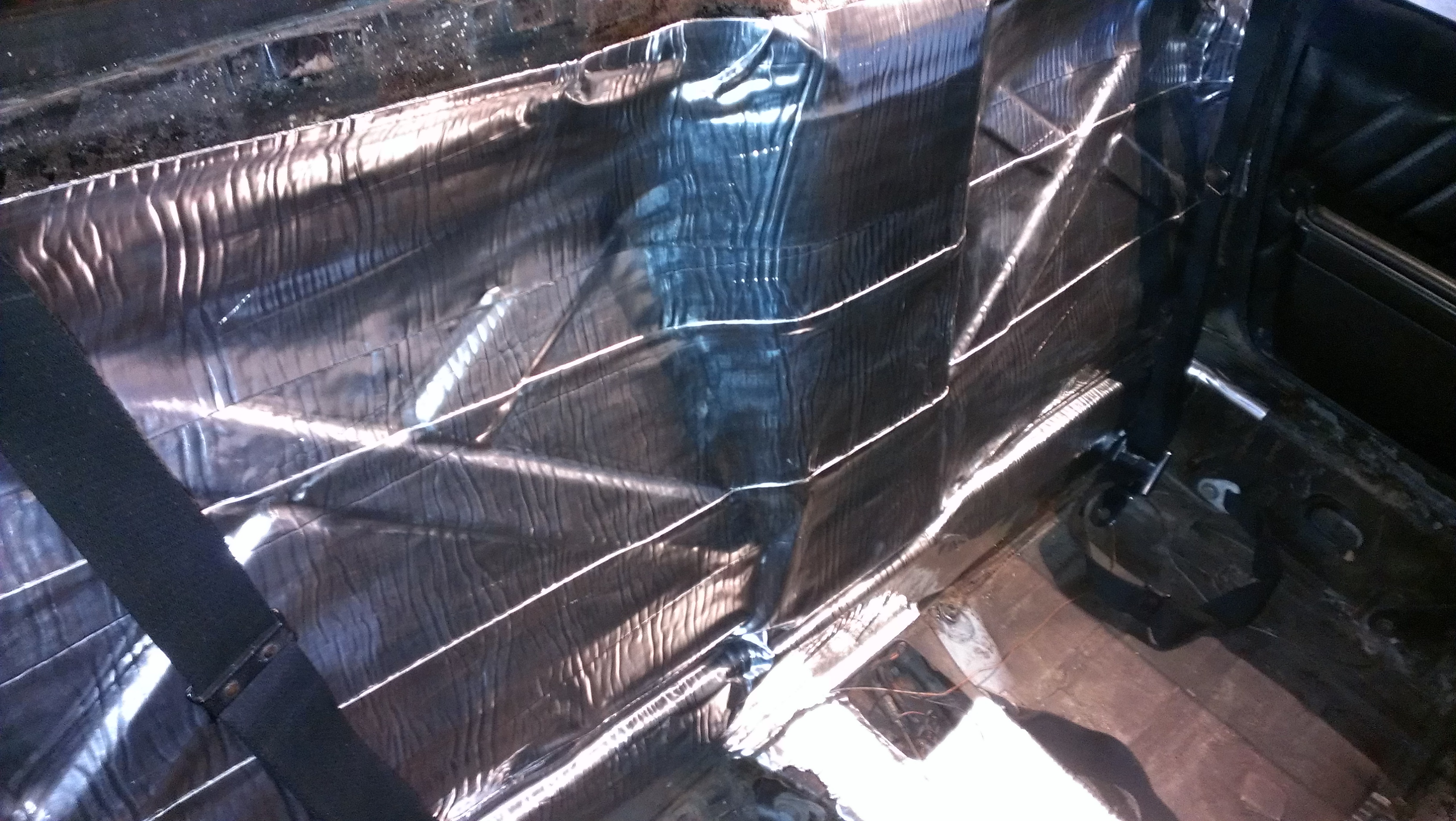

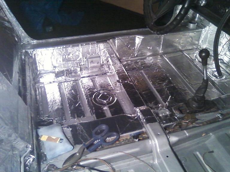

I went with the Peel and Seal...comes on a roll. Somewhat easy to work with. Sticks like the dickens.
7TPorsh
post Apr 2 2014, 09:40 AM
Post #36
7T Porsh
Posts: 2,691
Joined: 27-March 06
From: Glendale Ca
Member No.: 5,782
now the inside...
