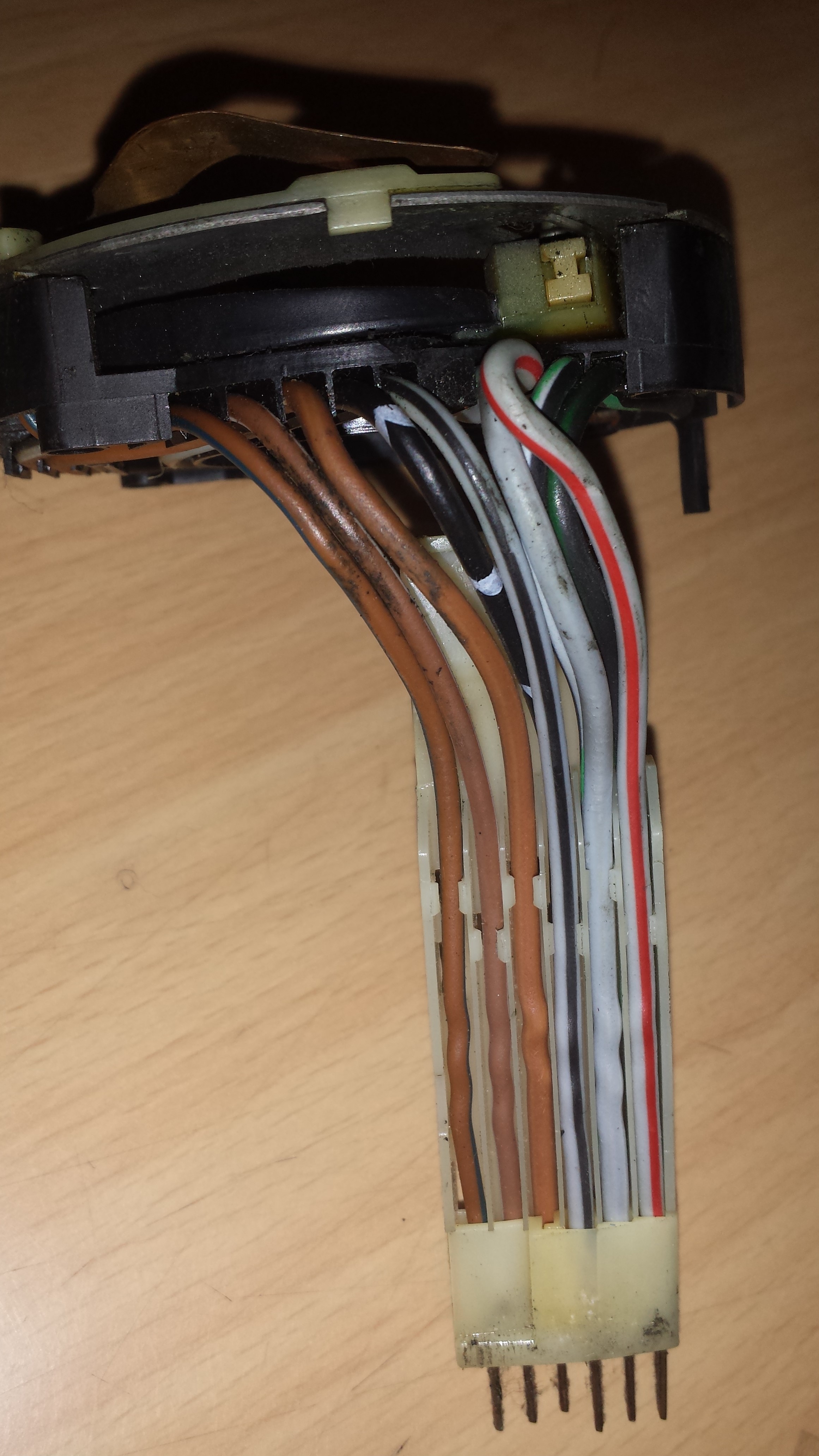

I heard this can be done but have not tried it. The differences are that the 924 switch has ony one rider for the horn and has the 4 and 5th wires swapped in the loom. I do not think this matters as those two are bridged when the left turn signal is applied.
Any body tried It?

I bought a 924 switch and installed it about 9 years ago. It works great but I can't remember what I had to do. I seem to recall trimming some of the plastic wire channels off that weren't needed or didn't fit. It took a little work but it eventually fit. I realize I'm not much help here but it WILL work.

Yes you can... certain years.
According to Jeff Bowlsby's spreadsheet
https://bowlsby.net/914/Classic/zTN_Gen_914...Interchange.xls
It shows...
Part Name VW/Porsche Part Number Bosch Part Number Porsche 914 Other vehicles using the same part number [SPN substitute part number]
Turn signal switch 311.953.513B 1970-71 VW 1968-70 Beetle/Ghia, VW Type 3 68-69
Turn signal switch 111.953.513C 1971 VW 1971 Beetle
Turn signal switch 914.613.913.14 1972-74 VW 1972-79 Beetle, Porsche 1976-80 924 [SPN 111.953.513F]
Turn signal switch 914.613.913.15 1975-76 VW 1975-76 Rabbit, VW 1972-79 Beetle, Porsche 1977-81 924 [SPN 111.953.513F]

Just FYI that book says the 1975-76 switches do not interchange with any other year 914 but are a direct swap for 1977-81 924's. Don't see any other notations for other years related to the 924 switch. Something else I didn't know!
