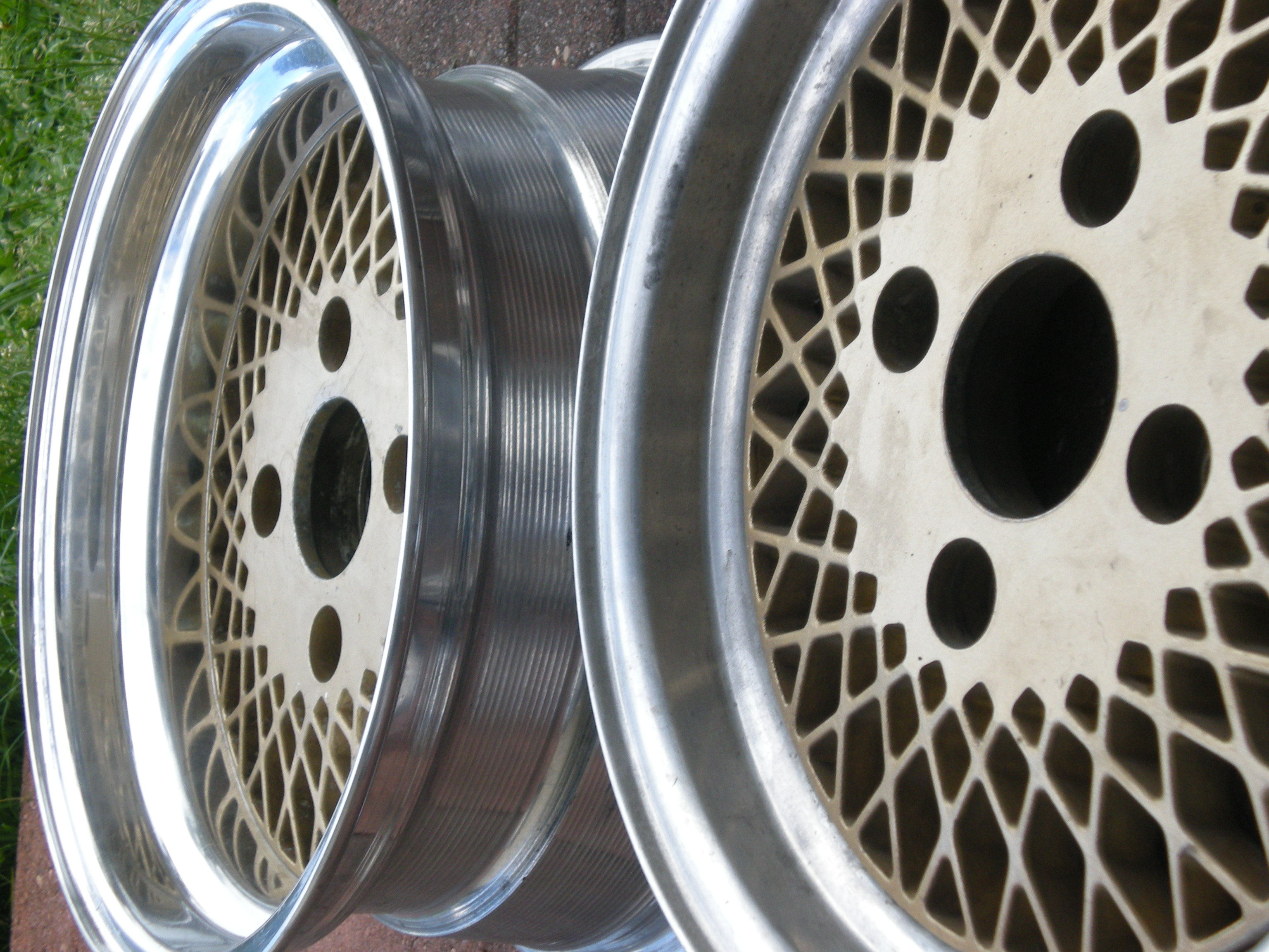

I can and have done quite a few fuchs centered 17's
sixnotfour
post Apr 27 2014, 03:25 PM
Posts: 11,184
Joined: 12-September 04
Member No.: 2,744
15x6.5 Mahle gas burner 5 lug
15x7 Mahle 4 lug
16x7.5 Fuchs

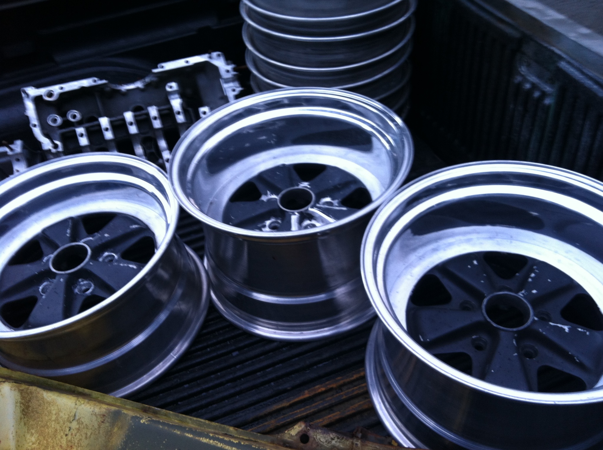

9x17 Fuchs
11x17 Fuchs

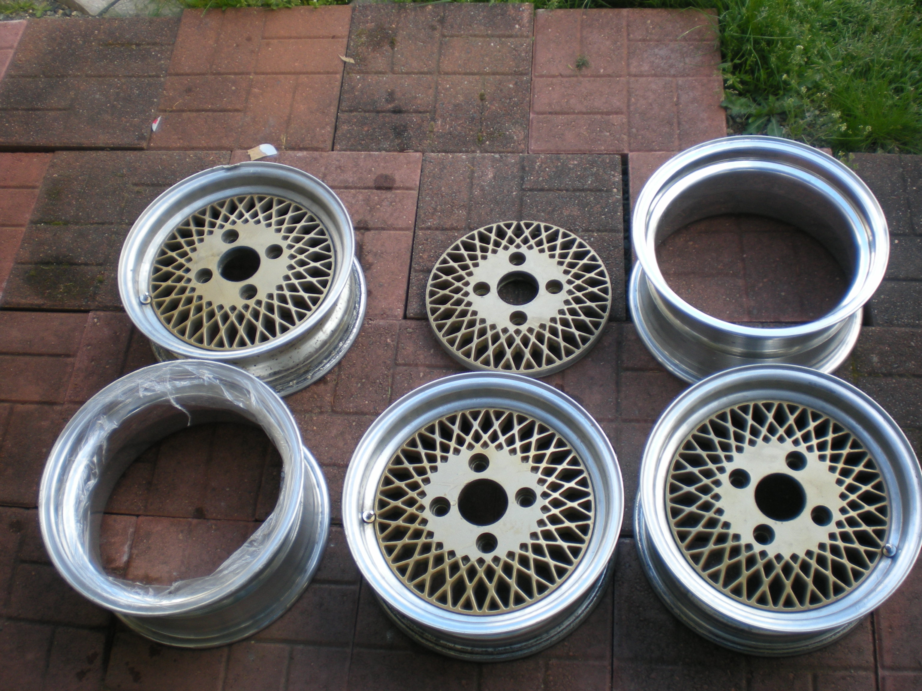

Sixnotfour,
How does the center of the 4 lug faux bbs wheel get held in place and not spin?
Can you make a set of four lug Fuchs?
sixnotfour
post Apr 27 2014, 06:20 PM
Posts: 11,184
Member No.: 2,744
Yes, They are interference fit and tig welded on the back side.. like the mahle 4 lugs , also the rim blanks are DOT approved. and polished.
