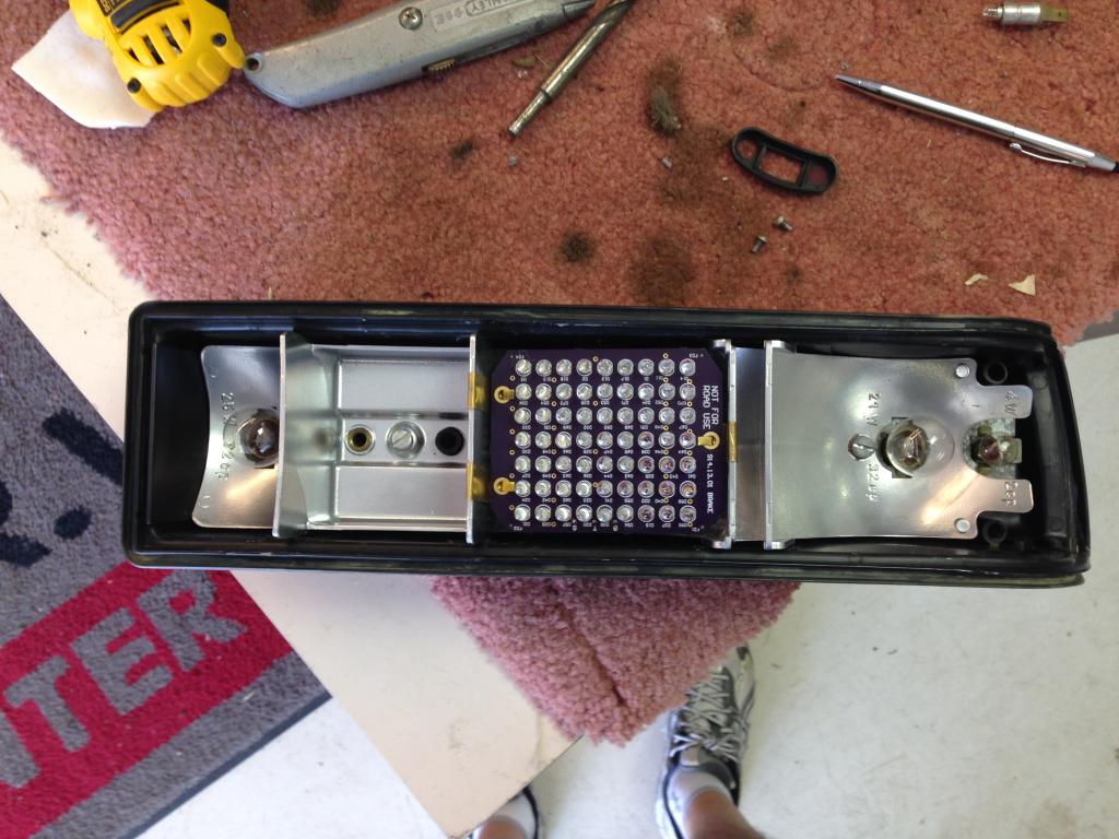

We just got LED taillights from Spoke and have a set of taillight buckets setup just for the LED boards. We want to keep the original taillight assemblies with the OEM setup. Why? We want to be able to go stock quick if we want too.

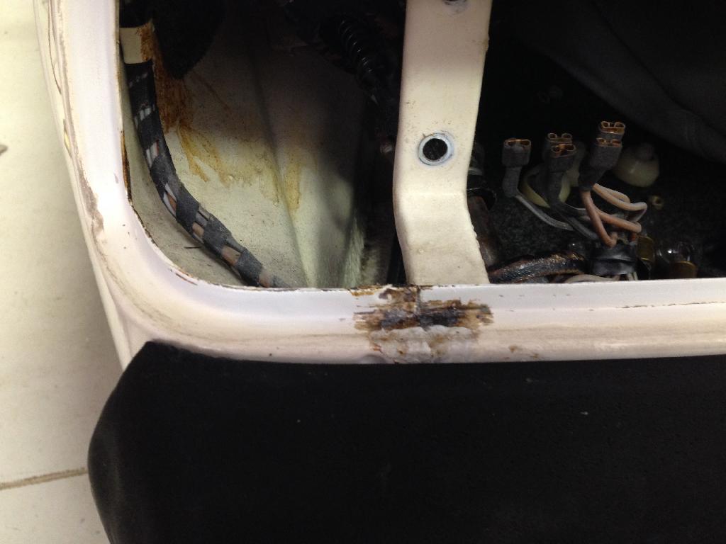

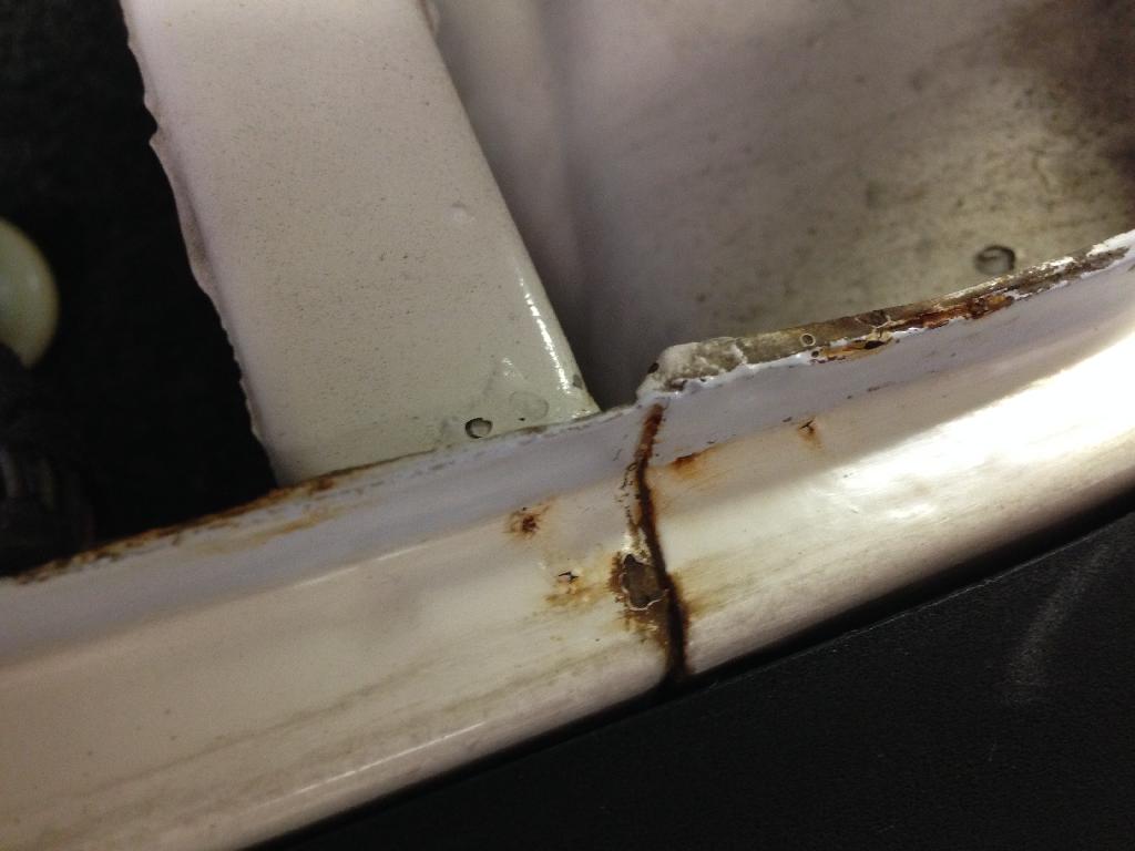

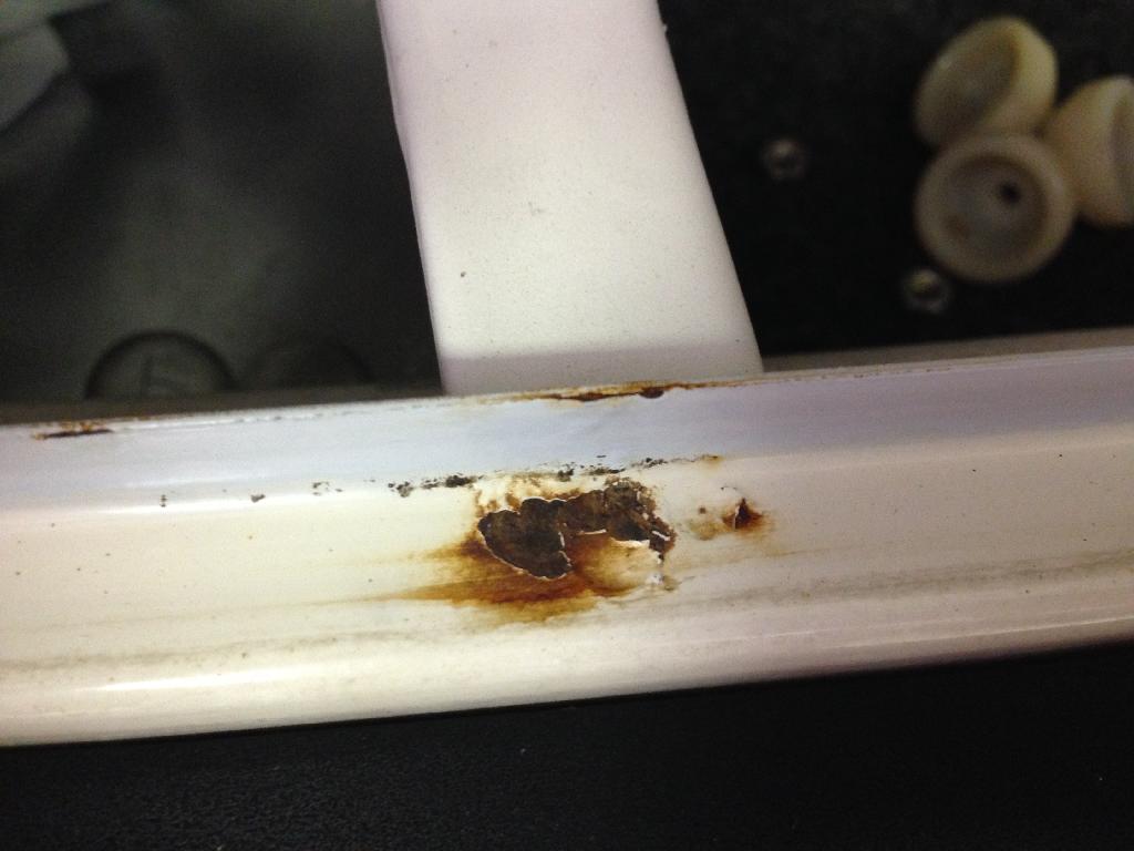

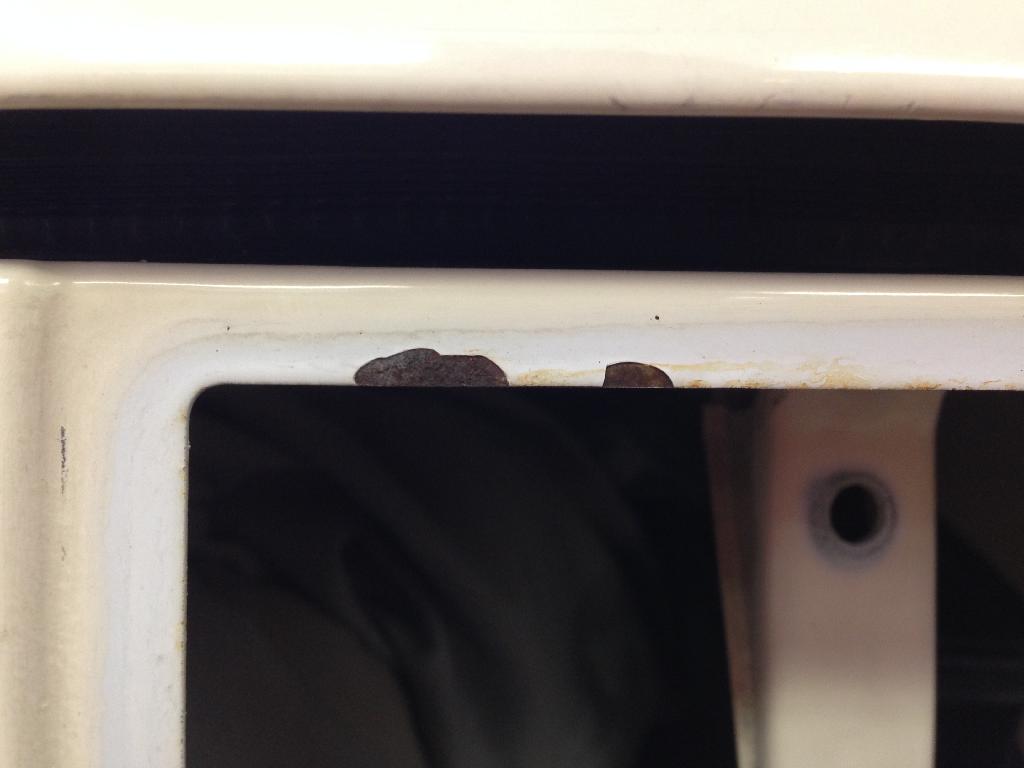

This is a little off topic, but is in the tail light area. As we have the tail light buckets out we see a few small rust spots behind the buckets on the body. (Who knew there would be rust on a 914, right?) Just surface rust. The paint is original. I thoughts are to clean off the surface rust it these spots with a primal tool, apply some POR15, and use touch up paint. Is this the same route you would take?

(IMG:http://www.914world.com/bbs2/uploads_offsite/i9.photobucket.com-8132-1396623409.4.jpg)

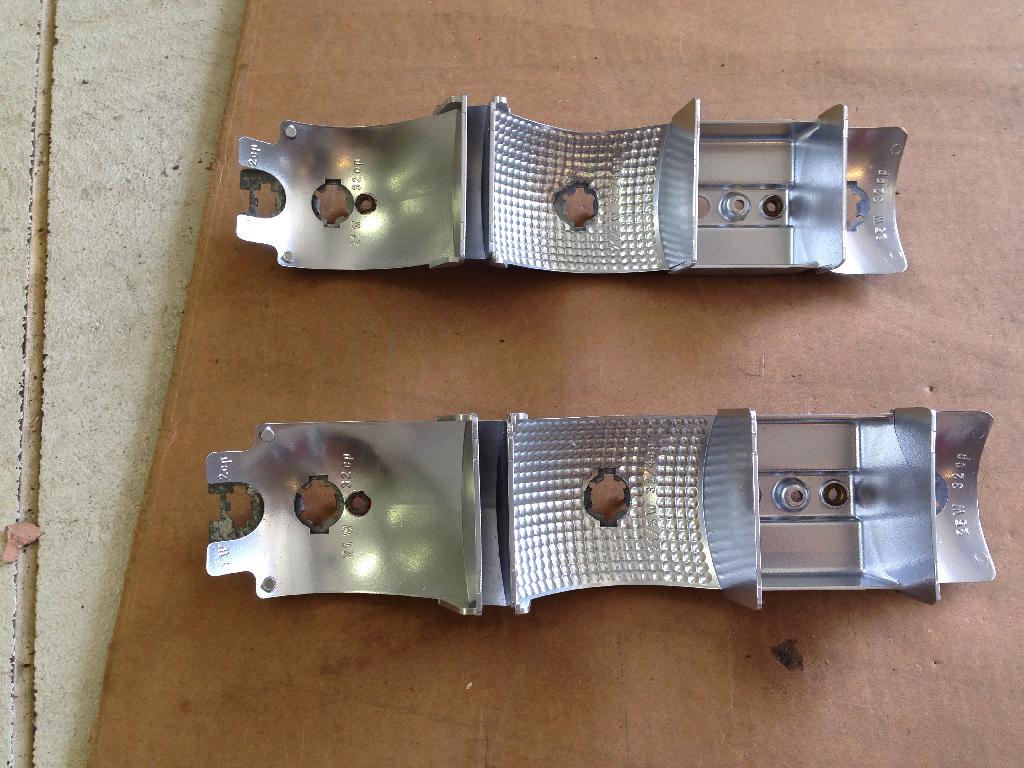

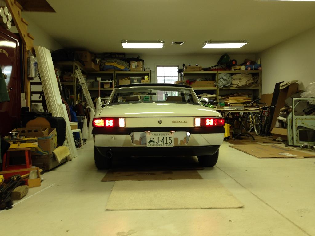

Well, I got some "chrome" rattle can from the auto parts store and refinished the reflectors. I think they turned out pretty good. Got them put back together today and back in the car.
(IMG:http://www.914world.com/bbs2/uploads_offsite/i9.photobucket.com-8132-1398676557.1.jpg)
(IMG:http://www.914world.com/bbs2/uploads_offsite/i9.photobucket.com-8132-1398676557.2.jpg)
(IMG:http://www.914world.com/bbs2/uploads_offsite/i9.photobucket.com-8132-1398676557.3.jpg)
post Apr 28 2014, 04:20 AM
914-6 GT in waiting
Posts: 20,587
Joined: 19-September 09
Member No.: 10,825
Looks great

Now add the third brake light. I also used chrome spray paint and it works great.
