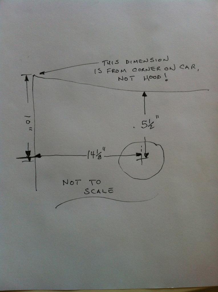

Larmo63
post May 7 2014, 03:37 PM
Posts: 4,267
Joined: 3-March 14
From: San Clemente, Ca
Member No.: 17,068
I measured this on my car to the center of the cap...all measurements are from the edge of the car, not hood...the 10" x 14 1/8" measurement is done with
a steel square, squared up flush inside the right fender....Does this make sense?
(IMG:http://www.914world.com/bbs2/uploads_offsite/i983.photobucket.com-17068-1399498672.1.jpg)

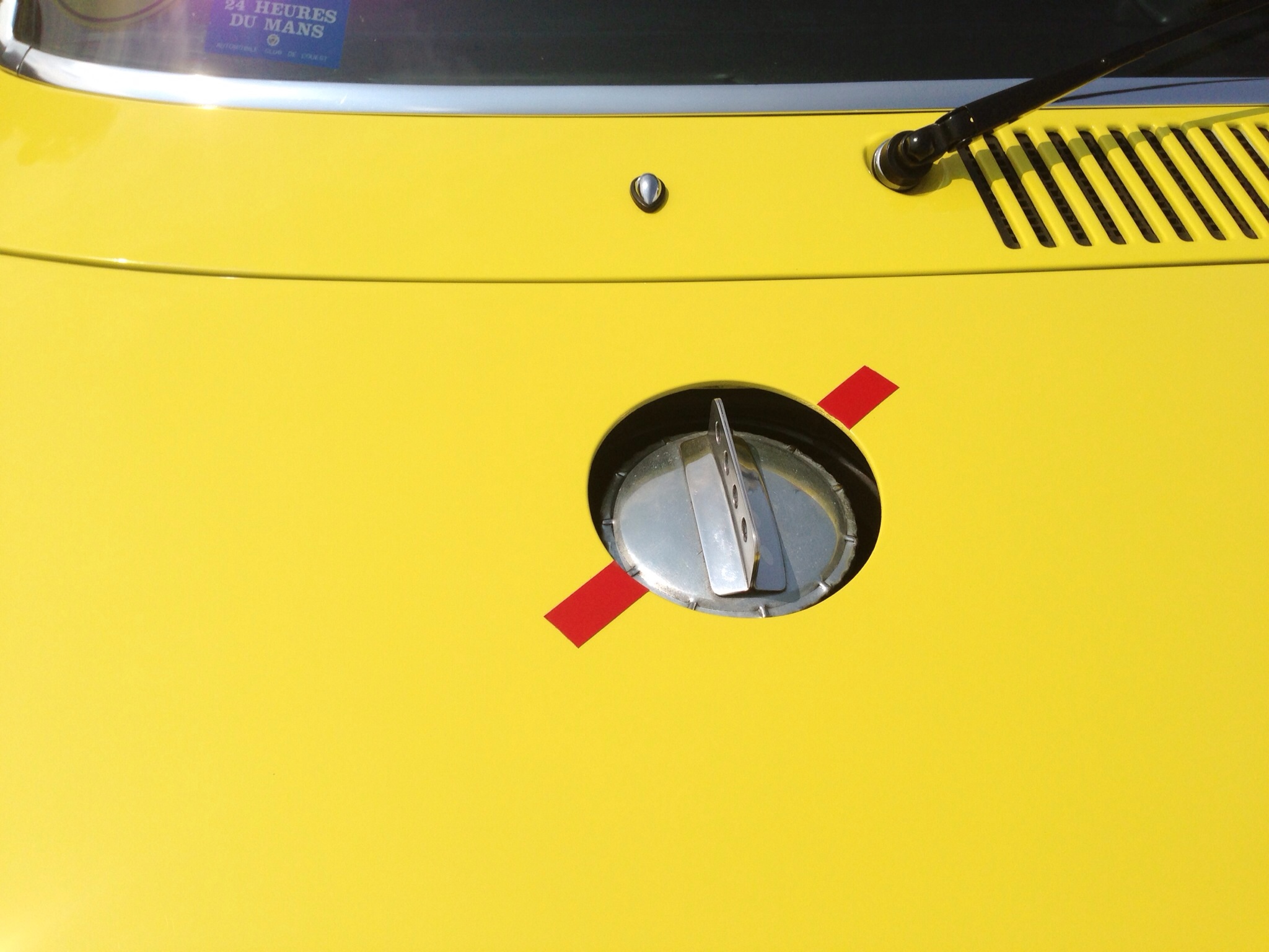

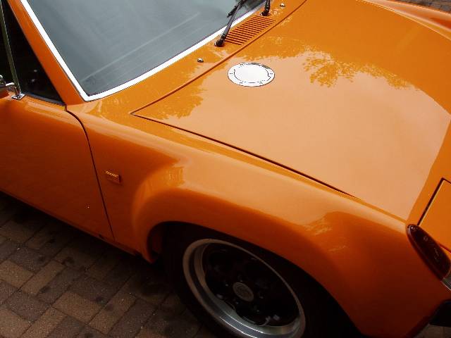

I love the cap that Eric has on the yellow car....Do those fit our 914 tanks?

iamchappy
post May 7 2014, 03:59 PM
It all happens so fast!
Posts: 4,893
Joined: 5-November 03
From: minnetonka, mn
Member No.: 1,315

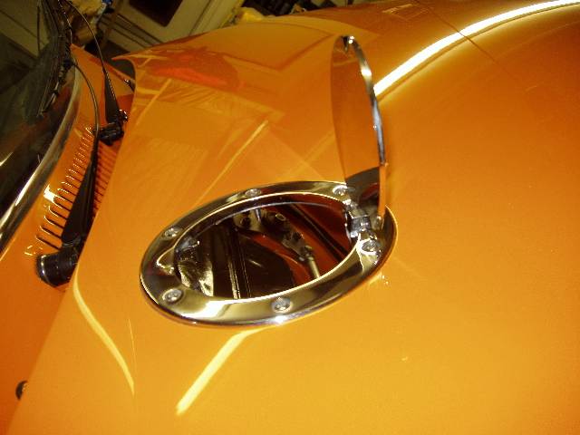

Not through the hood filler cap but hope it helps give you an idea

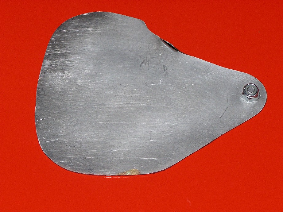

QUOTE(iamchappy @ May 7 2014, 05:59 PM) *
Chappy,
I am wondering if your lid when open could be 180 degree off??
Looks to me like it would be easier to put the gas nozzle in??
Just wondering if you researched the proper flap opening??? (IMG:style_emoticons/default/happy11.gif) (IMG:style_emoticons/default/happy11.gif)
I know you probably followed Eric's instructions (IMG:style_emoticons/default/laugh.gif) (IMG:style_emoticons/default/confused24.gif) (IMG:style_emoticons/default/hissyfit.gif)

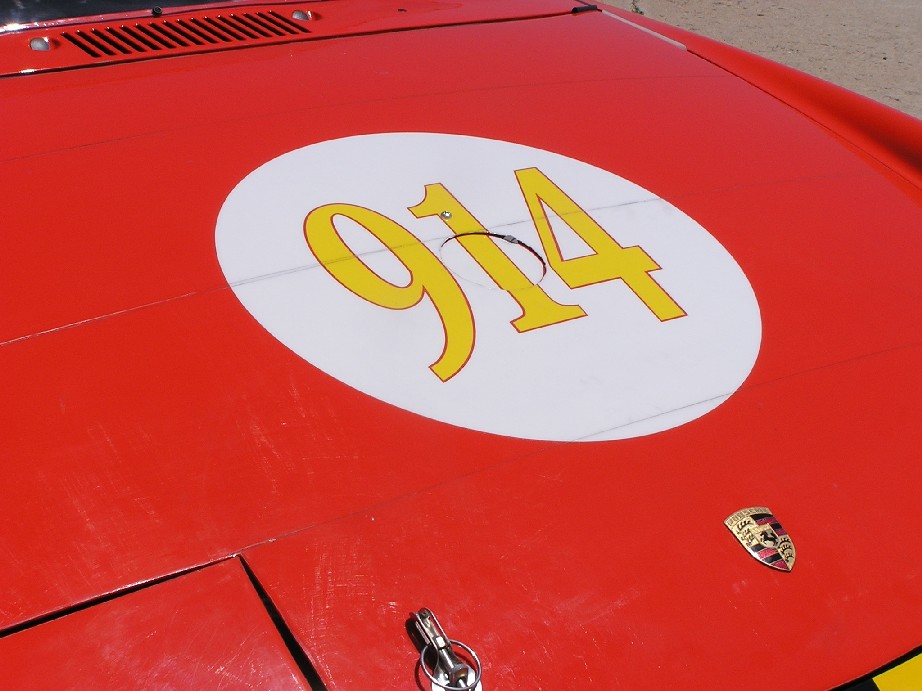

Hey Eric,
Where's your flap. (IMG:style_emoticons/default/happy11.gif)
Tom

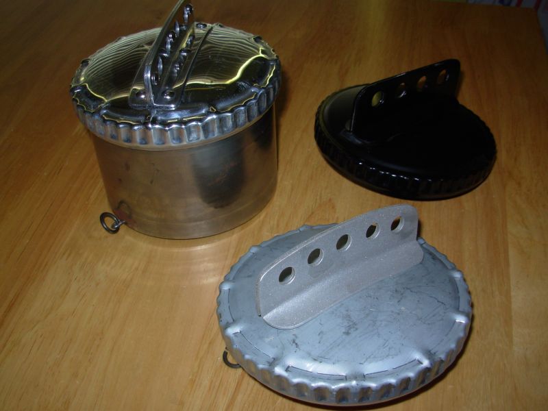

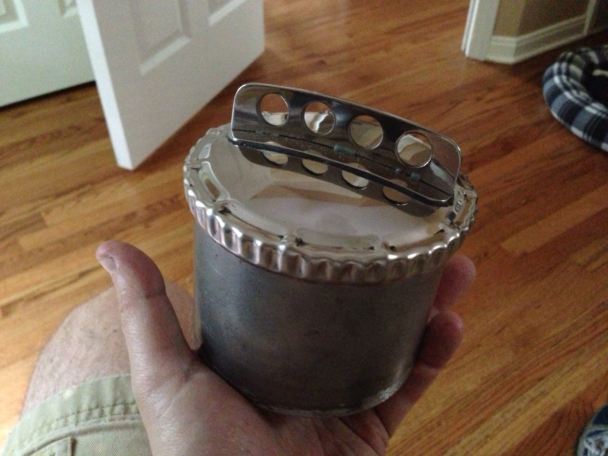

If eric is using the 110mm blau cap then you will need the matching blau base. This can be welded to the OE 914 gas cap flange. The mittlemotor option is currently the only ones that I'm aware of that have the 110 blau caps & base and they are not cheap. I got mine from a guy on Pelican but I don't believe he has any more.
Another member here on the board made some GT fins out of SS that were very nice. I used Epoxy to adhere it to my 110mm blau cap.
DavidAttached Image

Mounted that way because of the slope on the hood. Also keeps it from flying open, and keeps stuff like water and dust from leaking in....
I also have an extra hood with just a hole.....
