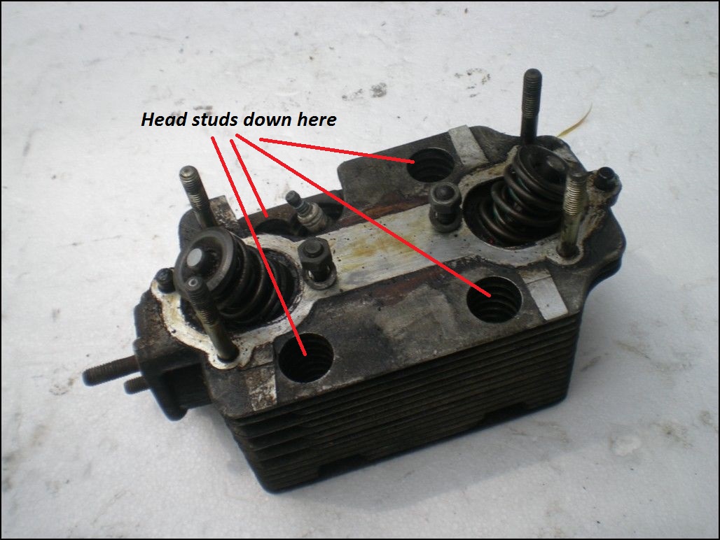

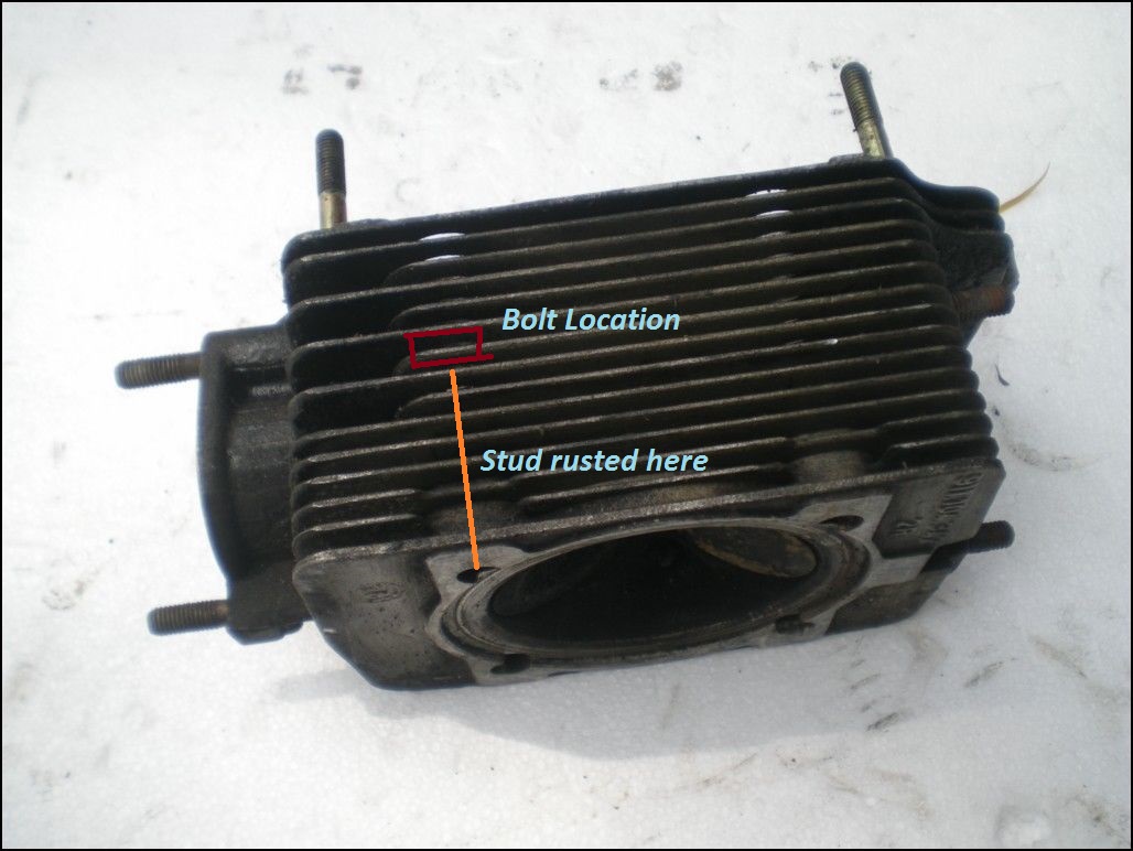

Fiddled with the motor some more. Checked for extra washer, pulled pistons from other side.
Rotated offending cylinder to tdc and soaked with pb blaster.
Screwed in leak down testing tool and applied 100 psi. Nice leak from exhaust side.... That's right, this is the dead cylinder (IMG:style_emoticons/default/headbang.gif)
Tapped around with bigger mallet and 2x4. Got slight movement.
Appears top right head stud is corroded to the head.
I can twist the head 2-3 mm but it is bound to the stud
Soaking again tonight and may have to cut the head stud (IMG:style_emoticons/default/sawzall-smiley.gif)
Unless someone knows how to dissolve rust caused by mouse piss (IMG:style_emoticons/default/av-943.gif) (IMG:style_emoticons/default/agree.gif) (IMG:style_emoticons/default/WTF.gif)

a little heat will cure the oxidation, just say'in

There was a recent thread about using vinegar to dissolve rust. Let it soak for a few hours.

Don't know if there are enough threads on those studs but do the double nut trick and see if you can rotate the stuck stud.
Yea that wording is likely to come back and bite me!

(IMG:style_emoticons/default/beer.gif) Some very good ideas and some unique ones that I had never heard of.
After a couple of days of soaking, trying heat gun and propane torch.
It was time for (IMG:style_emoticons/default/sawzall-smiley.gif)
I ended up using a auto body saw to cut the cylinder stud. It took 5 blades in all, as the studs are hardened and the saw only has about a 3/8" stroke. Yes I lubed the blade and cutting surface to not harden it.
I am a dosin at the Museum of American Speed and spoke with the engine restoration guys. Their trick chemical is a 50/50 mix of Acetone and Trans fluid.
Not that the head is off, I can try other approaches to removing the stud.

Put it in an old crock pot full of vinegar and put it on high for a couple of hours (outside of course:-)

I have had the same problem, and cut the stud...BTW that appears to have 90mm cylinders, 2519cc , the case has been bored to accept them, heads modified also to accept the bigger bore and later head gasket, or they are later heads, what is the casting year number on them ??

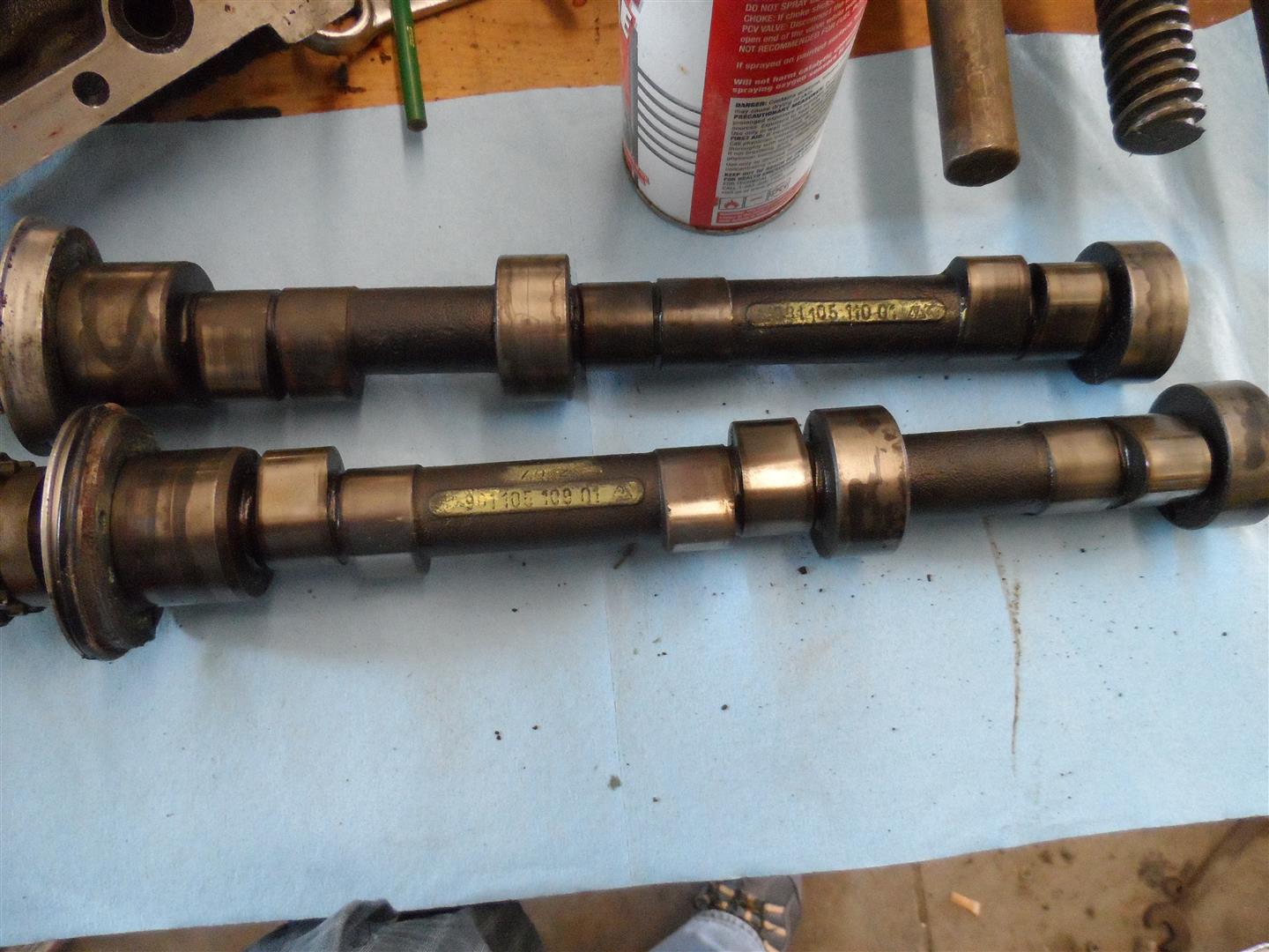

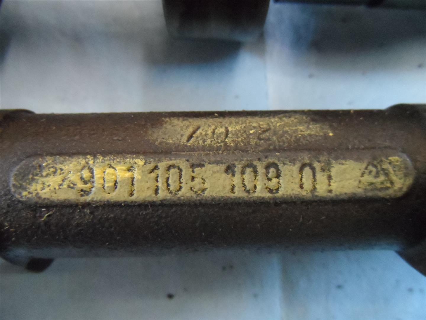

Cams
901.105.109.01
901.105.110.01
Date stamped 2/70
Any idea what they are and how I can tell if they were reground?
Original cam specs would help as I could measure to see if they are stock

looks like you have Solex Cams. . Great for the street. . A little better than E's but not quite as 'lumpy' as S. . I had a 2.2 with E pistons and Solex cams. . starts pulling hard at 3500 and went to 7200 easily

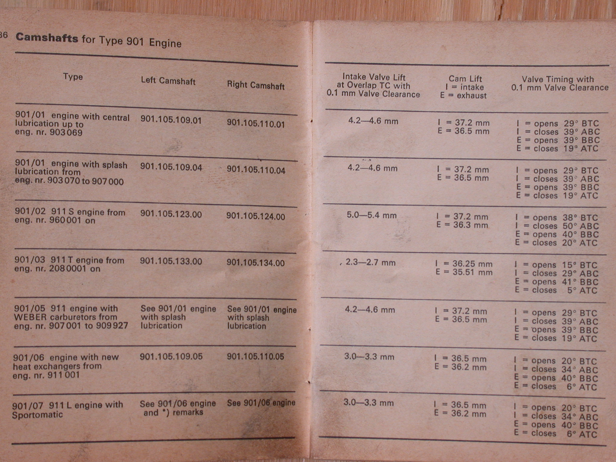

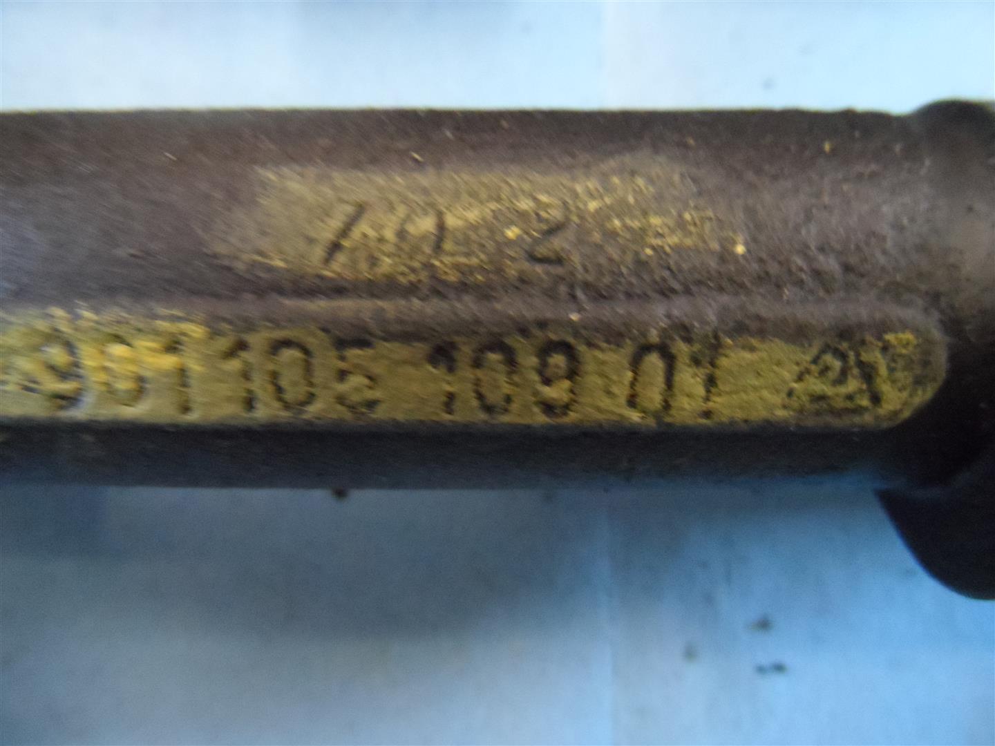

These were "Solex" cams for '67 engine with splash lubrication, not center lube. Same billet numbers.
See chart below, fifth line down, matches your case serial number.
Agree with toolguy, great for street use, roughly between E and S cams.
I don't think "70" number is date code.
Anything stamped on either end?
Jon B.

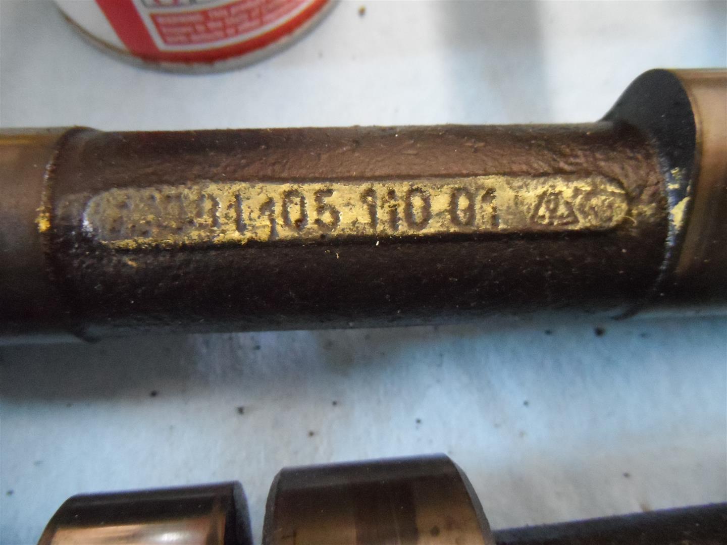

After cleaning some crud off of the end....
One said "SOLEX"
Sounds like it could be a fun motor.

Had one of the cylinders stuck to the head on disassembly.
Tried the vinegar trick on a old 1.7 head. Works slow but seems to work
Used some PB Blaster on the stuck cylinder. Added a little heat and it came right off.
Still soaking the rusted stud. Only time will tell.
