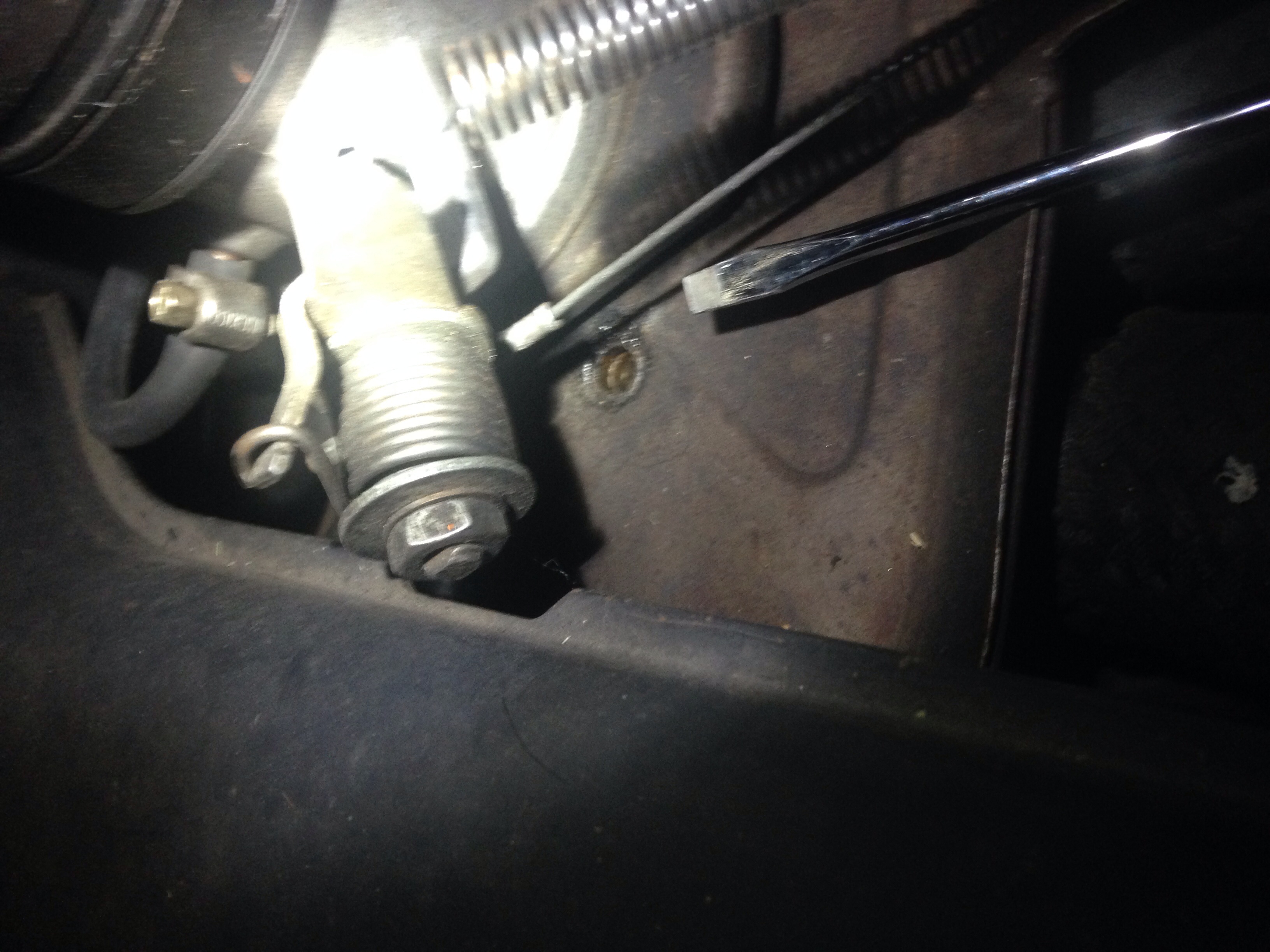

I'm hoping that someone else with a 75 2.0 can chime in and tell me what is missing here. Is there a screw that fell out? Look at the pic, about an inch from the tip of the screwdriver in the pic. The engine will barely start and won't stay on. Its sputtering and wanting to die.
Thanks for your help!

it hard to tell, but looks like the throttle cable is coming apart. That should not have anything to do with the engine running. Disconnect the cable from the throttle body and see if that lets it idle.

If you are pointing at that hole by the screwdriver, I think that's one of the structural tubes in the
air plenum and they don't have anything in them....it's just a tube that runs from top to bottom of
the plenum to add rigidity. I think we need some better photos of the throttle cable, it's hard to
see whats happening there. Check the CHT sensor resistance to see if it's in need of replacement.
It could be giving you too much fuel and causing the running problems.

Thanks for the feedback on the hole in the plenum. Glad to hear I'm not missing anything.
The throttle cable is fine. I press the gas peddle and watch the RPMS go up accordingly. I also changed the CHT sensor this morning too with a correct one for the 75 2.0.

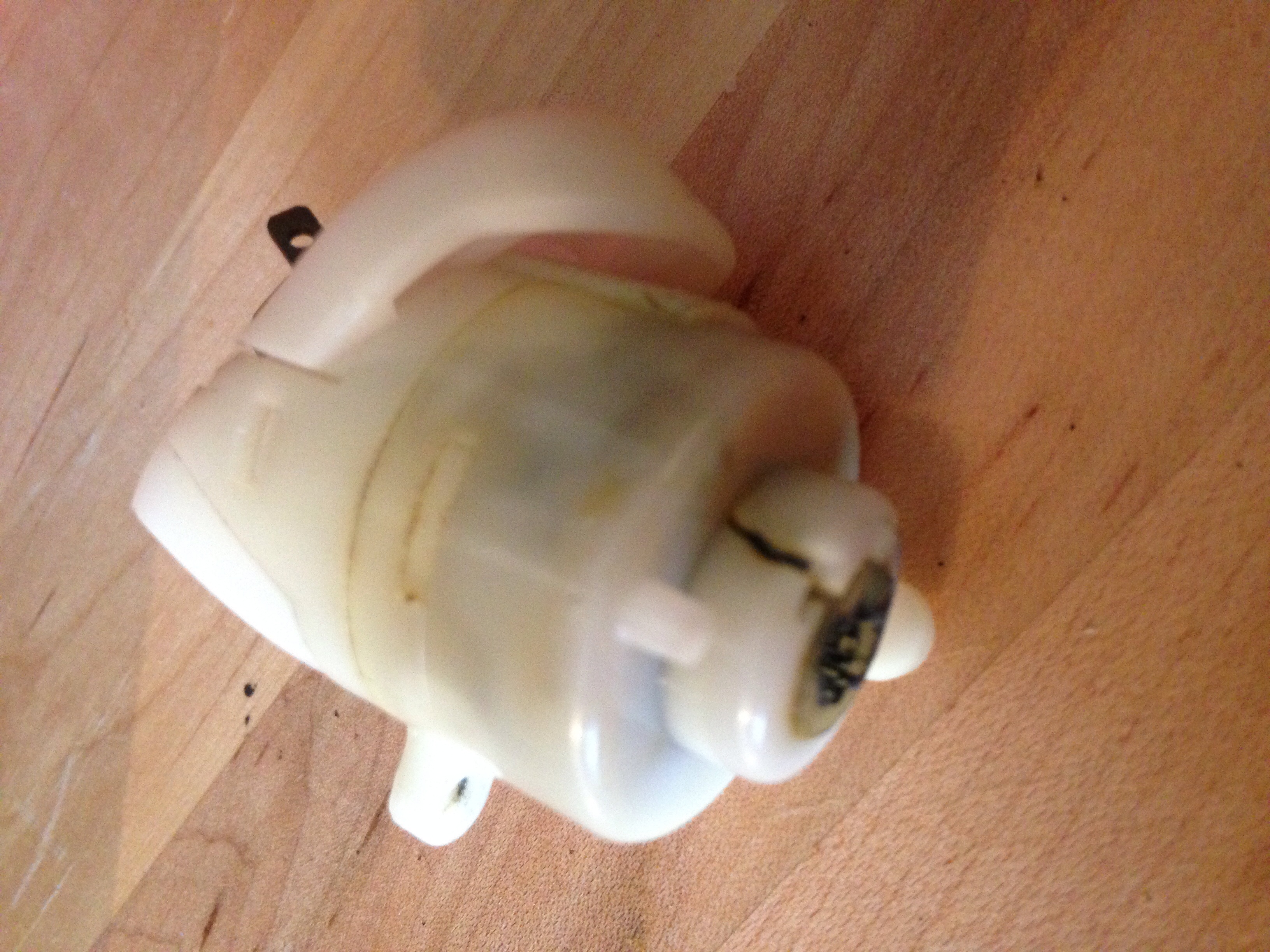

I ended up doing two things to it yesterday, so let's just say that it was one of the two that solved the issue here. I swapped out the ignition switch, which was found to be cracked (see pic). I then also installed a Pertronix II that I had recently bought from Brad Mayeur (914 Limited). The points looked okay, but I can honestly say that the car runs the best it's ever run and now has a consistent idle to it too. The car runs beautifully, and that's with the platinum plugs still on. I'm going to order NGK's tomorrow though and swap out the Platinums.
Thanks everyone for all of your advice. Greatly appreciated!!!
