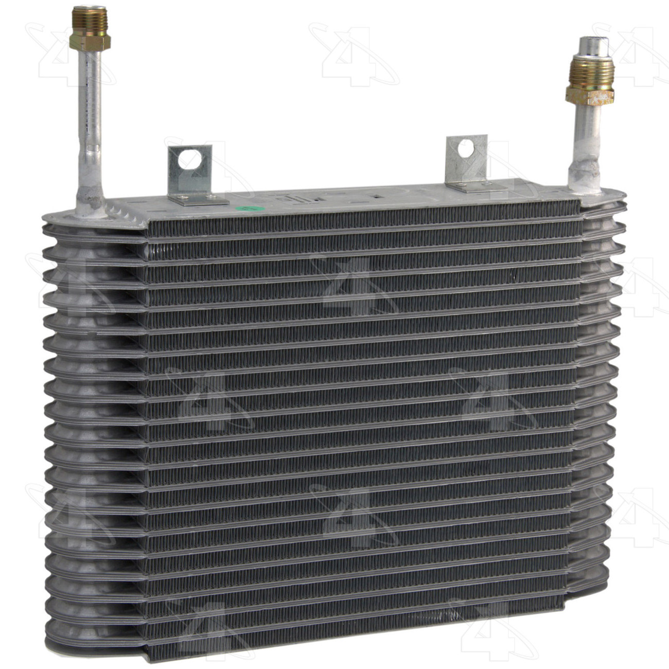

McMark
post Jun 25 2014, 09:07 AM
914 Freak!
Posts: 20,180
Joined: 13-March 03
From: Grand Rapids, MI
Member No.: 419
I think we can stack the heater core and the evaporator in the fresh air box location, but will have to relocate the fan. This could turn into a nice feature to have 'climate zones'. If there is a fan on either side, then the driver and passenger could increase or decrease the airflow independently. (IMG:style_emoticons/default/idea.gif)
JRust
post Jun 25 2014, 11:58 AM
Posts: 6,317
Joined: 10-January 03
From: Albany Oregon
Member No.: 129
QUOTE(McMark @ Jun 25 2014, 08:07 AM) *
Ooh I like your thinking! Man you should just whip one of those out right now. Think of all the 914 owner's lining up to have you do it. You just need a working prototype. What better car could you put it in to show off your mad fab skills (IMG:style_emoticons/default/confused24.gif)
McMark
post Jun 26 2014, 12:14 AM
914 Freak!
Posts: 20,180
Joined: 13-March 03
Member No.: 419
This 99 GMC Jimmy evaporator looks like a good fit. (IMG:style_emoticons/default/idea.gif)
