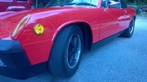

Bridgestone Potenza Pole Position 195/65r 15s on A.E. 6" rims, The backspace is about 41/2 inches. (I like the look of the stock sidewall height)
Rears have a 3 mm. spacer. No rubbing anywhere, non-rolled fenders.
I can barely fit my pinky between the fender and the top of the tire.

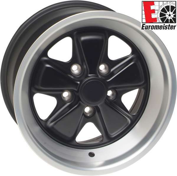

Thinking about doing these Euromeister Replica Fuchs 17x7 on the 205/50r17 and rolling the rear lips and fenders

[quote name='Sfreeman615' date='Jul 19 2014, 12:49 PM' post='2063417']
I've considered those wheels as well after seeing them on another members car on this site. They fit under our narrow fenders without modification and look great. They are Fuchs inspired wheels and do look different but they still look good for that outlaw kind of look on a budget. I wonder how much they weigh?

[quote name='lonewolfe' date='Jul 19 2014, 03:16 PM' post='2063433']
[/quote]
I LOVE that tire size and wheel set up! Any idea what size those are???

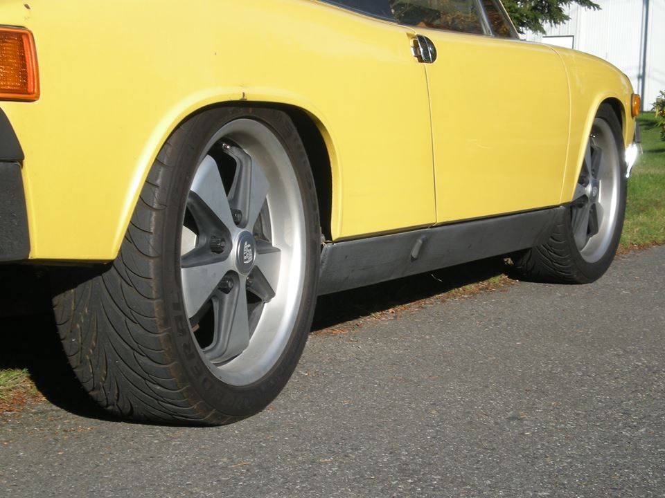

6X16 Fuchs (from front 911 SC etc) with 205-50-16 tires. Wheels refinished by Harvey Weidman. No mods to body.

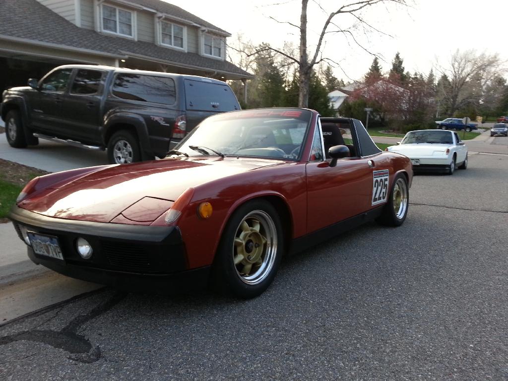

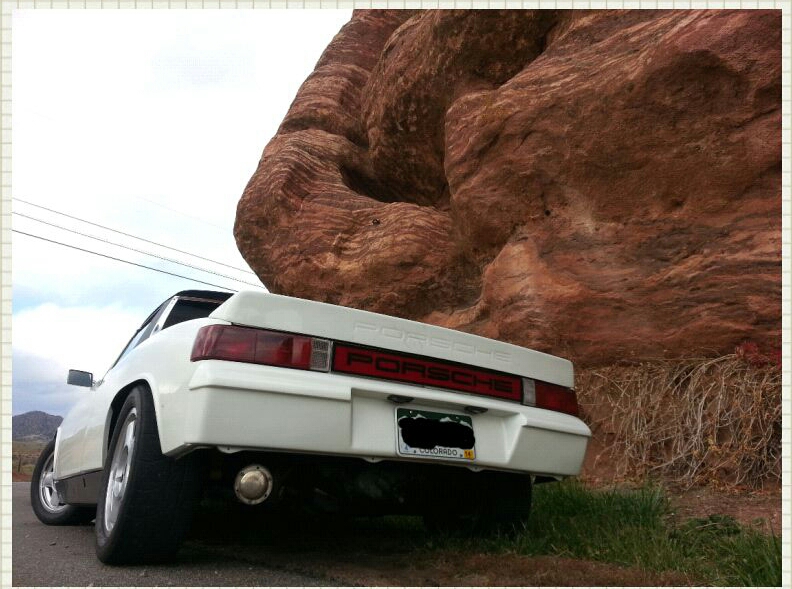

205 50 15 rubber vintage revolution 4 bolt wheels. 15 X 7 rim
Inside fender cut out smooth.
(IMG:http://www.914world.com/bbs2/uploads_offsite/i1315.photobucket.com-15718-1405824214.1.jpg)
My buddy has these I like. ..same tire size
(IMG:http://www.914world.com/bbs2/uploads_offsite/i1315.photobucket.com-15718-1405824214.2.jpg)

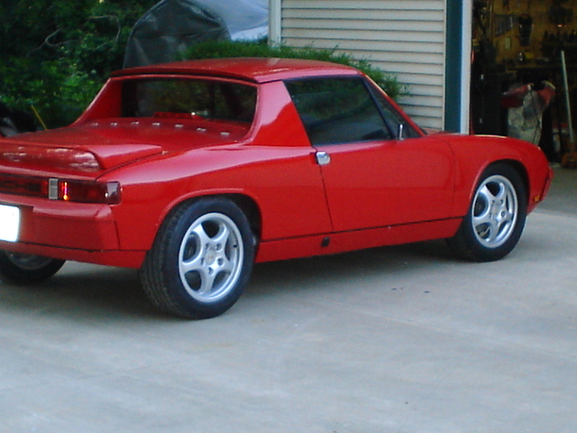

If you are willing to flair your rear fenders 1 1/4 inch and convert to 5 lug,
You could fit 911 Cup I rims with 225/50-16 rear and 205/55-16 front.
(need 23 MM spaces) I have lowered the car 2 inches since this picture was taken.
