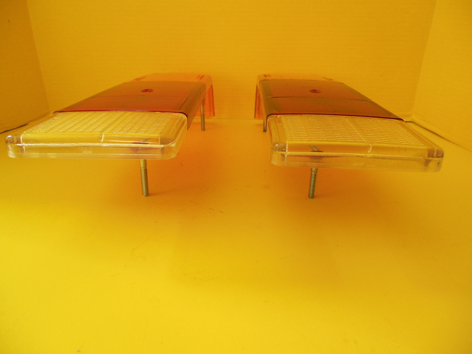

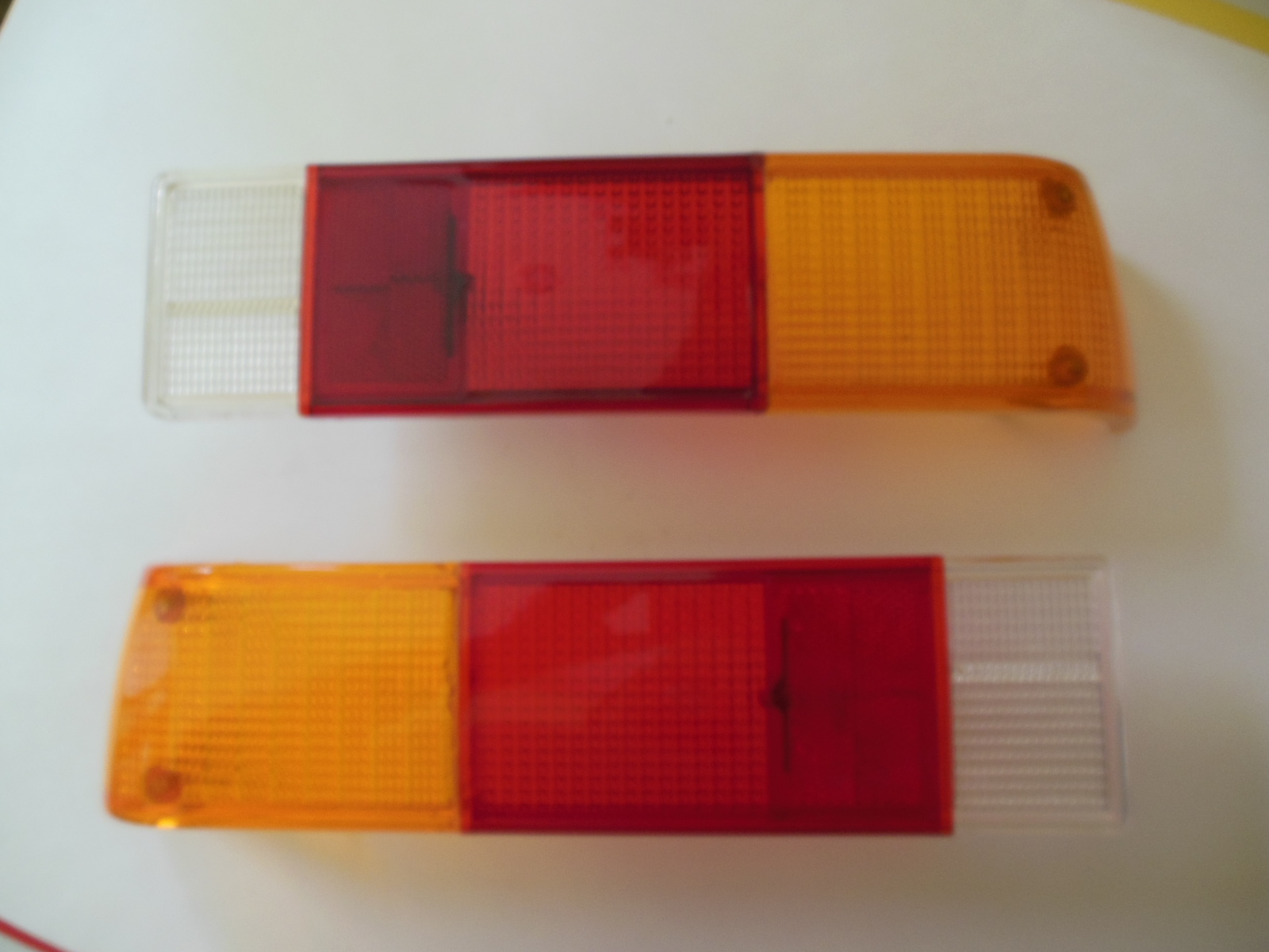

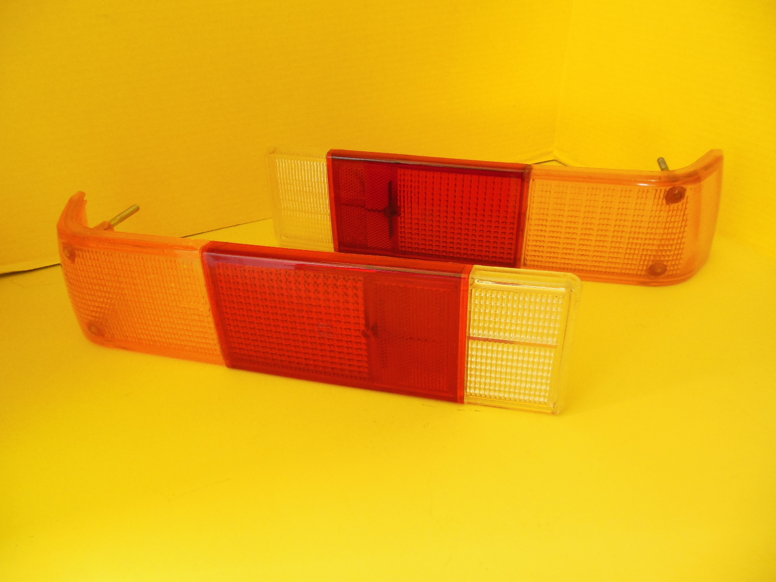

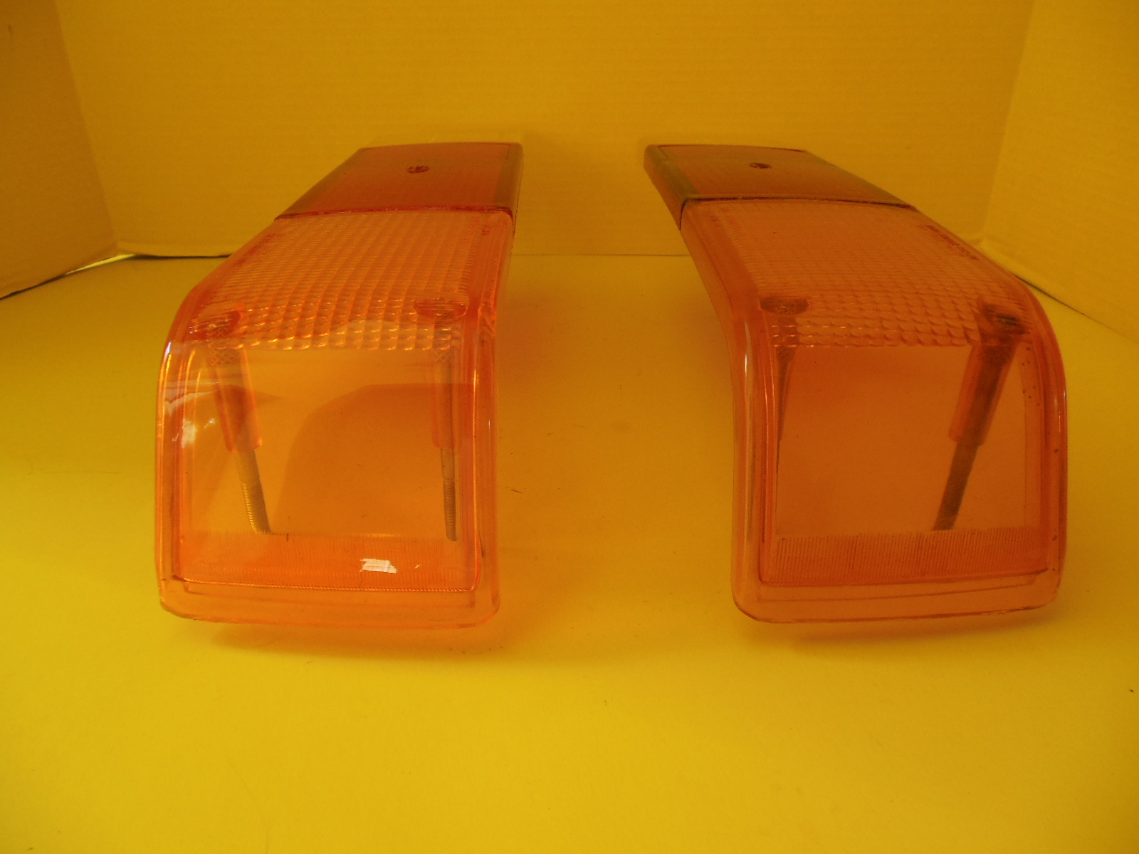

Posts: 200
Joined: 25-February 13
From: South Florida
Member No.: 15,579
QUOTE('73-914kid @ Aug 1 2014, 04:16 PM) *
People break them trying to install them. The curvature of the lens doesn't match the curvature of the housing. I had to do some heating to get them to fit ona customer car. takes about an hour a lens to get them to fit nicely.
Those look easy to repair though.. hmm..
That's the cool thing about these split lenses. When you go to glue them back you can compensate somewhat and make adjustments before your adhesive sets up. Then they sit more flat. I used an undamaged oem one as a guide and the two I bought looked well after repair. They were the Euro knock-offs. Here are pictures of how mine came out.
