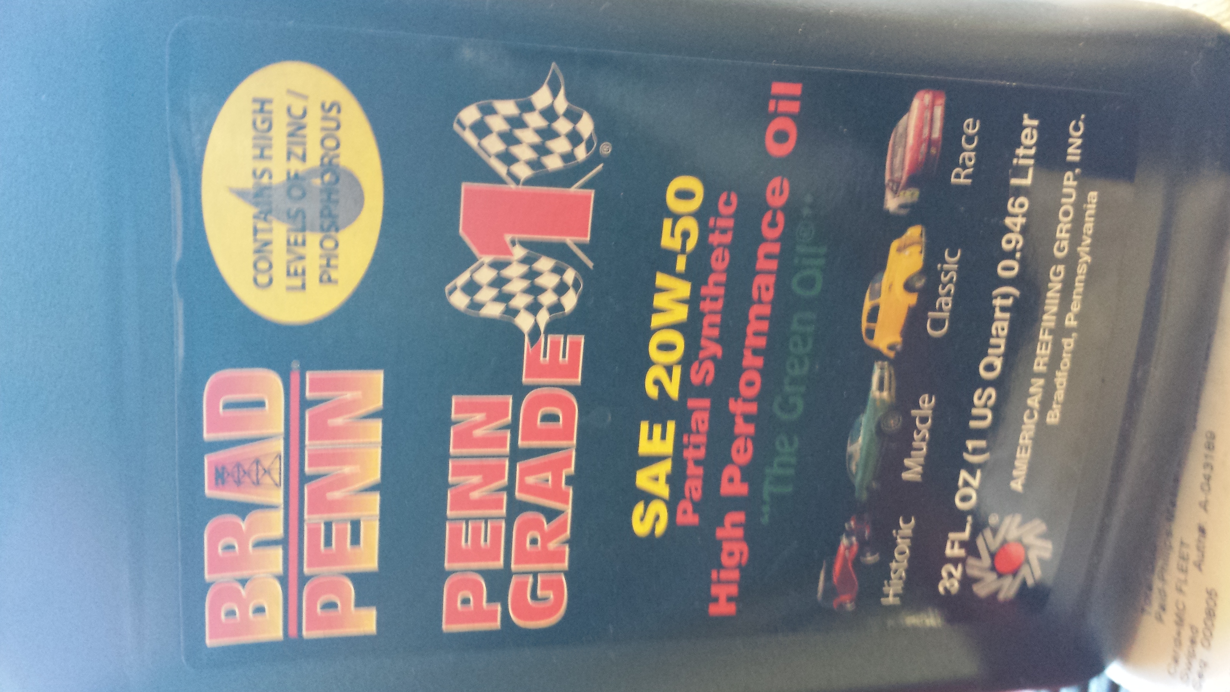

flylarry
post Aug 16 2014, 07:16 PM
Post #66
Posts: 38
Joined: 22-November 05
From: Carlsbad, CA
Member No.: 5,170
Here's what I've been using!Attached Image

Interesting how many people are running "Penn's oil", (IMG:style_emoticons/default/av-943.gif) Sorry couldn't help myself.
On a serious note. I know a lot of people have noted that oil technology has changed a lot, even in recent years. I took a class at De Anza auto tech,(Circa 1987),taught by Dema Elgin,of Elgin cams fame. He told us DO NOT run Castrol GTX as it aerates far too much, and certainly do not run it in a turbo engine. He has a pretty impressive cam portfolio including Porsche so I've stuck with that advice.FWIW

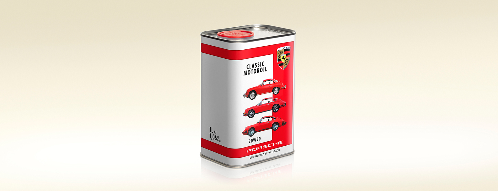

johnhora
post Aug 17 2014, 09:01 AM
Post #75
Posts: 902
Joined: 7-January 03
From: Derby City KY
Member No.: 107
Don't you just love discussions on this subject... (IMG:style_emoticons/default/smoke.gif)
http://www.porsche.com/usa/accessoriesands...eweditions/oil/
http://rennlist.com/forums/964-forum/80559...-motor-oil.html
(IMG:style_emoticons/default/stirthepot.gif)
