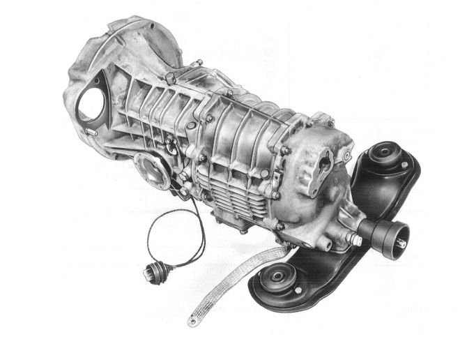

what about the transmission?.was that only made for one year.?

QUOTE(rosenfe @ Sep 19 2014, 07:07 PM) *
I doubt it. It's most likely a 915 transaxle. If not, it's a 901.
rosenfe
post Sep 19 2014, 05:53 PM
Posts: 565
Joined: 14-October 13
From: northern california
Member No.: 16,512
QUOTE(Johny Blackstain @ Sep 19 2014, 04:10 PM) *
looked it up.trans is called 923,electric speedo,only one year .finding parts must be fun

QUOTE(rosenfe @ Sep 19 2014, 07:53 PM) *
Yep, I did too. 923 is based on the 915, modified to fit a Type IV.

The transmission is a 915 box with a 901 mainshaft so it can use a 914 clutch, pressure plate, and flywheel.
It's neither. It's a 923, a evolution of the 915, and is a one year only transmission.

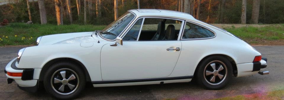

I've owned a half dozen of them, and have had 3 at once... I have two now.
Awesome cars in every way. They are getting way more positive attention now. This year we've already seen a 75% increase in 912E engine builds here. Thats a good indicator, because we do more 0912E engines than anyone, and the quality of the car rests is demanding a higher quality engine.
Here's #985 after I finished it's resto last year. I drove this car 160K flawless miles over a decade as my only daily driver. It has a unique RAT engine and while its EFI, its not stock.
