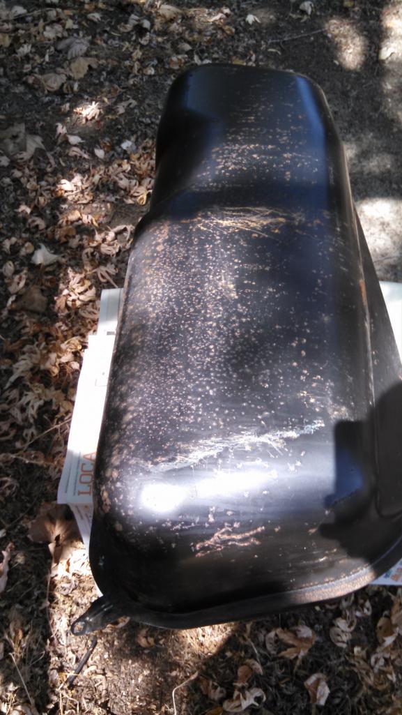

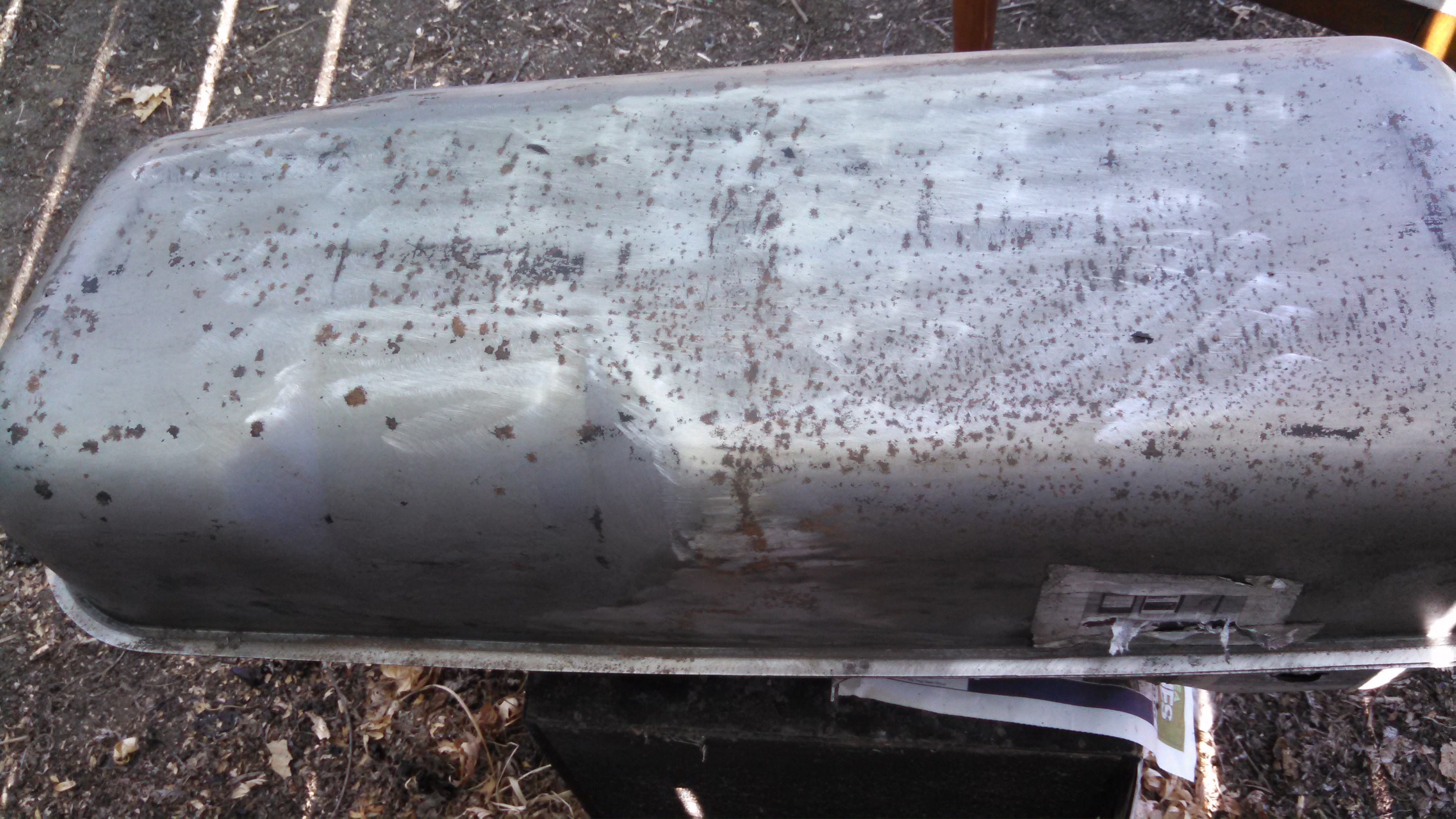

So, I start the process of replacing my fuel pump today (which has been relocated up front by PO). So I got the tank out and it was starting to look pretty "rusty". So I figured I woul attempt to strip it down and repaint it. I have gotten most of the paint stripped off, but how am i going to get some/all of this surface rust off?
Any good radiator shops in San Ramon area I could drop it off to have someone finish it for me this week? Note: the inside of the tank looks very good....as if someone re-did the tank sometime ago.

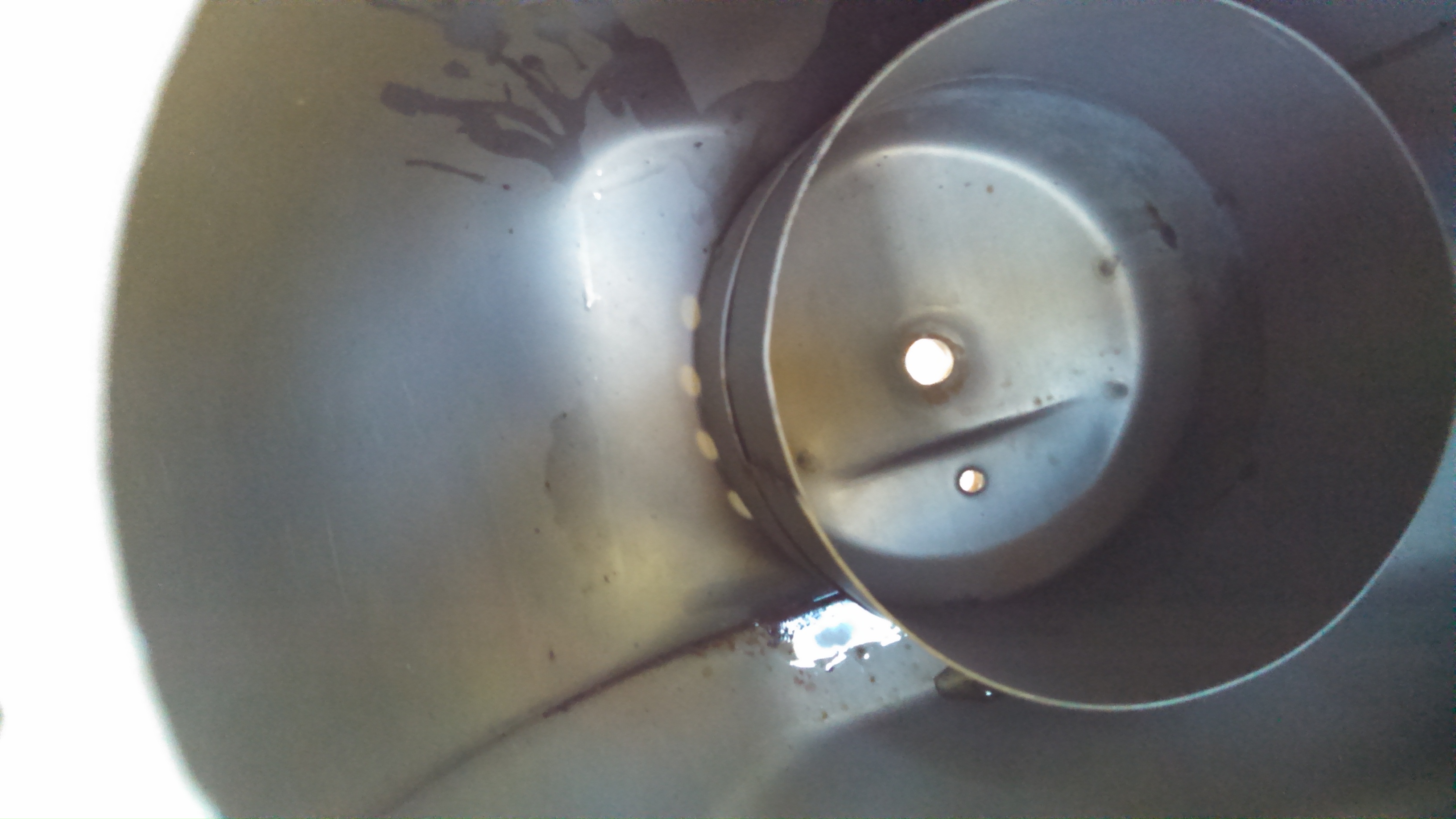

Inside the tank.

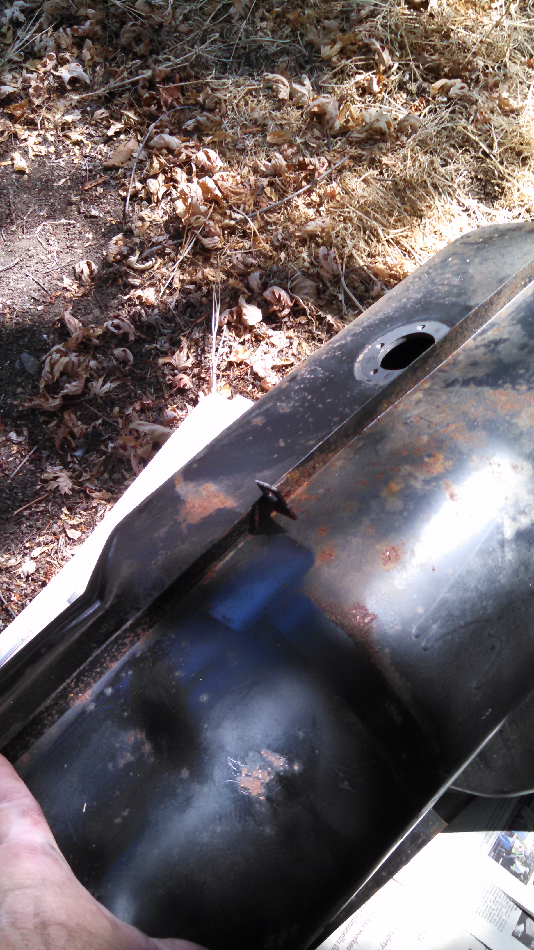

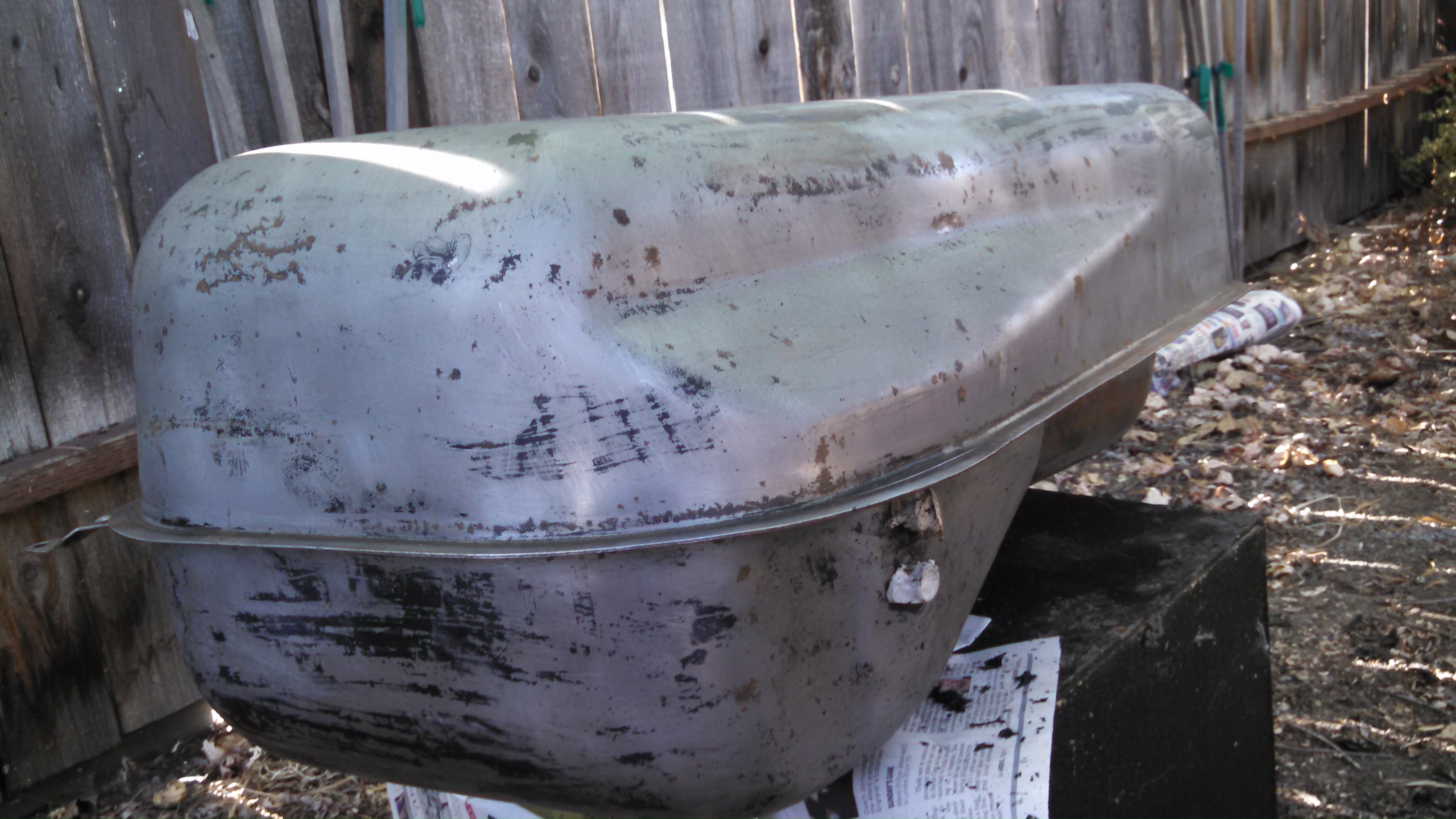

Tank stripped (as far as I could get today). Looking closely, it has lots of surface rust that I need/want to get off. Just want to know the best/easiest way....including a local shop near San Ramon that I could drop it off at.

You need to find a powder coating shop. They can blast it and coat it. Paint will only look good for a short while. I think you would have to go to Livermore to find one close.

QUOTE(Mike Bellis @ Sep 6 2014, 05:51 PM) *
Maas brothers in Livermore?
I'm thinking of just stopping by an auto body shop to see if I can have them sand blast and paint it. All depends on the $$$ i suppose.

You mentioned that the PO had possibly redid the tank. I had a tank where the inside was cleaned and sealed. The heat from the powder coating process set off some kind of chemical reaction. When I opened up the tank the fumes were absolutely atrocious. It became very hard to breath and it took hours before the symptoms subsided.
Please be very careful
The tank looked awesome but the insides were charred black

Most powder coating shops have a blaster...

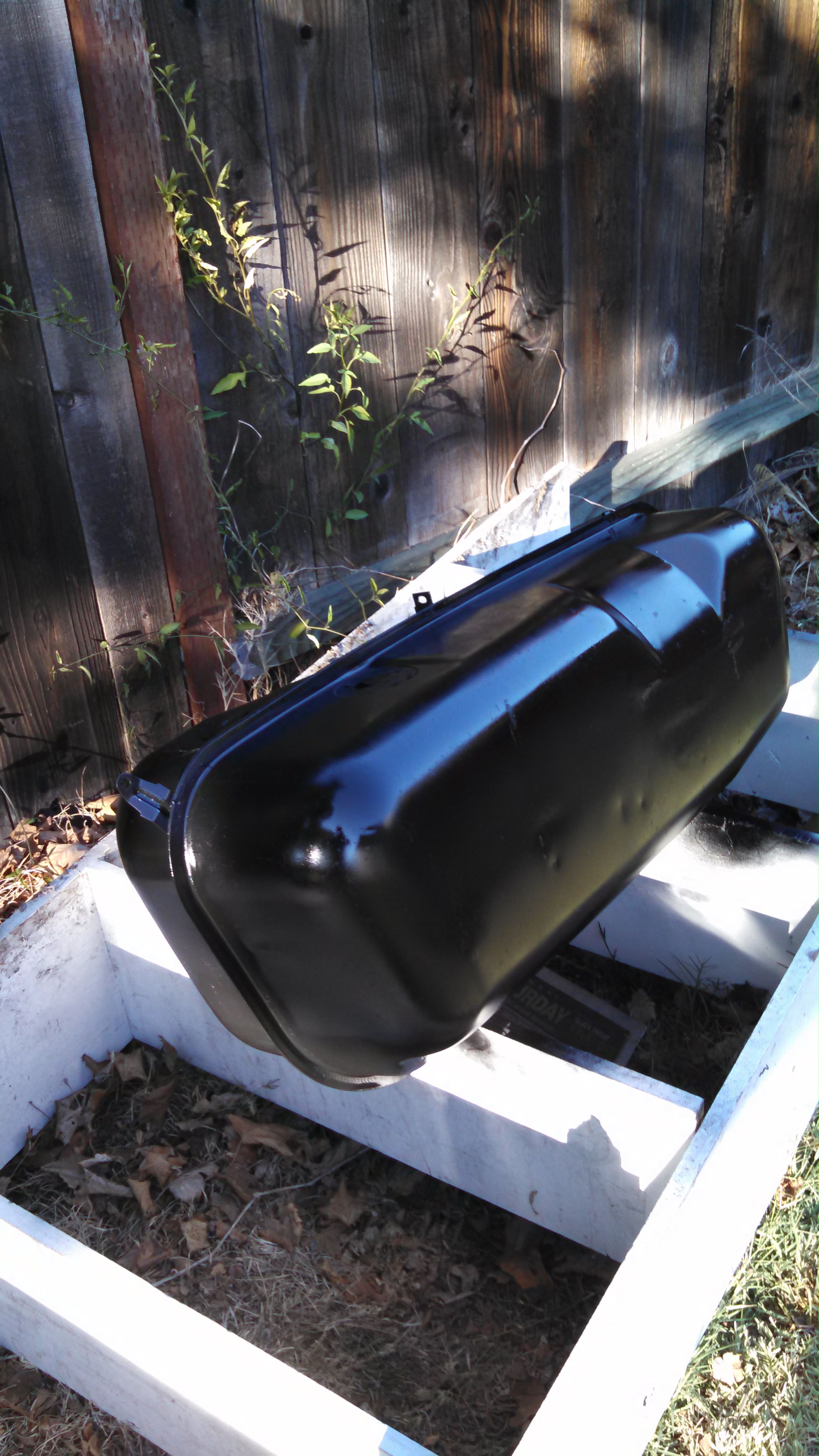

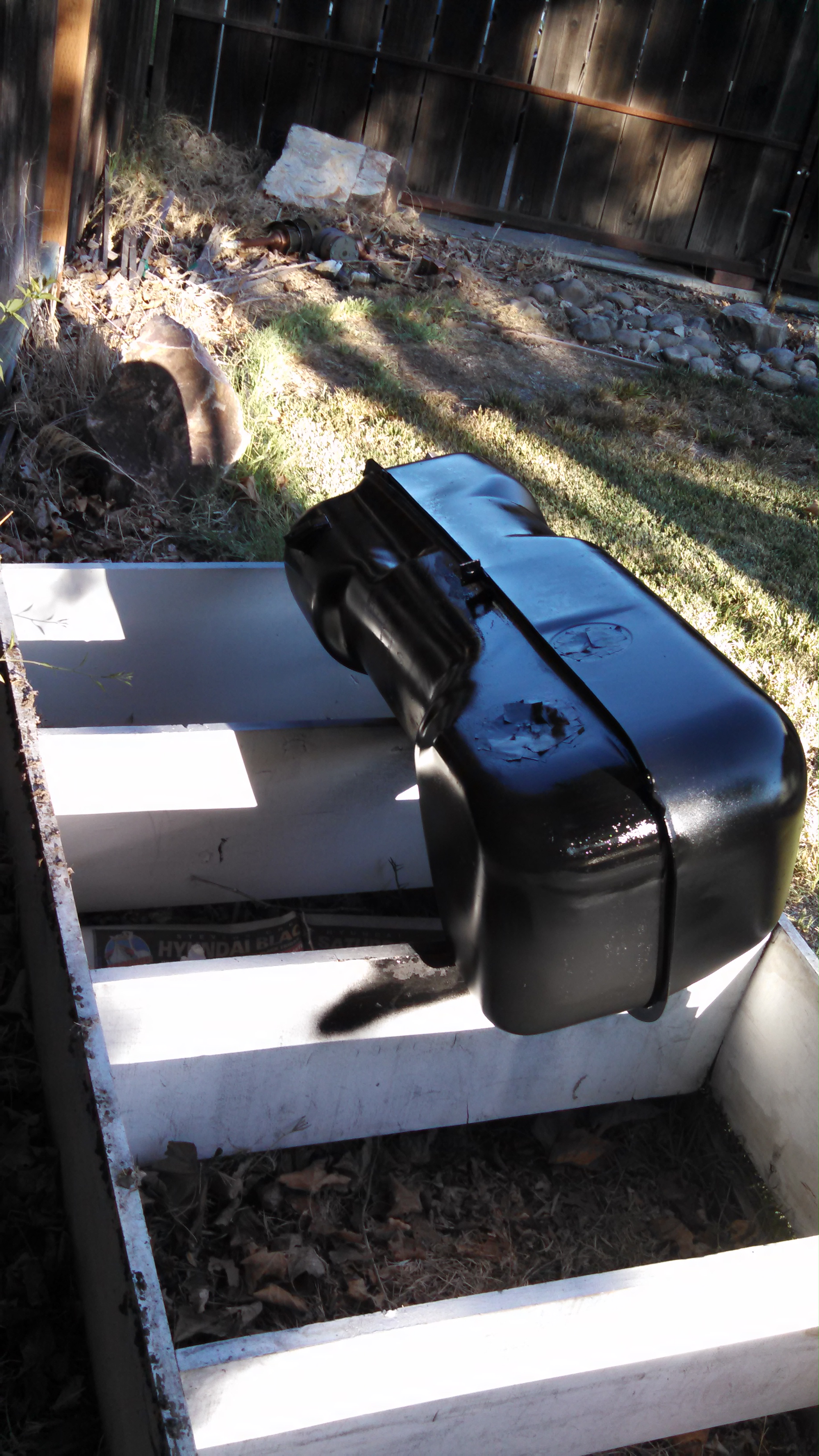

Being the CSOB 914 owner that I am, I was able to get my gas tank repainted today. For the light surface rust I was seeing on the tank after the stripping, I used Evaporust (from your FLAPS nearby). Actually worked very well.
Anyway, two rattle cans later and it looks good to me in gloss black. The inside of the tank is fine. No rust on the outside of the tank, and it has a fresh coat to protect it.
Now I just need to get it back together.

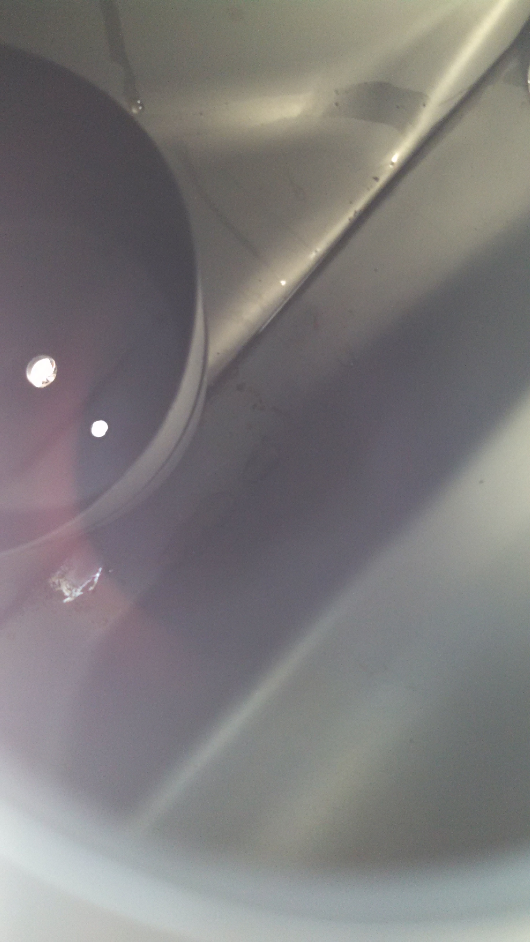

6. Installed tank again (looked inside and there is rust forming everywhere. ) (IMG:style_emoticons/default/headbang.gif) Proceeded anyways, but car won't start (definitely not a fuel issue anymore as lines are great and not crimped.)
Issues now:
1. Rust in tank. Going to have to send it off to be boiled, blasted and powdercoated I guess. Sucks cuz the tank was 99.999999999999% perfect inside.
