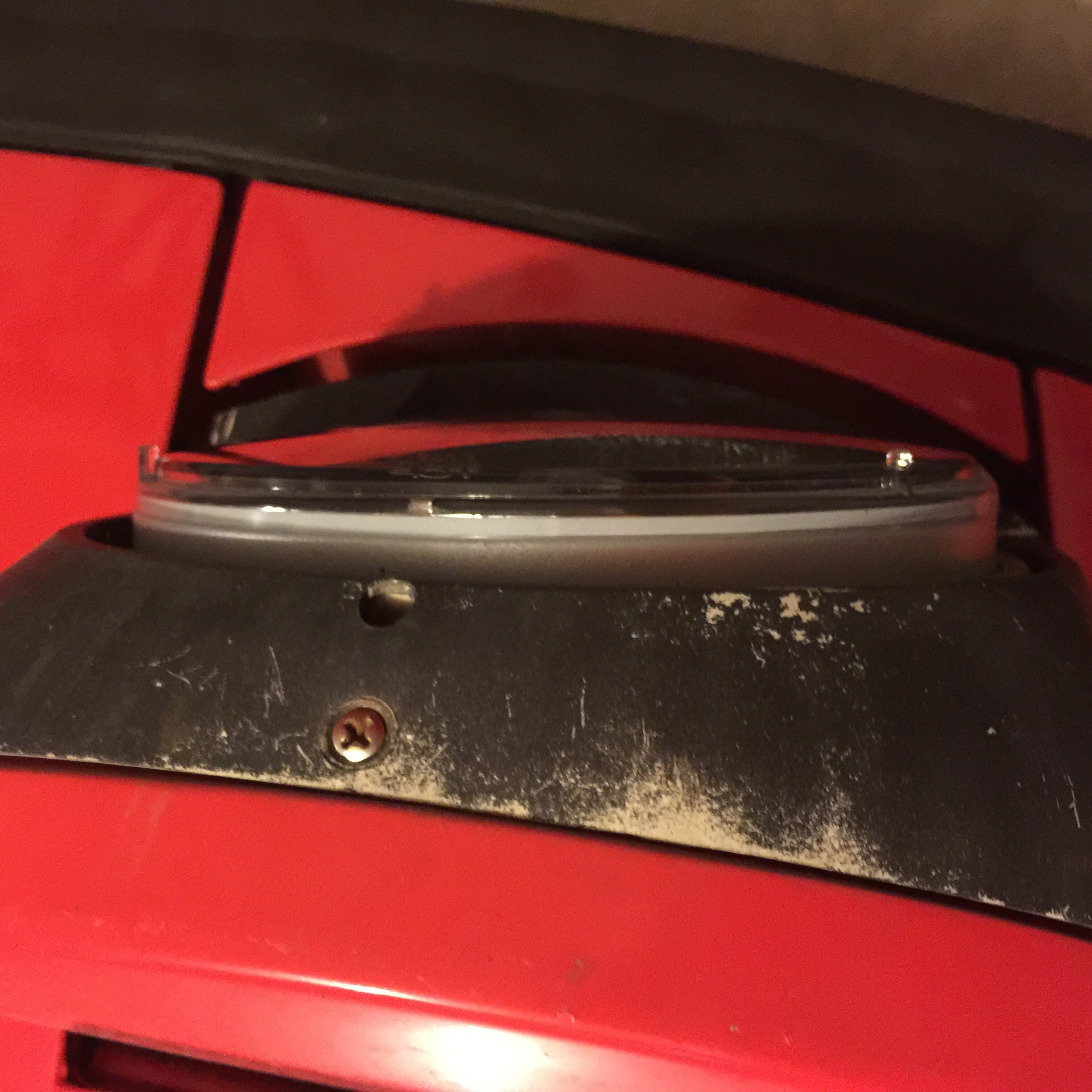

QUOTE(mepstein @ Oct 28 2014, 10:20 PM) *
...They do look a bit odd since the low beam only lights up the top half of the bulb and they stick out about 1/2" from the trim ring. They fit fine but unlike our hidden lights...
Mark (or anyone else that installed these) - can you post a pic of the installed lamp in daylight so I can understand how they stick out?

QUOTE(sfrenck @ Oct 29 2014, 07:42 AM) *
The fact that the front lens does seem to extend forward from the trim ring was the primary concern I had with these. Not really from an appearance stand point, just was hoping to hear that they fit and retract properly with the 914 pop-up mechanism.

Looks different but fits fine. There's plenty of clearance for the bulb.
