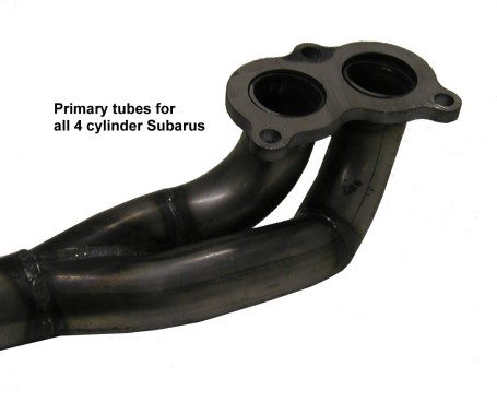

These from OutFront looks like they would fit. Anyone try them?
OutFront
(IMG:http://www.914world.com/bbs2/uploads_offsite/www.outfrontmotorsports.com-4719-1416408571.1.jpg)
Chris H.
post Nov 19 2014, 09:02 AM
Posts: 4,079
Joined: 2-January 03
From: Chicago 'burbs
Member No.: 73
I have the 3.3 version of those and they did not work. I don't know if that helps at all but you can measure and see. Mine hit the cross brace.
If you CAN make them work they are really nice.

I am using Ian's cradle. I have an early version, so later versions may be different.
I found that the exhaust header I bought hung really low. So, I am having one built. I did go with a shortened oil pan to make the bottom of the pan lie flush with the bottom of the car. I don't mind smacking the header, but do mind smacking the oil pan. I will post pictures once my car is back from the shop.

For those looking to build their own headers, one of the best sources for collectors and merges we have found is Cone Engineering.
http://coneeng.com/collectors.html
They have a nice selection of sizes in both Mild and Stainless.
There seem to be a fair number of hits when punch "Subaru Header Flange" into Google, if anyone has any experience on a good source for flanges, speak up!
