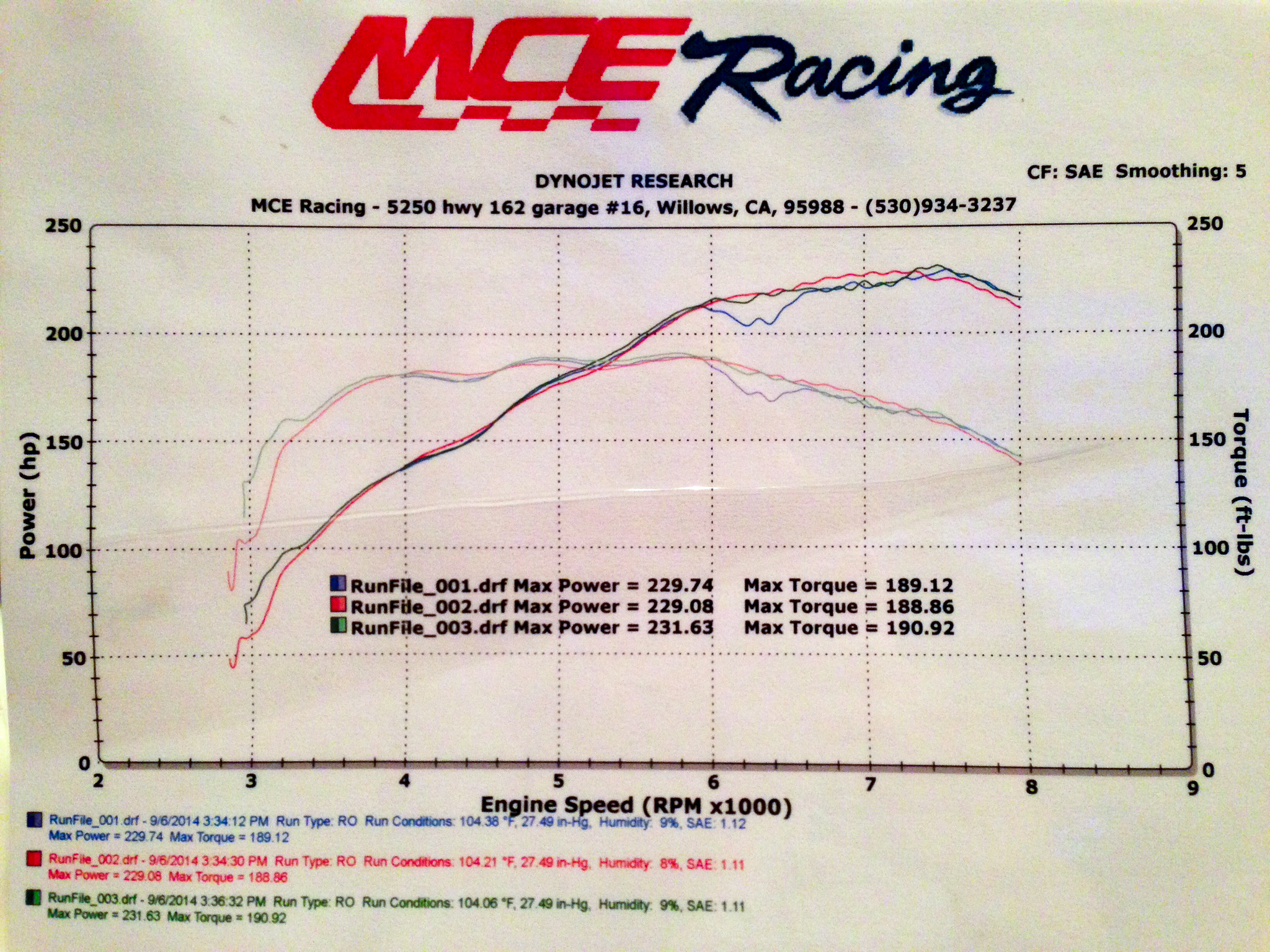

My old school mag-case carbed 2.7. Completely stock. (IMG:style_emoticons/default/av-943.gif)
(IMG:http://www.914world.com/bbs2/uploads_offsite/farm4.staticflickr.com-21-1418173107.1.jpg)914R engine by cjcam, on Flickr
Powerband can still be smoothed-out and bumped a bit with further tuning/jetting...note the ambient temps on the dyno sheet. Yes we were racing in 104-106F. (IMG:style_emoticons/default/w00t.gif)
