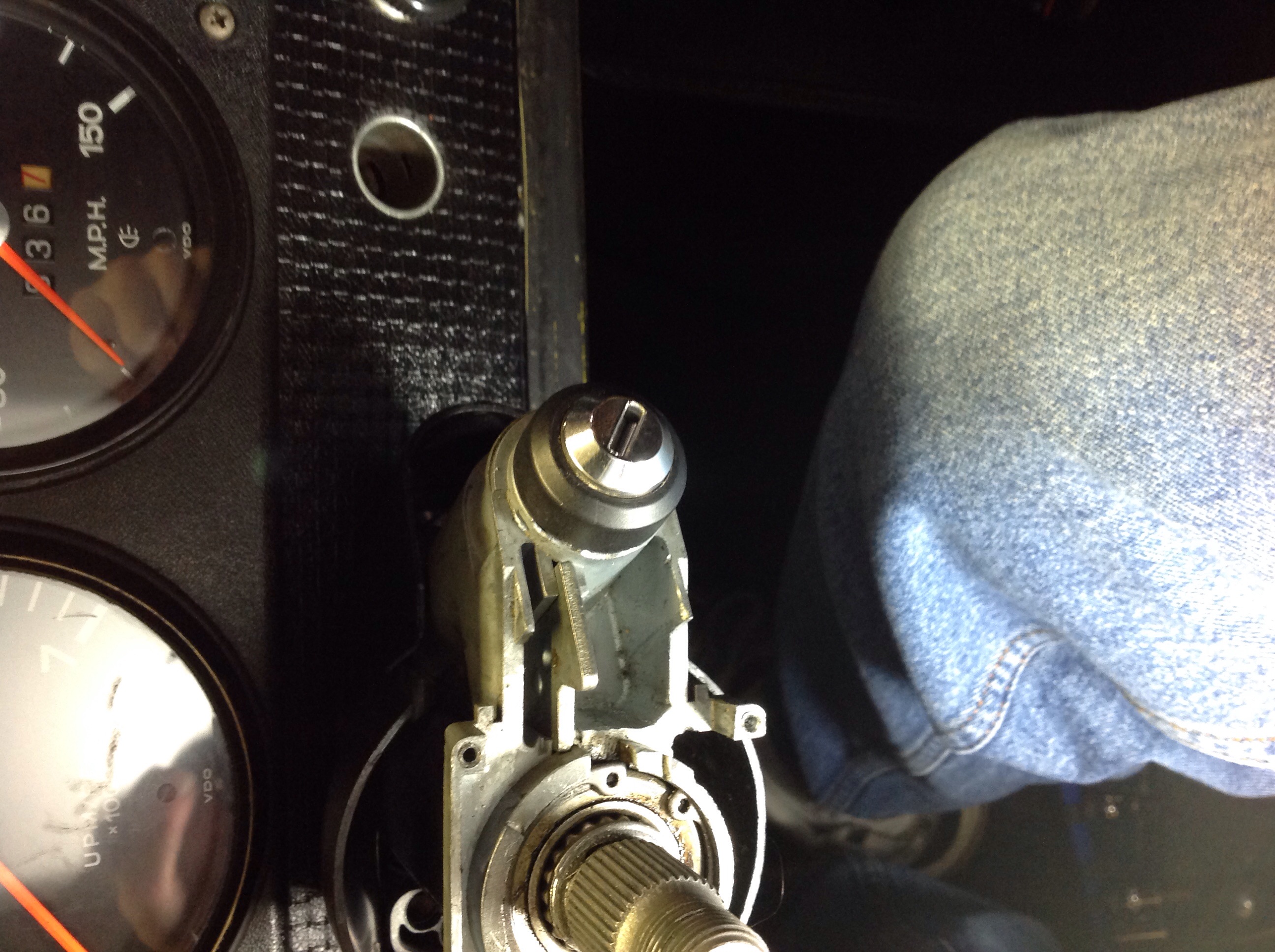

I'm trying to replace my ignition switch on my 75, 1.8L. I've been following the Pelican write up but my car doesn't have the two screws to pull the switch as shown in Pelican figure 10. How do you get this thing out on a '75? Photo of my car attached.
Thanks,
RickAttached Image

I got the tumbler out. Do you have to pull the whole unit off the steering shaft?

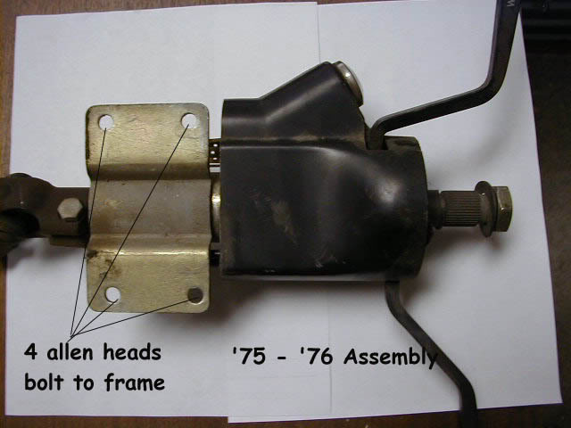

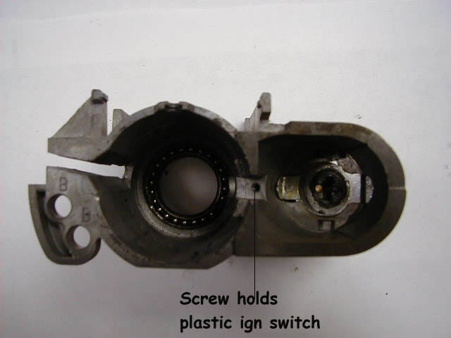

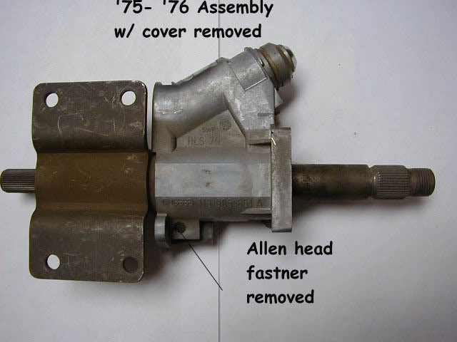

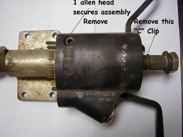

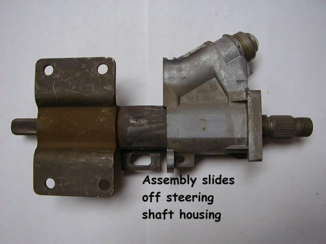

The '75-'76 comes apart differently than the '73-'74. Maybe these images will help you. Steering wheel and switch assembly must be removed.
(IMG:http://www.914world.com/bbs2/uploads_offsite/i239.photobucket.com-1696-1420310163.1.jpg)
(IMG:http://www.914world.com/bbs2/uploads_offsite/i239.photobucket.com-1696-1420310163.2.jpg)
(IMG:http://www.914world.com/bbs2/uploads_offsite/i239.photobucket.com-1696-1420310163.3.jpg)
(IMG:http://www.914world.com/bbs2/uploads_offsite/i239.photobucket.com-1696-1420310163.4.jpg)
(IMG:http://www.914world.com/bbs2/uploads_offsite/i239.photobucket.com-1696-1420310163.5.jpg)
From these you may get the idea of how to get to the plastic ignition switch portion. I wrote this up a long time ago but can't find the thread.
A quickie thread: http://www.914world.com/bbs2/index.php?sho...switch++removal

Thanks, these are very helpful. It looks like it's the "C" clip holding it on. Will try removal and let you know how it goes.

Thanks Ron with you photos I got it out and replaced the switch. One more question (at least for today....). There was a crush ring connecting to the steering column. It looks to be shot now and is making it hard to get the assembly back on. Is it necessary or can I leave it off?

PBC914
post Jan 3 2015, 06:48 PM
Posts: 192
Joined: 30-December 10
From: Minneapolis
Member No.: 12,545
You're close! Remove the c-clip from around the steering shaft. All of the connectors at the back and it will slide off. Yes it's a pain!

PBC914
post Jan 3 2015, 06:58 PM
Posts: 192
From: Minneapolis
Member No.: 12,545
You don't need a drift for this job. It's easy remove the c clip from around the steering shaft and the entire piece slides off.
brooks944
post Jan 4 2015, 10:53 AM
Posts: 249
Joined: 5-September 10
From: Kingston, TN
Member No.: 12,139
Thanks guys, got it done. What a Pain. About 4 hours for a $5 part! Since I'm free labor, another 914 adventure that should be easier if I ever try this again. I also installed a new Dino steering wheel as well, which looks great, so this project was like a two for one!
