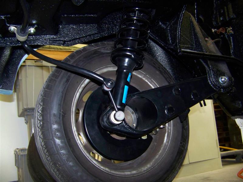

I went to install the shafts today and noticed that the bolts I have are too small (diameter). They are the right size for the transmission side. Aren't they the same?

Both sides should be the same M8X48mm

Did someone do a five lug conversion and use 911 stubs? My stubs and transmission flanges are M10 (108mm CV's both sides).

They are diffinately bigger. I had the 5 lug conversion done by Eric Shea. Eric you out there?
PanelBilly
post Mar 1 2015, 10:05 PM
Posts: 5,950
Joined: 23-July 06
From: Kent, Wa
Member No.: 6,488
Just found my original paperwork from PMB and it says 911. Now will my 914 CV's still work?

No they will not. You need 911 axles. 944's I think will work too but seems like there is more to it. You just need to get the 911 flanges for the tranny. They are a direct replacement so no biggie there. I think the early 911 axles are a little shorter than 73 on. Hopefully someone else will chime in

Swayaway makes the axles that work with the bigger CV's. All covered in the above classic threads.

maybe you need 914-6 stub axles?

looks like 108's
use 944 stubs/CV and keep your axles and trans end cv

911 axles are too short for any 914 ...
