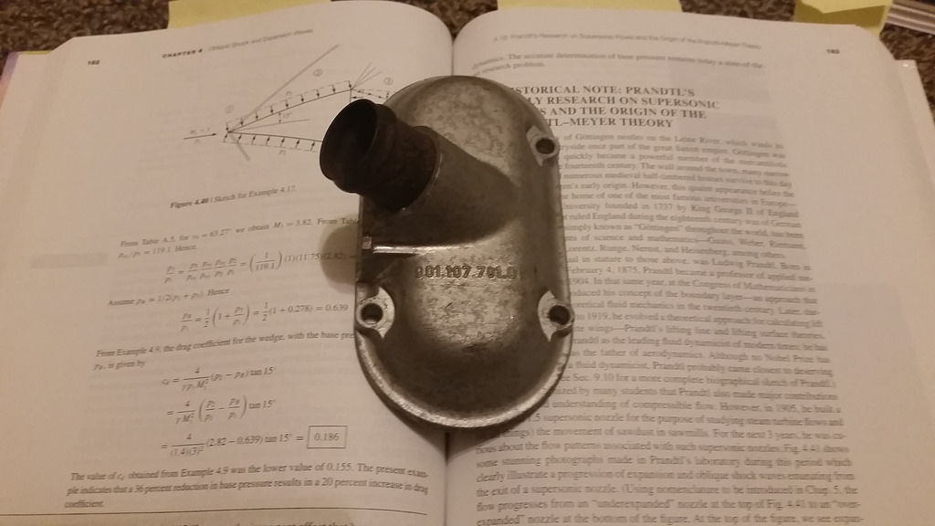

I know that the discussion is about where to vent the case breather to, but I've found the solution to the leaking hose... get a real case breather cover, ie. off an early aluminum 2.0L. These pop up on ebay once in a while, and mine doesn't leak at all anymore...
(IMG:http://www.914world.com/bbs2/uploads_offsite/farm8.staticflickr.com-9714-1426484136.1.jpg)
