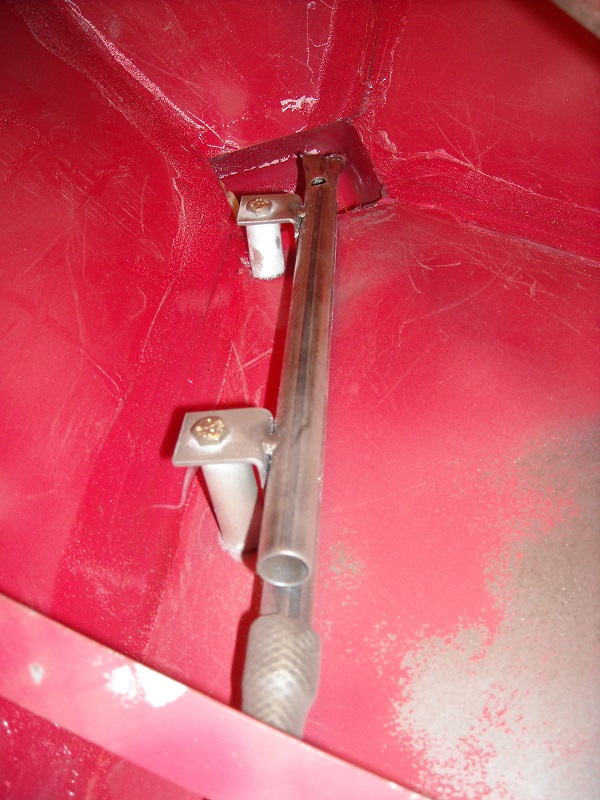

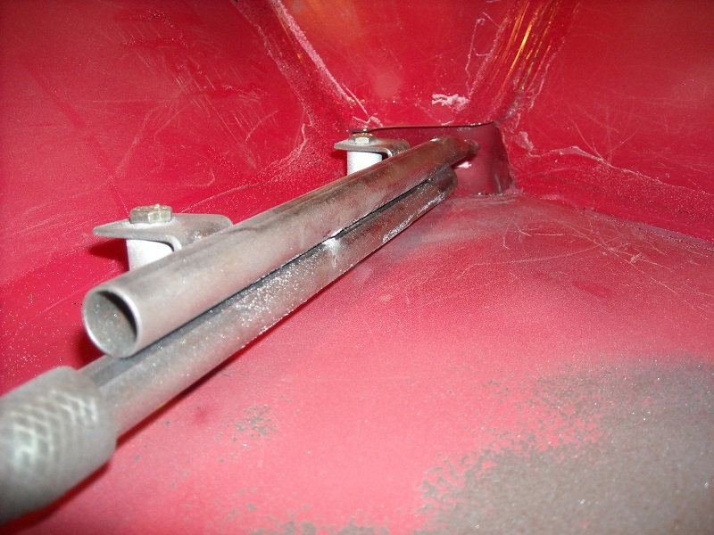

Being a CSOB when I needed a blast cabinet I went to HF. I figured how bad can it be? Well it seemed to work ok at first, then I started having problems with the media tube floating up, pulsing and generally not working well.
I switch between Black Beauty coal slag and glass beads and had the problem with both
I switched blast guns with another but no change. then after some research and seeing a different type of media tube that was a double barrel instead of a tube inside a tube. I bought one from TP tools. That solved my problem.
I used the 12" tube they offer and made the standoffs to angle it into the little square at the bottom. this is with the table top model.
I was just screening the glass beads and had the cabinet empty so I thought I would take some pics... Not much to see when its full of media.
BTW you do need to put extra sealant on all the seams of these cabinets or it will leak like a sieve.

I don't get why it has two tubes. I have the same problem with my cabinet (different design), but I am failing to understand how this works.

Looks like that open end stands up above the sand so air has clear passage and sand is sucked in thru that hole drilled in the bottom of that other tube then to the gun? What is that hole size? I'm cheap and will make one. (IMG:style_emoticons/default/biggrin.gif) Thx for posting that.

That's correct.
This is what sent me looking for another media tube. pictures on the bottom of page 2.. with dimensions
http://forums.thecmp.org/showthread.php?t=82231&page=2
I probably could have made one but I am trying to eliminate working on things that take away my time from working on the teener. Like, I just sold my boat because it needed to much maintenance.
This is the link to the one I bought. they have just about every sandblasting accessory you could want. Looks like the price went up since I bought mine..
I used the 12" tube. but it depends on your cabinet...

What is the size of the opening that the sand is sucked into? 3/8"?
